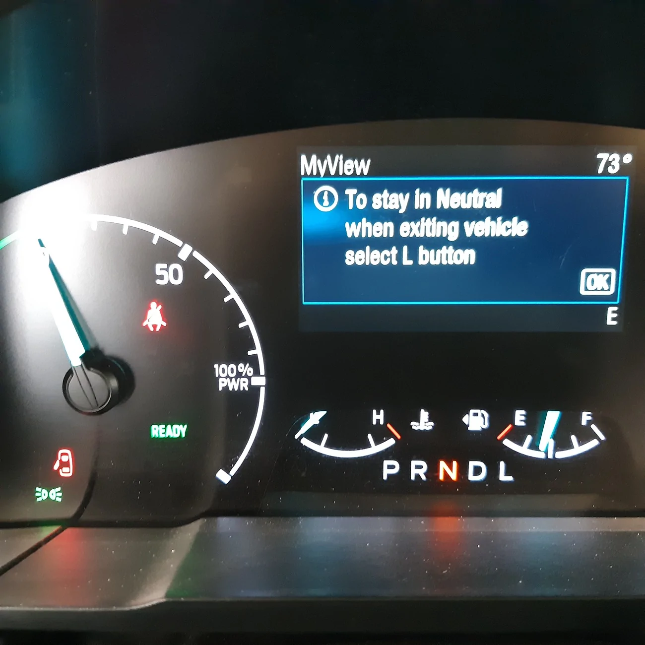

Same here, leave mine running, put it in neutral.
I don't plan on exiting my truck anytime during the car wash therefore. There is No need for me to press the L button.
My opinion is.
Some folks are skimming the pop up message and totally skipping the middle line.
X3 Neutral and leave it running and listen to FM Radio since Sirius won't work inside a building!! :)
