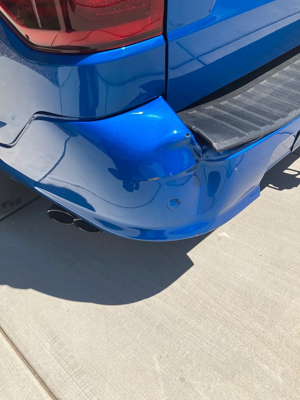

I backed into a parked car yesterday - totally my fault of course. Luckily there was not a human opening her driver’s door at the time…I would have squished her:(
