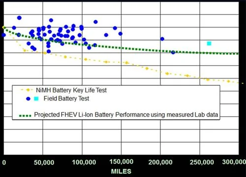

The key life test results are pushing 10 years old now, and seem to have been quite accurate in hybrid applications.
Ford Maverick Battery life expectancy for hybrid Maverick? Key Life Test Ford Results NiMH Li Ion
I'll ask folks to be careful which battery technology they are talking about. NiMH batteries wear out, while Li-ion last a long time unless abused. It turns out the hybrid application is the least abusive of automotive uses; BEV and PHEV both trade range for battery capacity, so they discharge deeply and spend a lot of time fully charged. A hybrid's battery spends its life near 50% charge most of the time. It's a buffer, not a source, and that makes all the difference when it comes to life.
Owners should expect the HVB in a Maverick hybrid to last as long as the truck does.
What is the Y-axis?
You know better than to send us data to drool over without units of measure :)
