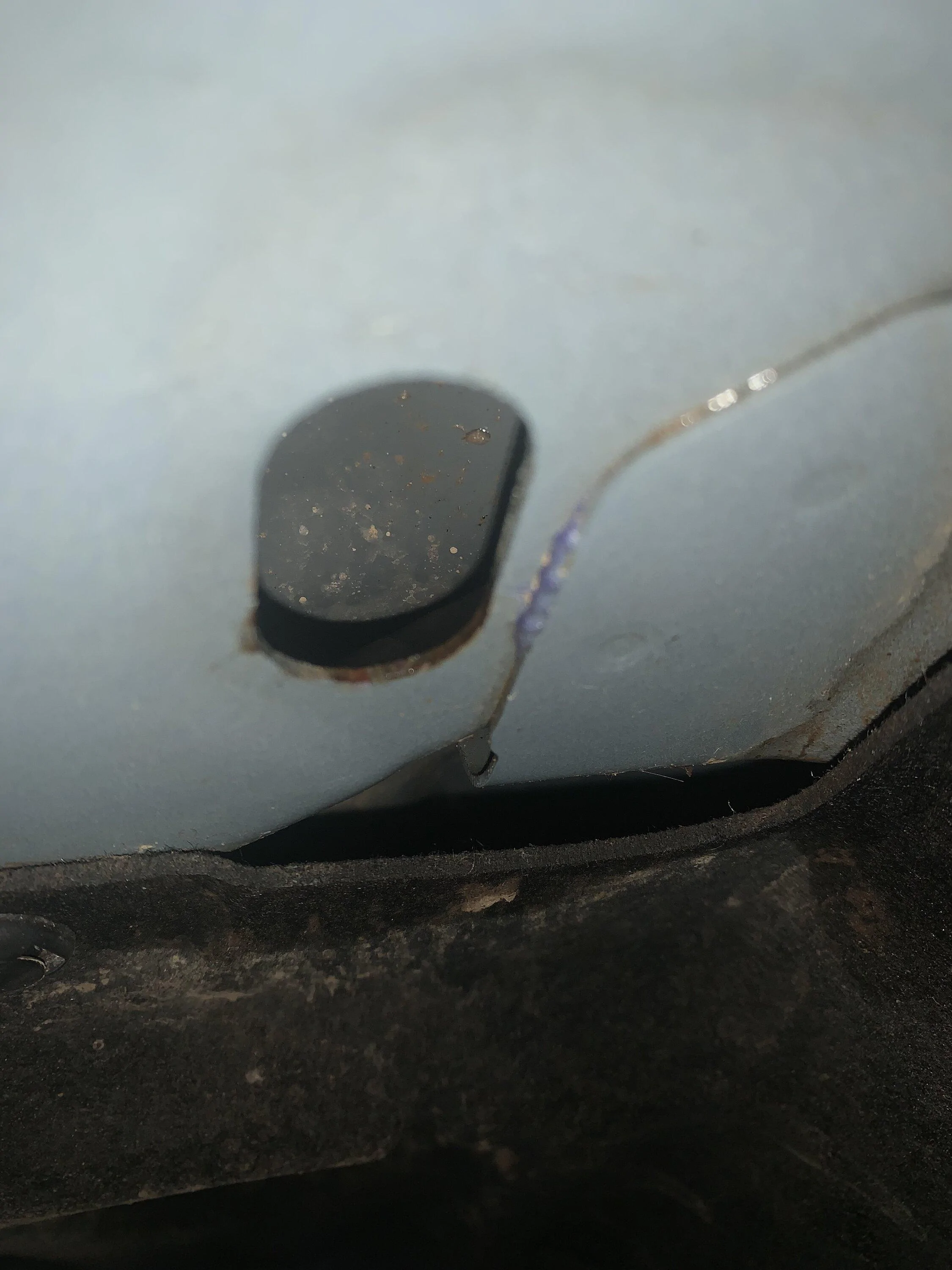

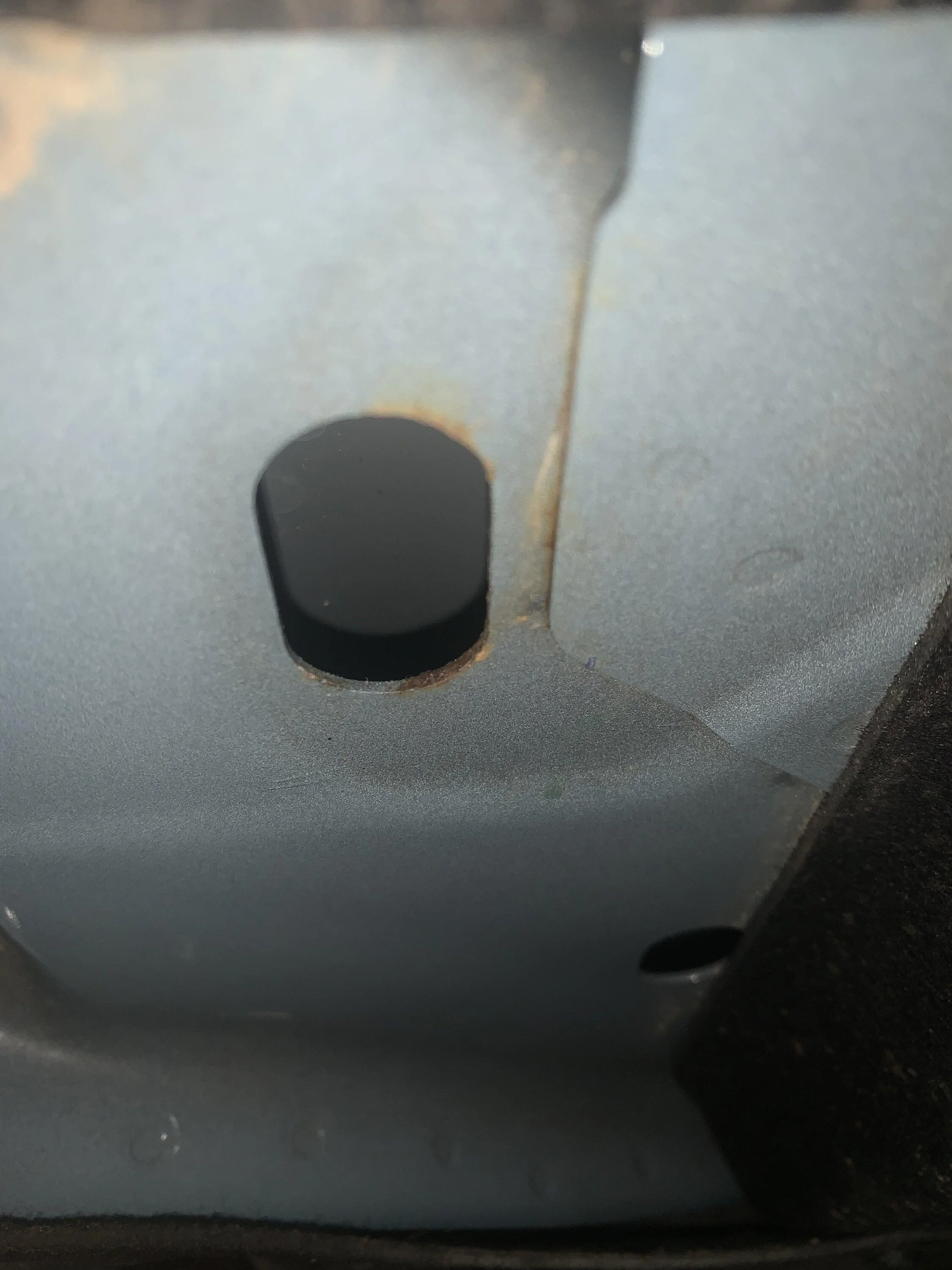

Did you want to get in touch with me also? I live in Nova Scotia where the roads are covered in salt for 5 months of the year and my 3 month old truck is already showing rust on the seams of the subframe without seeing a winter yet. These spots are right under the front corner of the drivers and passenger doors, they’re the only parts of the underbody that don’t have a shield over them so they’re easy to find.
This should concern every single Ford Maverick owner and make every single potential owner of a Maverick think twice. I work in the aerospace industry as a Materials Engineer, I deal with metal treatments for corrosion protection on a daily basis and I can confirm for all that this is a significant issue for long term viability of this truck.
Hmmm, that does not look good at all for a vehicle much less than a year old. If that was my truck I would sandblast that area, rust reform it, prime it and put a coating of bed liner and undercoat it.
Of course, as a Materials Engineer you are aware of the unstoppable desire of steel to return to its natural state, rust. But man, that sure was quick without road salt accelerating the process.

I was using a protectant on the rocker panels when I saw rust already on the pinch welds and exposed painted surfaces underneath. 8 months old and less than 2000 miles. Never driven in the rain or snow.
Horrible, a major turn around for the Maverick.
Yes when you consider I did not drive it in the snow or rain for I have another car I used. Most of the miles on this were put on during the 1st month or so.
