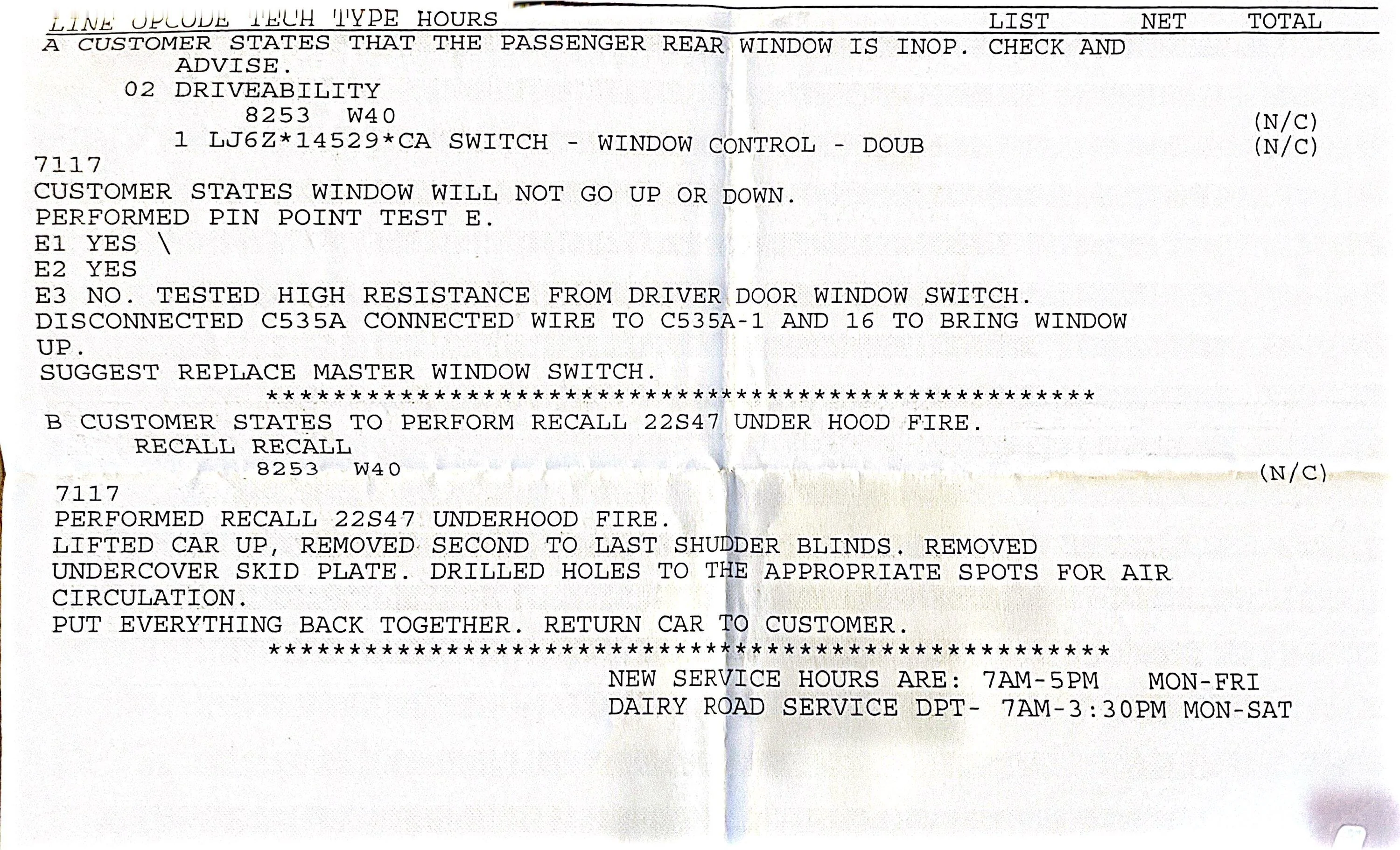

Welp.. My maverick's window just got into the same predicament..
Rolled it down all the way, now it won't come back up. Every window is operational but the passenger side rear.
Let's see what the dealer's diagnosis is.

Update. I took it in for the diagnostic. They was able to roll up the window so no garbage bags/tape (yay!). They said it needs a new window switch so they replaced that and now it works.
Ford Maverick Anyone have issues with their power windows? 04D73A11-FFDD-4CED-A58D-2F2B4B769641

My Maverick back passenger window will not go up. So I took off the panel to see if the it was un plug and found it was pluged in but the motor was very very hot. So I unplug it till I can get it to the dealer.
