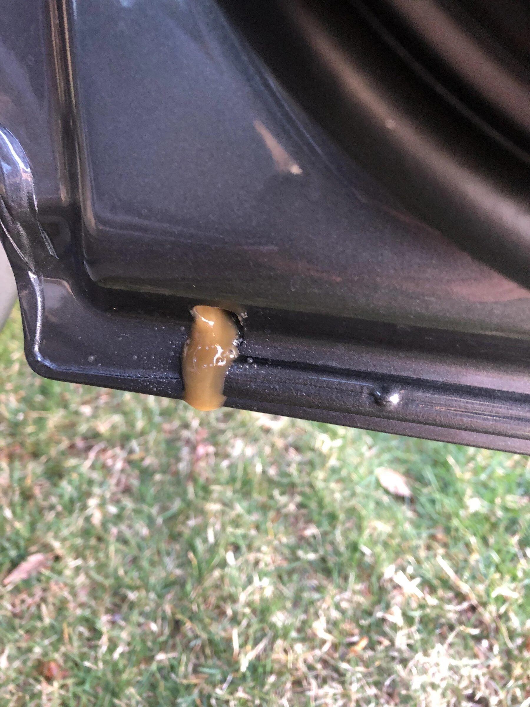

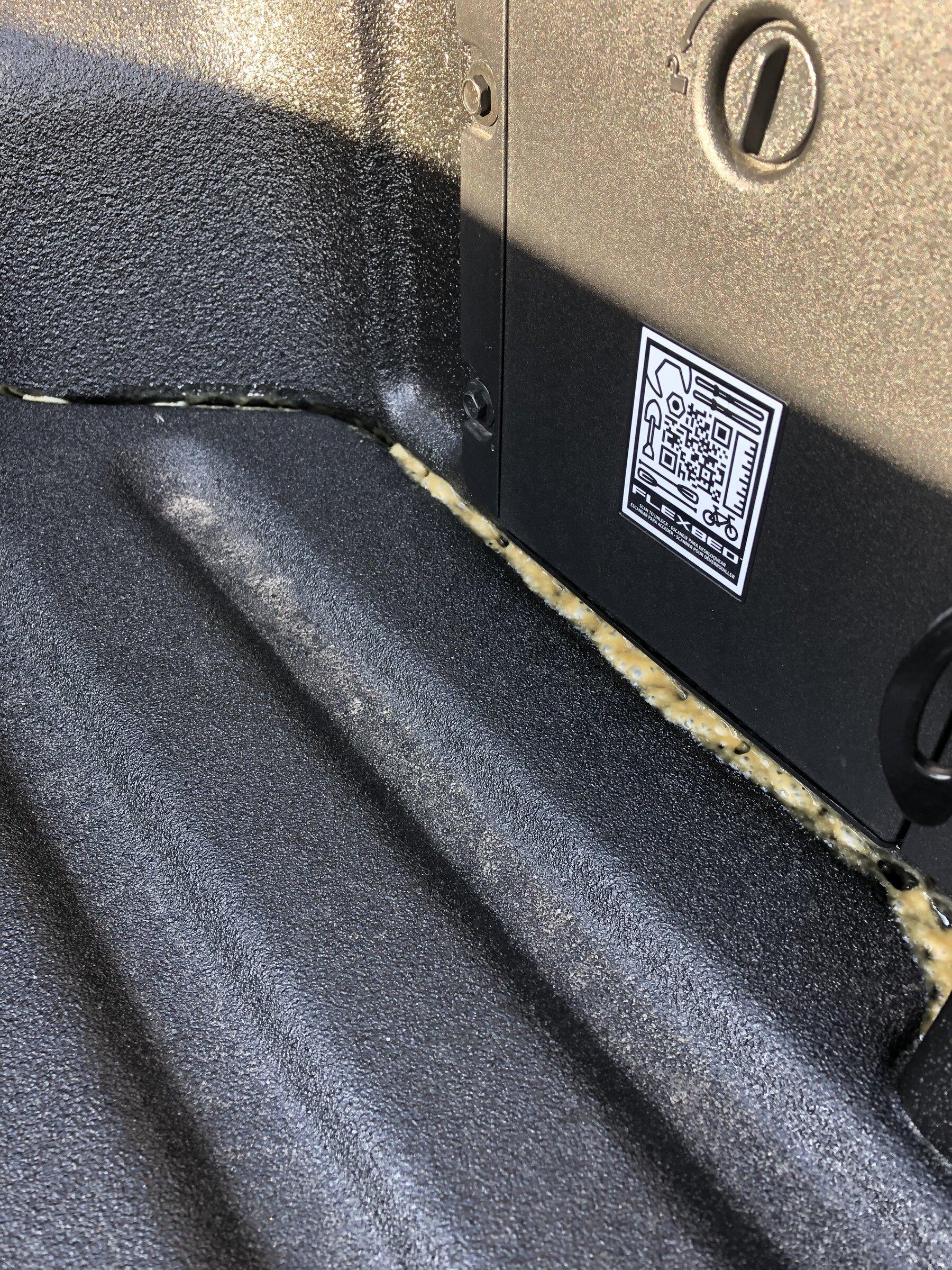

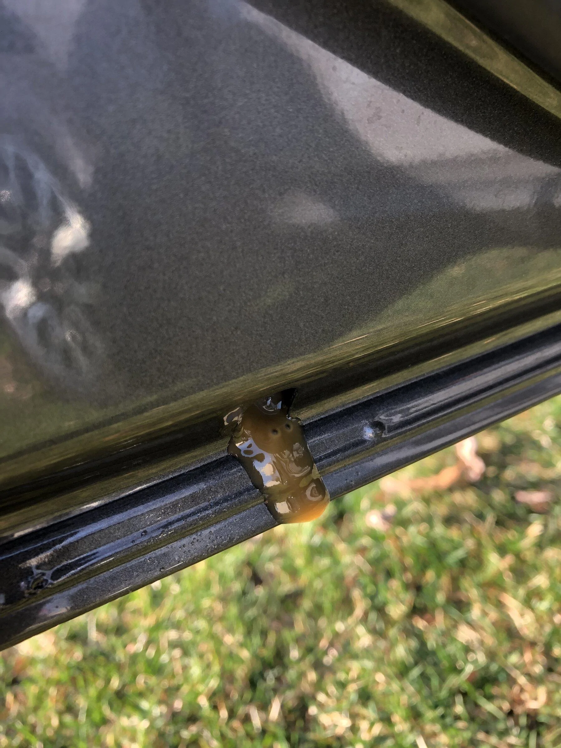

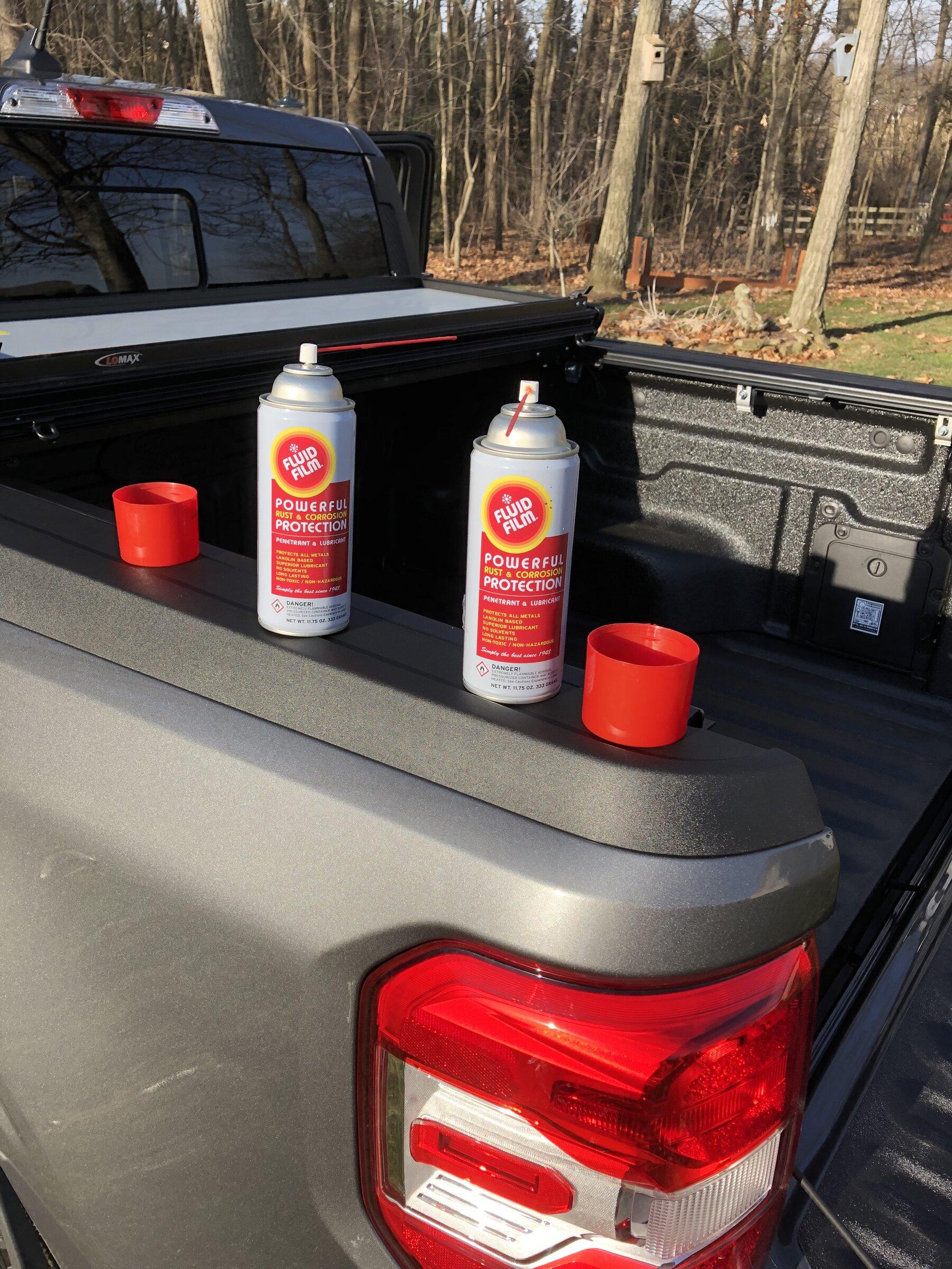

The second day of ownership I decided to get ahead of the FORD rust issues by coating every crack and orifice on the truck. It's low cost and works to prevent standing water and coats the metal to seal from corrosion. About $9.00 a can and I used two cans to do the bed, rockers, rear taillight area and doors.
Day TWO with Maverick
Rust Prevention
The spray flows to all the crevices and does not block the drain holes. After the liquid dries, just wipe up the excess and your good to go.

What is the name of that product? I cannot quite read the name from the picture. And does it need reapplied or does it hold up over time?

It's called FLUID FILM. Google it for specifications. I ordered from Amazon, but I saw it at WALMART about a month ago. It's for cracks and crevasses and would need reapplication yearly as an undercoating because it will eventually wear away like KROWN Oil coating.

Thank you sir! I think they use that or something like it on cast iron machine surfaces at work. Did not know it could be used as a undercoat.
