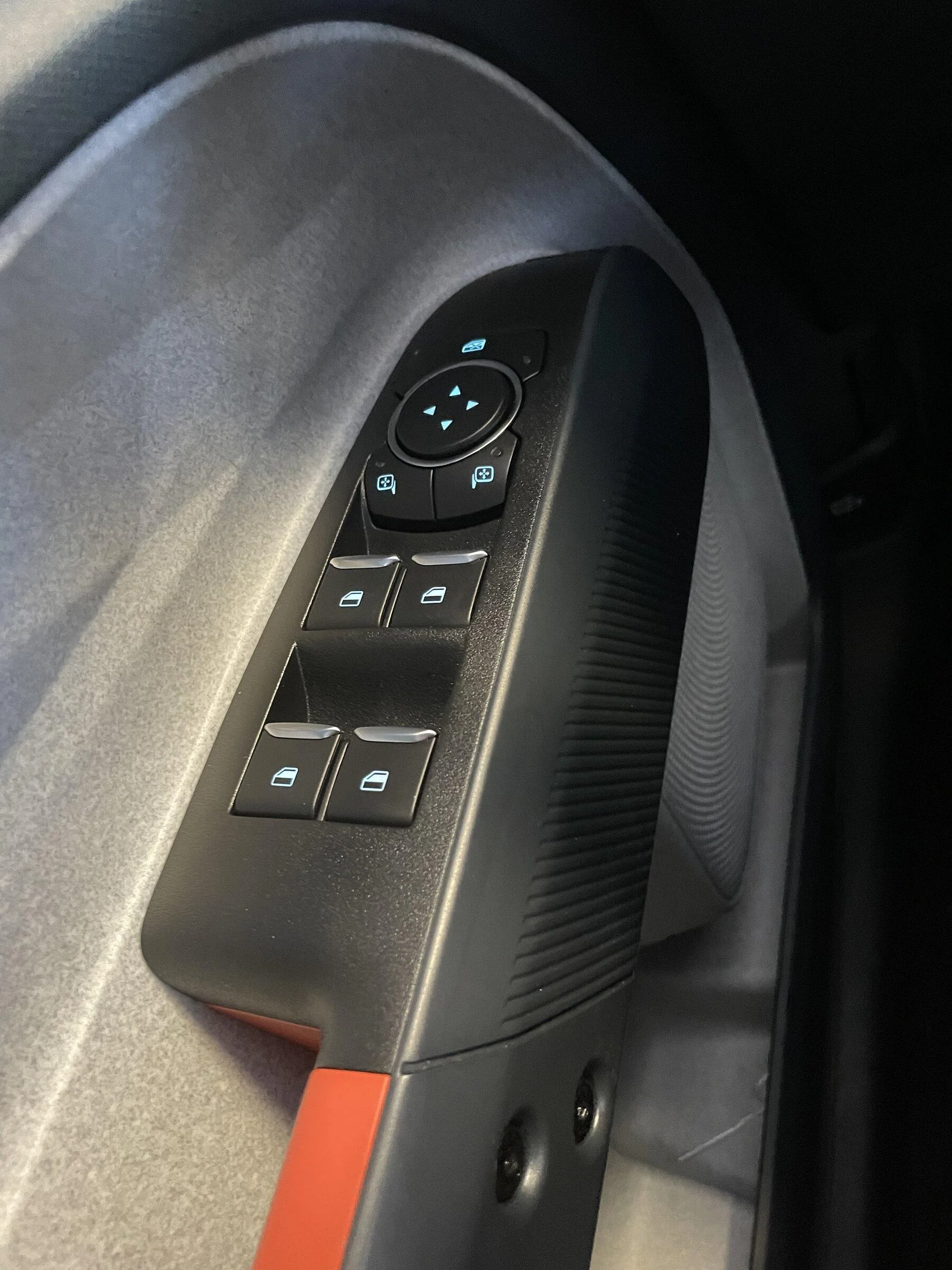

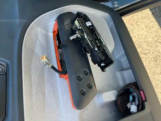

This has been fixed.
I just picked up my Mav.
The issue was the main window switch Bus (pictured).
It acts as a controller and was sending incorrect voltage and grounding out the rear passenger motor/regulator assembly.
They had one on hand, replaced it, and working.
I will update if that changes but as of right now, good to go.

Update, it was also the main window switch. I'm sure with the rush to get micro chips, normal quality measures were subverted. Hopefully the replacement parts are not faulty as well.

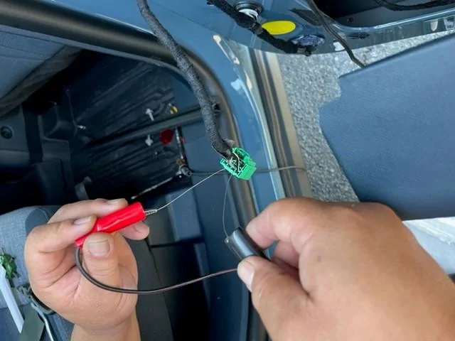

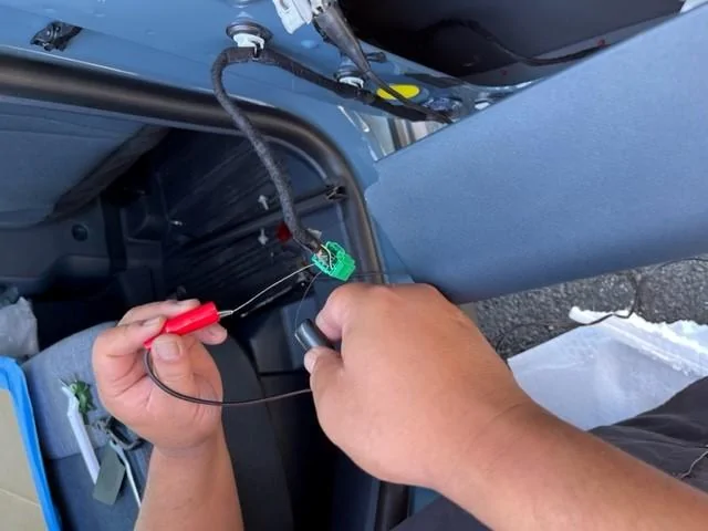

I also have this same issue. My buddy who works on cars figured it out. It was determined to be the main power switch on the driver side door. Basically he removed the connector from the window switch on the rear passenger door that was not rolling up and hooked up power to it to roll it back up. We determined at this point it was not the window motor. Once we plugged it back in it automatically rolled down again. This means it was coming from the main switch. We hooked power to it again to roll it back up until my dealer has a chance to diagnose it. They have the truck right now and literally should be getting a call back any time. Hopefully it will not take too long to bring in the new driver side window switch as my car has been at Ford for 3 days now just to look at it. At least they took care of the Fire Hazard Recall and are also looking at a vibration issue. When I have a radio talk show playing a certain frequency makes it sound like the speakers are crackling. But after changing the balance it was determined that the vibration is coming from the front of the car in the dash somewhere. I am not sure they will be able to fix anything with this. This could be a design issue. I am not sure... Hopefully this will help someone with diagnosing the rear window issue.
