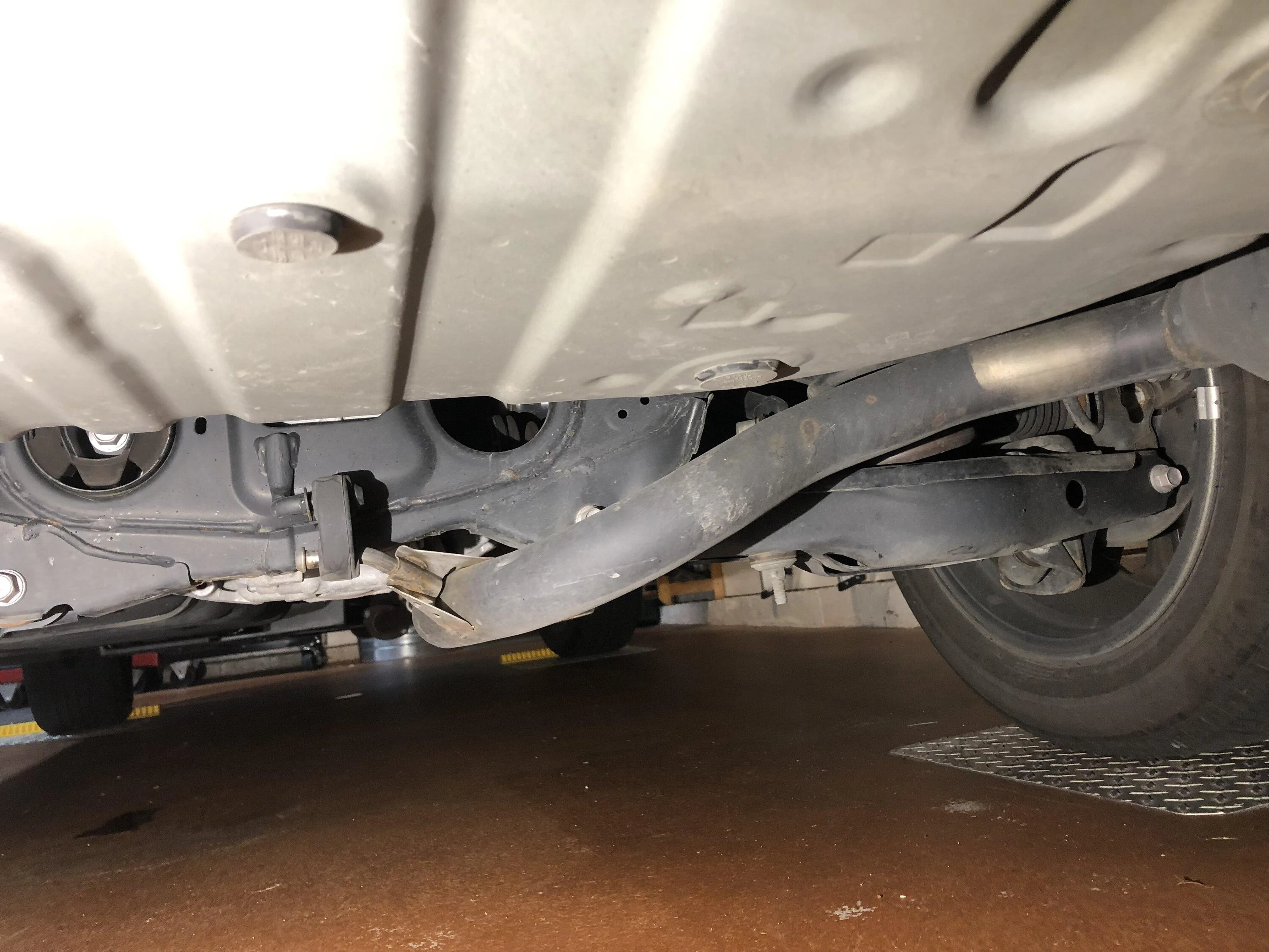

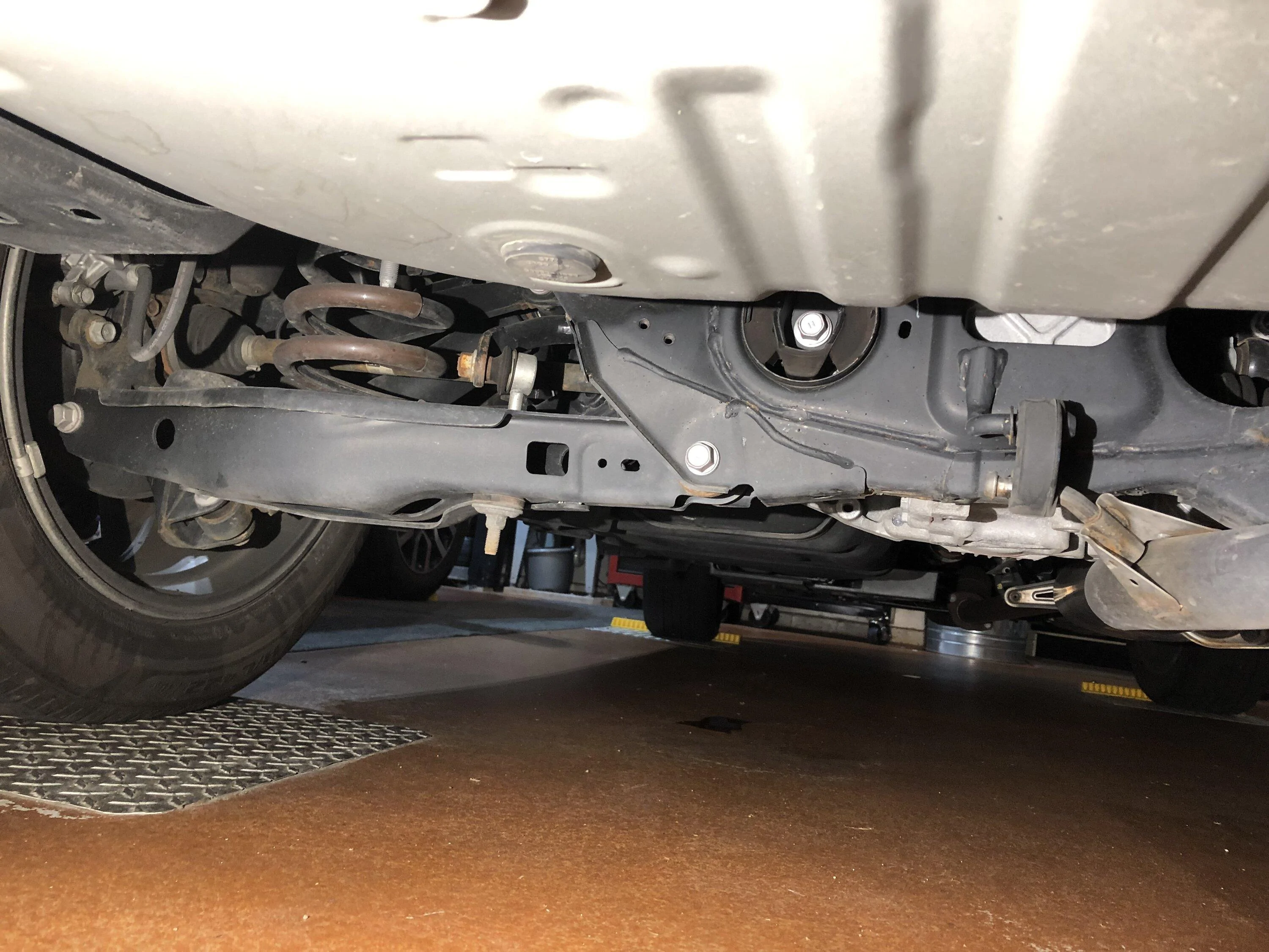

Those are 70k trucks. How do you think a Maverick will do in salt belt?
Just curious, I went out to see what a 2016 RAV4 undercarriage looks like after 6 years of Pennsylvania roads. Notice everything is factory coated and no rust hardware. How do they do that????
