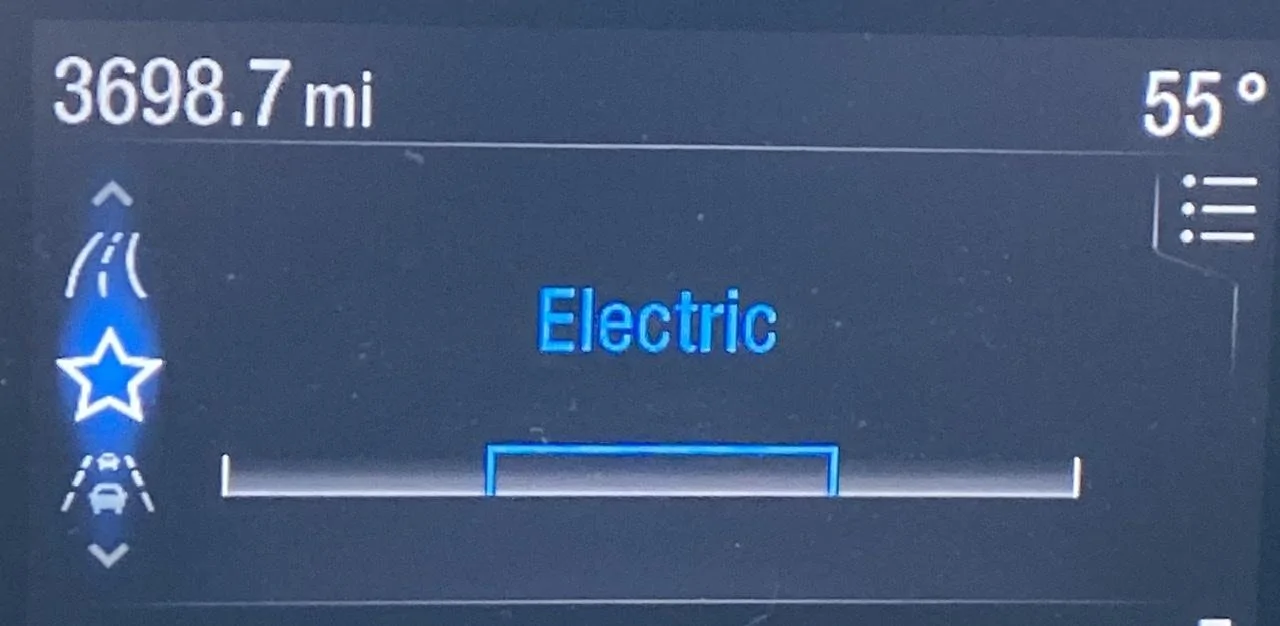

We've had our '23 XLT Hybrid for about three months now. It has been completely problem free, gets 40-50 mpg, and we absolutely love it. I was concerned my wife may not care for the whole hybrid thing, but once I showed her the EV Coach, she feels like she's driving a video game. I think she loves the truck more than I do. Sorry you've had so many problems.
We are new to the hybrid game. what is this EV coach?
Energy recapture for hybrid battery, try to get 100%
Just touch the brake ever so slightly till the generator is spinning and coast to a stop or brake gently to a stop. You are charging the hybrid battery.
I have a Lariat, but it's similar in the XL and XLT. It's a screen that shows you the current energy output and what it's from. Also, shows you when you're not using any power, how much battery charging you're doing through braking or coasting.
It also pops up when you come to a full stop. It shows you a percentage of how much energy you retained from stopping compared to how much you could have retained (it's not a perfect recapture, but it is a rough idea).
Basically, for Lariat (and I think XL/XLT) there's a green and white power meter to the left of the display. When you use power, it's in the white, positive side of the dial (think like a Tach, but for electric usage and production). At 0%, there's a green bar that continues for producing electricity through the regen motor. If you max out that bar, your mechanical brakes activate to continue slowing you down. It doesn't take much to max out that green bar. But on slow deceleration, you can usually stay in the Green until about 1 or 2mph when the mechanical brakes activate to hold you still. That's how it calculates the percentage for the Brake Coach. The more mechanical braking you do, the worse your percentage is. Which is lost power. Which decreases your MPG.
You also can see on the EV Coach how close you are in Electric to switching to Hybrid and the engine activating. Sometimes it's wise to just stay a little slower to keep it in Electric if you know you'll be coasting soon (such as a hill, or to a light). Constantly engaging the engine when you don't really need to is just wasting gas.
