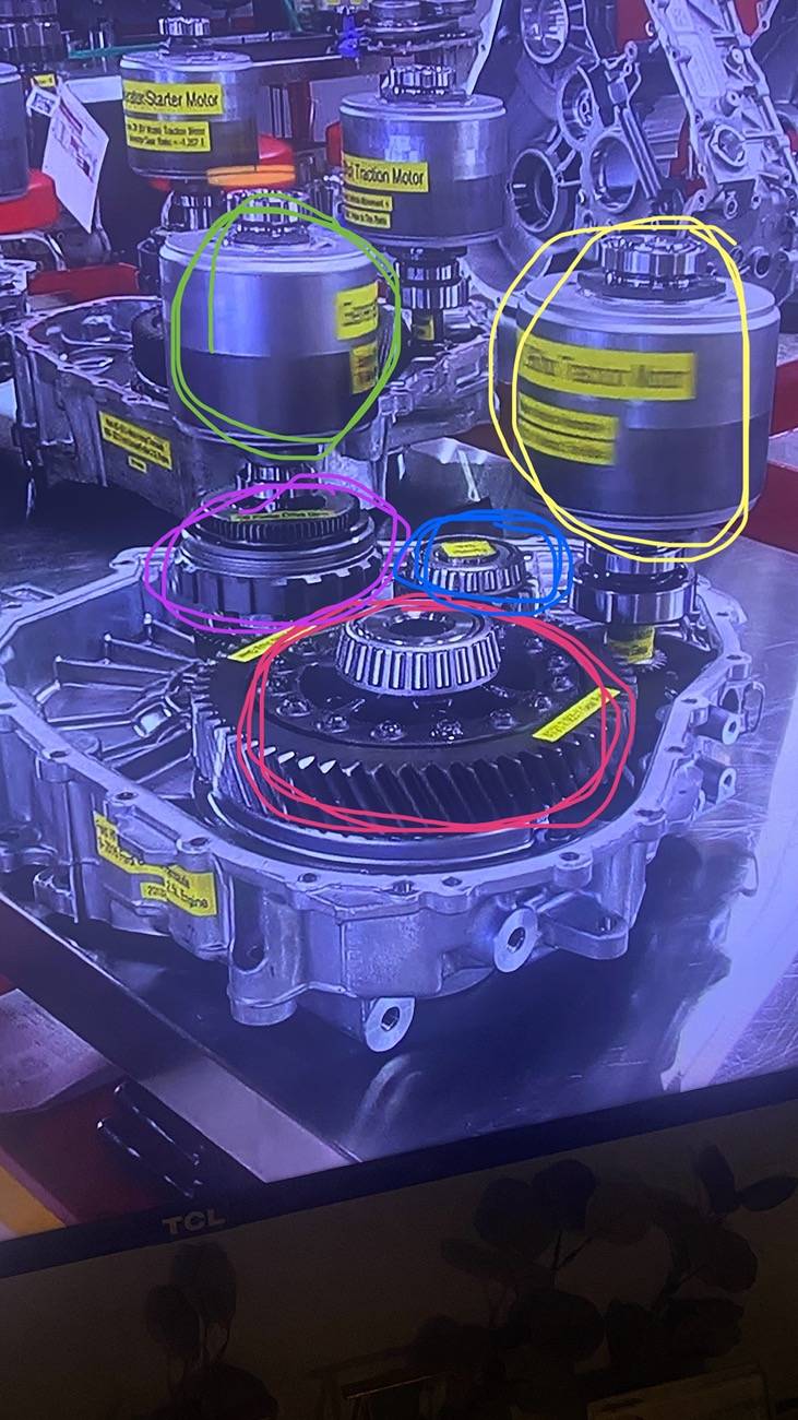

You provided a lot of drawings and animations. I'm sure many will appreciate those. But let me clarify a few points. Your descriptions were wrong.
MG1 is a Toyota term. Not a Ford term.
MG1 equivalency in a Ford is the Generator/Starter motor and is usually, in the first four generations, the smaller of two.
The smaller "Generator / Starter" is connected to the sun gear.
MG2 is a Toyota term. Not a Ford term.
MG2 equivalency in a Ford is the Traction Motor and in the first four generations of eCVT is the larger of the two.
(There is debate / confusion in this thread about which is largest in the 2025 fifth generation eCVT.)
The larger Traction Motor is connected to the ring gear. The larger traction motor provides regen braking / battery recharging, as well as EV mode propulsion.
The gasoline engine is connected to the planet carrier.
The wheels / output shaft are directly linked to the ring gear. The physical arrangement is: Traction motor to final drive (wheels) then final drive (wheels) to transfer gear, transfer gear to ring gear. As in the top drawing, the traction motor is physically outside of the planetary gearset, but meshes with the planetary ring gear after passing through the output shaft gear and transfer gear first.
The output gear / shaft is not shown in any of the pictures above. But is below.
Anytime the wheels are moving, the ring gear and traction motor are moving. The traction motor spins roughy 10 revolutions per wheel revolution. And the generator/starter spins an equal speed in the opposite direction when the engine is off. As the engine starts and speeds up, the generator slows down (gets less negative rpm). If the wheels are stationary, then the generator must spin if the engine is spinning and this will be a fixed ratio. The generator may recharge the battery, or it may freewheel. Just like when coasting down a hill, the traction motor may generate to recharge the battery, or it may freewheel.
The smaller generator / starter does not regen brake, which may be counter intuitive to some.

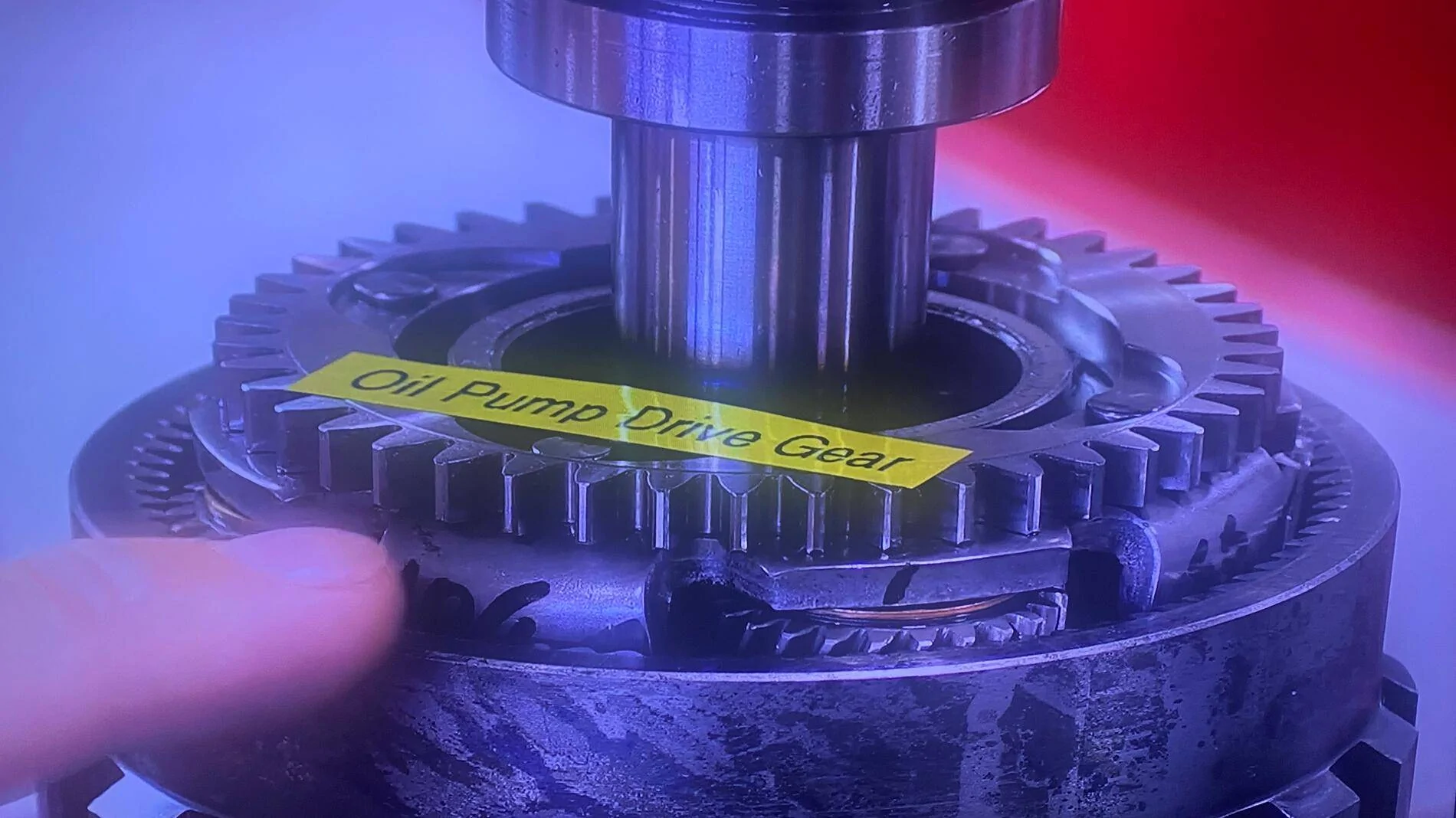

Of worthy note: the oil pump is connected to the planet carrier, thus fresh transmission oil is only circulated while the gasoline engine is running. Which is likely the reason you'll need to start the gas engine every 5-6 hours while flat towing. There is no disconnect of the gears while neutral flat towing. Just the power in and out of the transmission is disconnected.
FLOW:
Yellow is Traction motor (MG2)
Red is final drive / to & from wheels
Blue is a transfer gear
Purple is Planetary Gearset (outside of ring connects to blue gear, not directly to traction motor, but gets to the traction motor eventually).
Green is Generator / Starter
DudeMotor (MG1)
Engine comes in from below the table and connects to the planet carrier. (Not visible)
So not quite like the animations, but close.
Image courtesy of WeberAuto YouTube Channel
