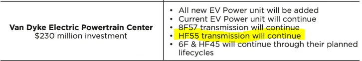

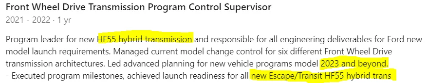

Most likely just another upgrade of the existing system. In this case, sounds like it is targeted for the Escape, which doesn't use the same model as the Maverick. It likely has some of the improvements used for the Maverick, in an improved package. Remember the AWD system for Ford hybrids uses a separate rear motor, that is not connected to the transmission. I doubt we'll see more towing in the Maverick hybrid or EB any time soon. Got to force people into bigger trucks with better profit margins somehow.

The Ford press release does not list the HF35 as still being made. By now, the Escape most likely is using the HF45. Why keep making two design when the HF45 is better and probably cheaper since it uses their own motors instead of ones purchased from Toshiba.
Ford has two designs for the Hybrid CVT AWD. Since 2005 the Escape Hybrid has used a mechanical AWD. The Lincoln Corsair is the Hybrid that uses the electric motor driven rear wheels.
I was unaware Ford was using such an old school system, thought it was just Honda doing that.
