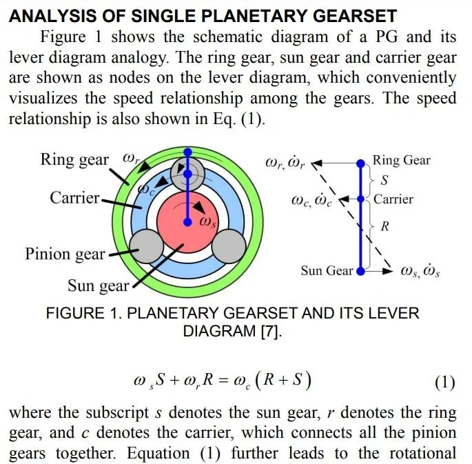

There is one central fact. Might help to boil gear operation down to a simple equation:
Ford Maverick A specific eCVT transaxle question Planetary_Kinematics
Equation (1) is about as simple as engineering can get. It's a law, it's always true here.
The "omegas", or "w-looking" Greek letters are simply the spin rate variables (RPM or radians/second, whatever units you want) of the various parts of the planetary gearset, subscripts "s" for Sun gear, "r" for Ring gear, and "c" for Carrier gear. (The big letters "S" and "R" are just constants, not variables.)
The ICE engine turns the Carrier gear, MG1 turns the Sun gear, and MG2 turns the Ring gear, and the Ring gear only moves when the Maverick is moving (turns the wheels directly).
Your right foot commands the Ring gear (MG2) directly, and the engine & MG1 simply spin to satisfy the equation.
Think of our Hybrid Mav as a pure EV, conceptually, ...... with an engine and MG1 kind of "helping" it out when necessary. ... So, MG2 on the ring gear is the master (your right foot controls it!), and the engine & MG1 are really just doing whatever they have to do in order to help with power or generate power.
Now zero out any omega you want, to illustrate some ways it works:
Example: Zero out the engine omega(carrier) to show that the sun gear must spin in the opposite direction as the ring gear when the engine (carrier gear) is zero, engine off.
Example: Zero out the ring gear, which means the Maverick is not moving, so MG1 must spin when the engine is running.
Example: Zero out the Sun gear (MG1 not turning). This means the engine is spinning with MG2

I think it is worth pointing out the the majority of the power of the drivetrain comes from the ICE, not MG2, but it's not clear at what situations the eCVT is performing series hybrid transfer of electricity from MG1 to MG2, vs pushing on the ring gear directly. So I would say that MG2 is more the component that fills the niche use cases, rather than the ICE being the support.

I don't see how. A differential allows one input shaft to drive two output shafts whose speeds vary. In a hybrid, they're usually connected downstream of the traction motor, with the motor as the input shaft.
You just need to invert the power flow through a differential to see how it is equivalent to the planetary gearset. You attach the ICE to one wheel, MG1 to the other wheel, and MG2 to the driveshaft which would become the power output.
In a car if you lift it off the ground with the transmission in park and you spin one of the drive wheels, the other will spin in the opposite direction. If you were to put it in drive and let the wheels spin, and you stopped the left wheel by hand, the right wheel would spin faster as full power is now going to that wheel. If you were to spin the left wheel backwards the right wheel would spin even faster forwards.

Planetaries are pretty cool, been around for a long time. I used to work on large Epicycles for my old company.
