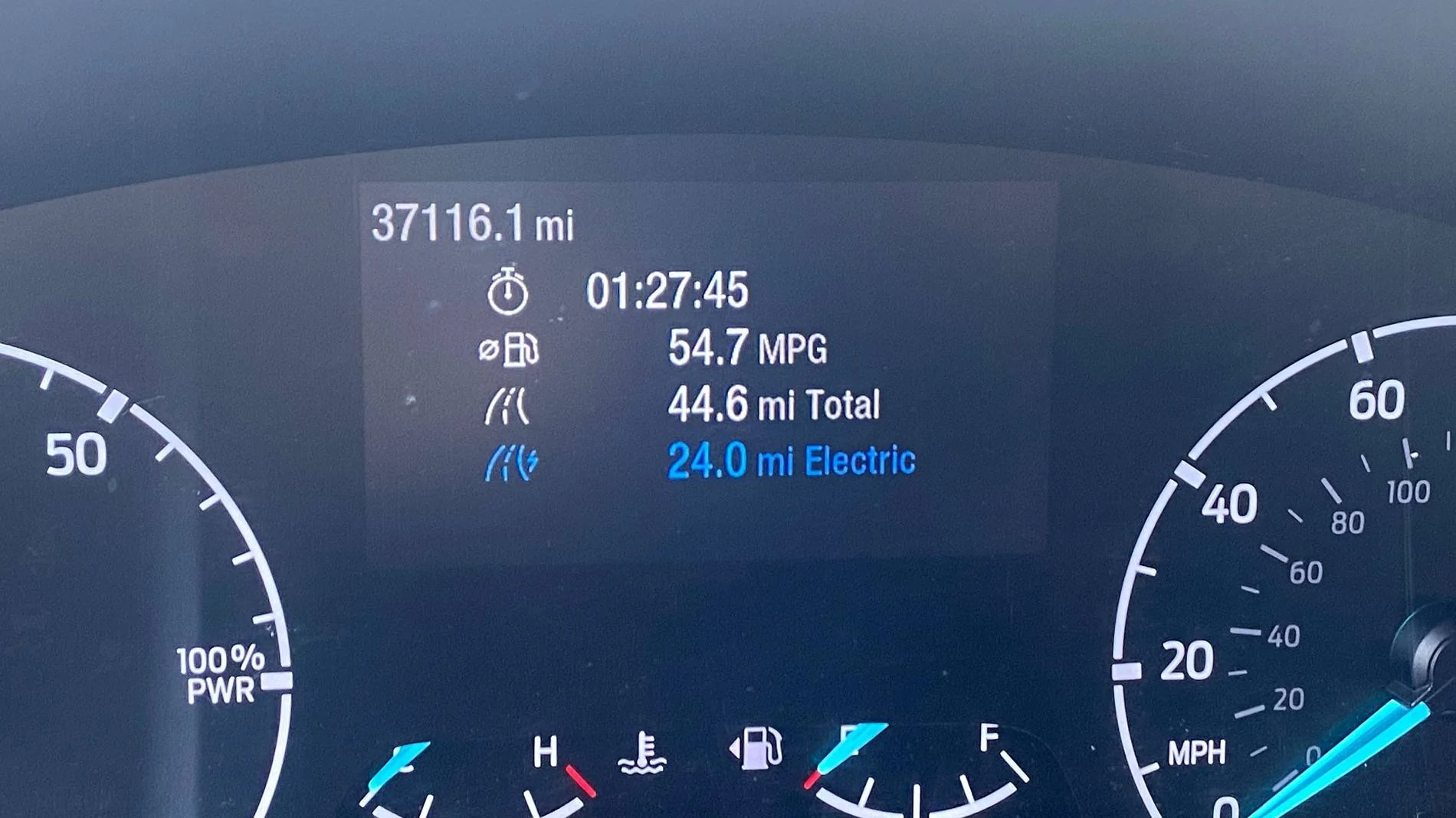

I do this every day:

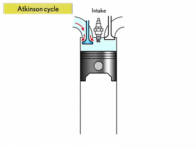

There’s some engineering challenges with Miller cycle turbocharged gasoline engines. That is most likely why Ford uses an Otto cycle turbo engine in their power boost hybrids, rather than it being a cost issue. But with the Otto cycle, you lose out on the 20% efficiency gain of the Atkinson/Miller cycle engine’s 3:2 expansion to compression ratio.
But you’re right, for 2025 Hyundai does offer a Miller cycle turbo hybrid. Maybe they have overcome the engineering challenges and Ford will be on their heels to replicate this success in the near future.
What engineering challenges? Atkinson/Miller cycle engines have delayed intake valve closing and part of the intake charge is pushed back out of the intake port and into the intake plenum. With the N/A Atkinson cycle, it is no problem. With the turborcharged Miller cycle, they have struggled to get good boost/horsepower levels with satisfactory engine durability.
