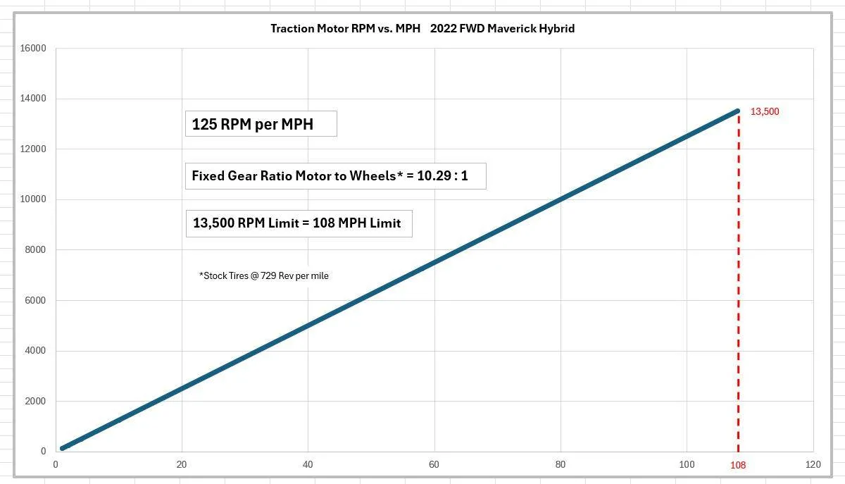

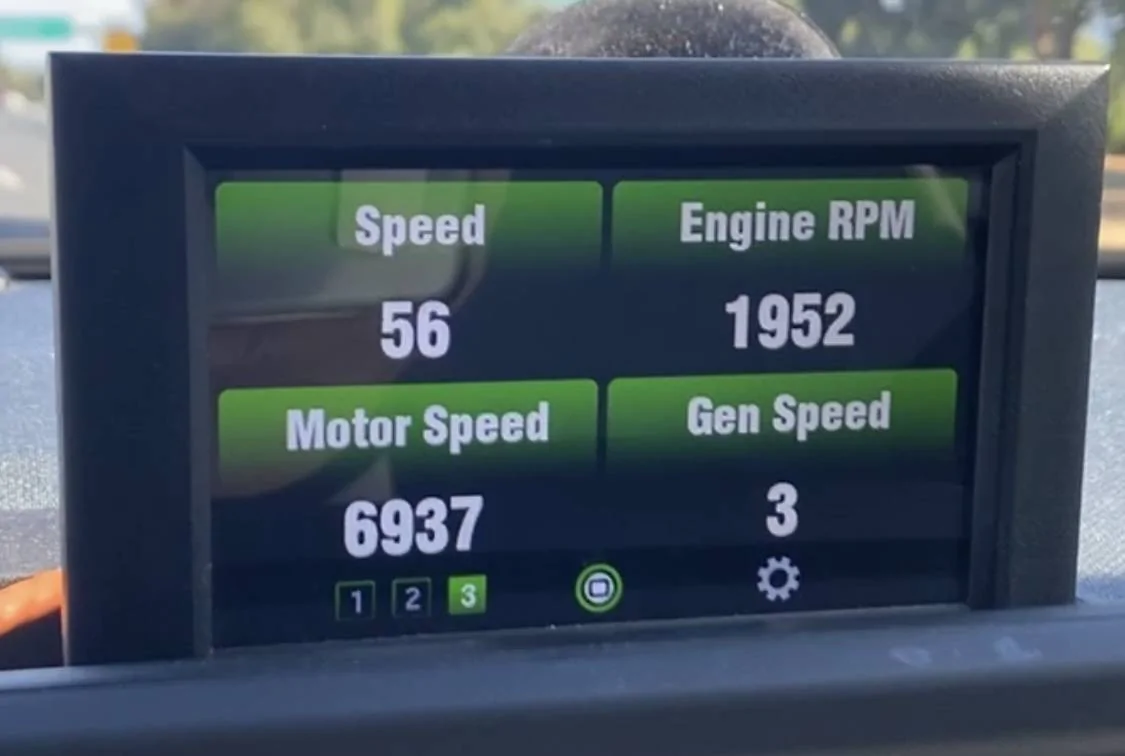

Thanks to your data, I think this would be useful. The duration of each generation of ECVTs still a question due to they have been used all over the world, the rest should be correct.
Ford Maverick 2025 Hybrid Gear Ratios & HF45 Transaxle Technical Info Screenshot 2026-03-21 at 15.23.41
