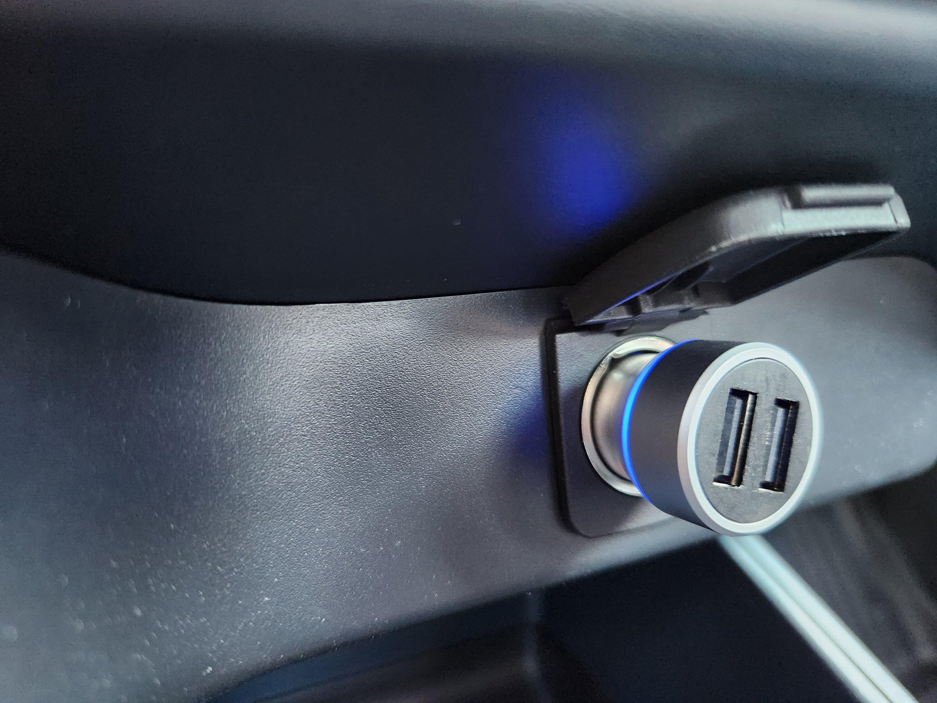

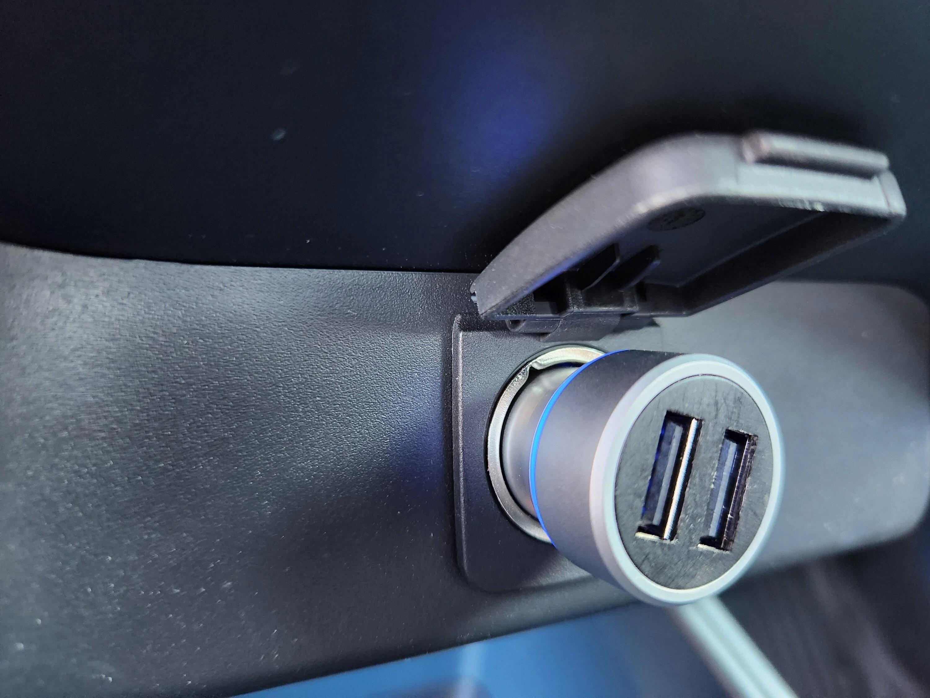

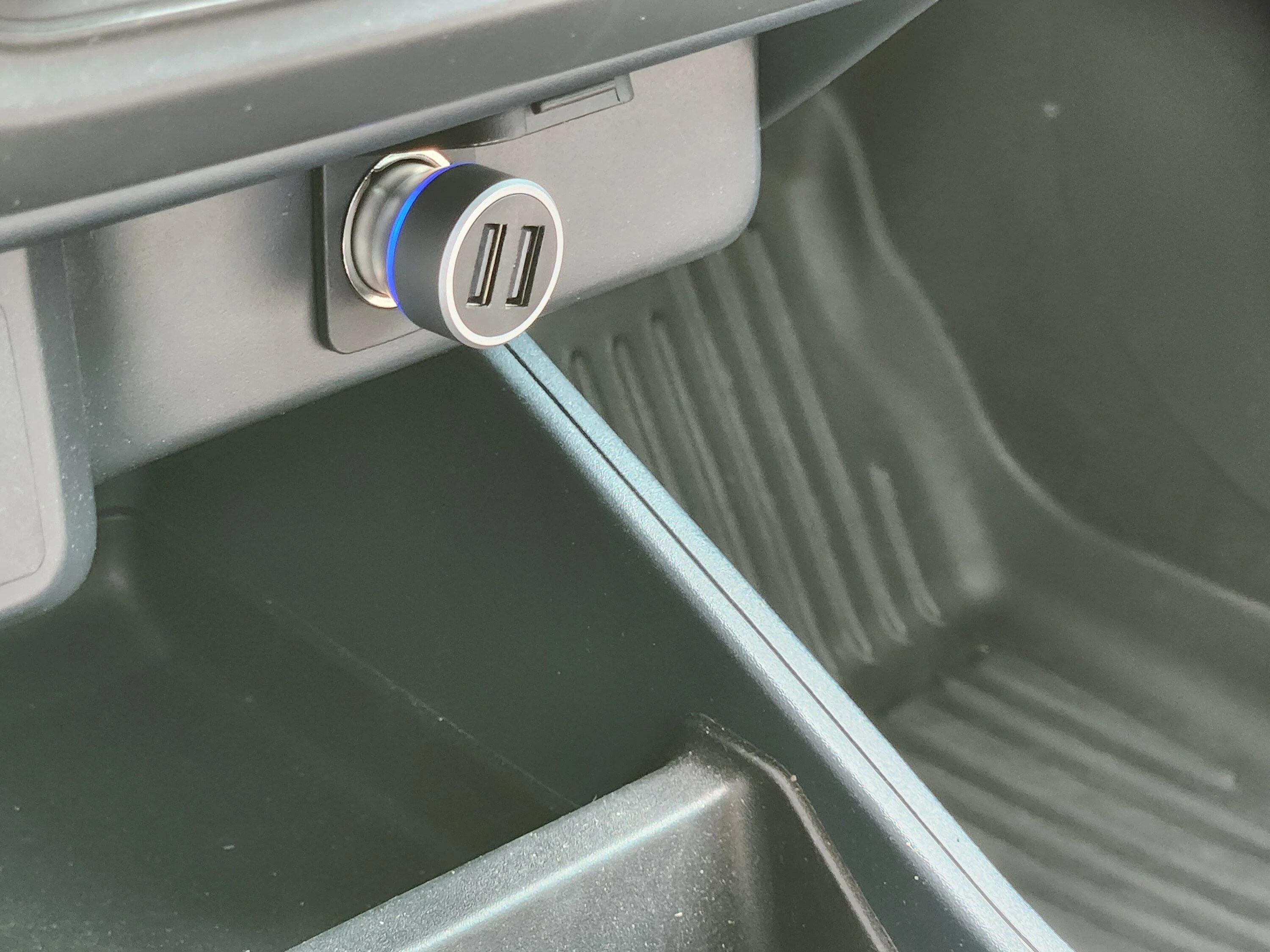

My 23 hybrid the cigarette lighter plug stays on for 90 minutes key off and out door open and closed. Just confirmed this. So don’t just make blatant comments that it does not.

My outlet stays hot after exiting the truck. Just went to Florida a few weeks ago and every time we got out it was still on when we got back in because GPS was still up and running. Not sure how long it stays on though but if I remember correctly, someone checked the bed power source and it was like 90 min.
