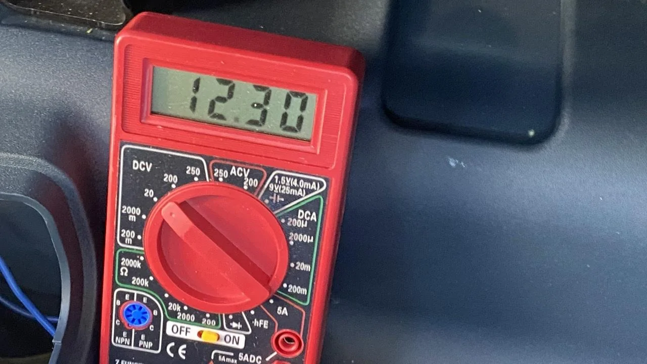

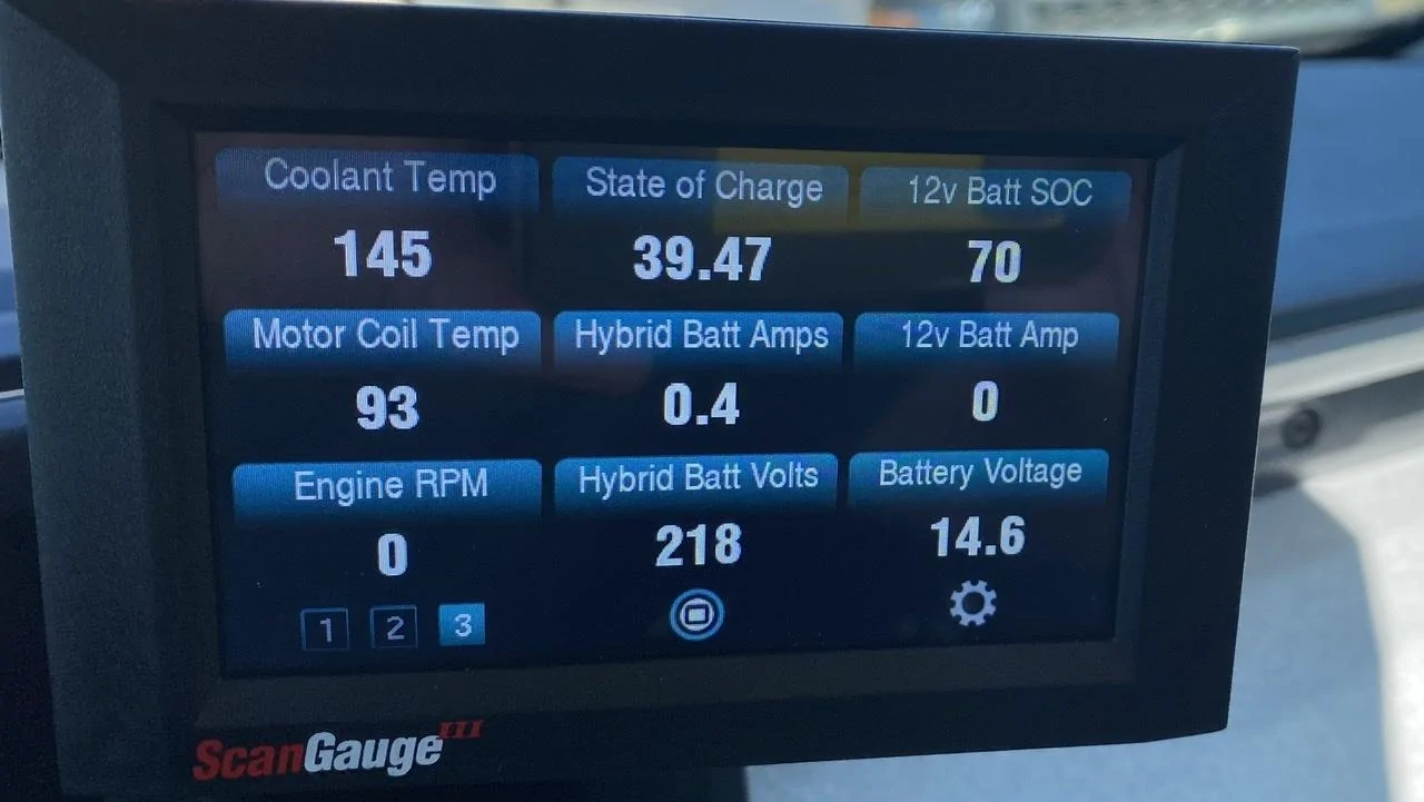

for my 3.x hour test with truck parked and "ready" the ScanGauge showed this:
14.6 volts and 0 amps flowing.
Sure. Ok. Fine. For nearly four hours.

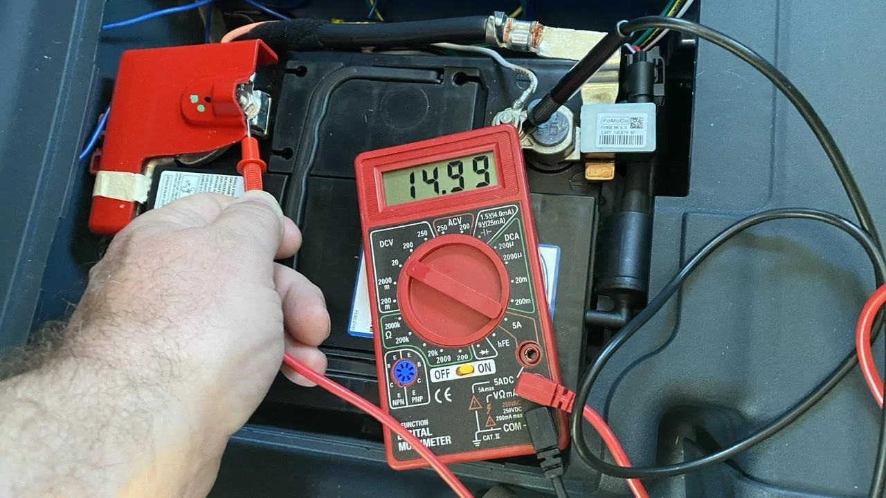

Actual voltage measured at the see lbattery was even higher.

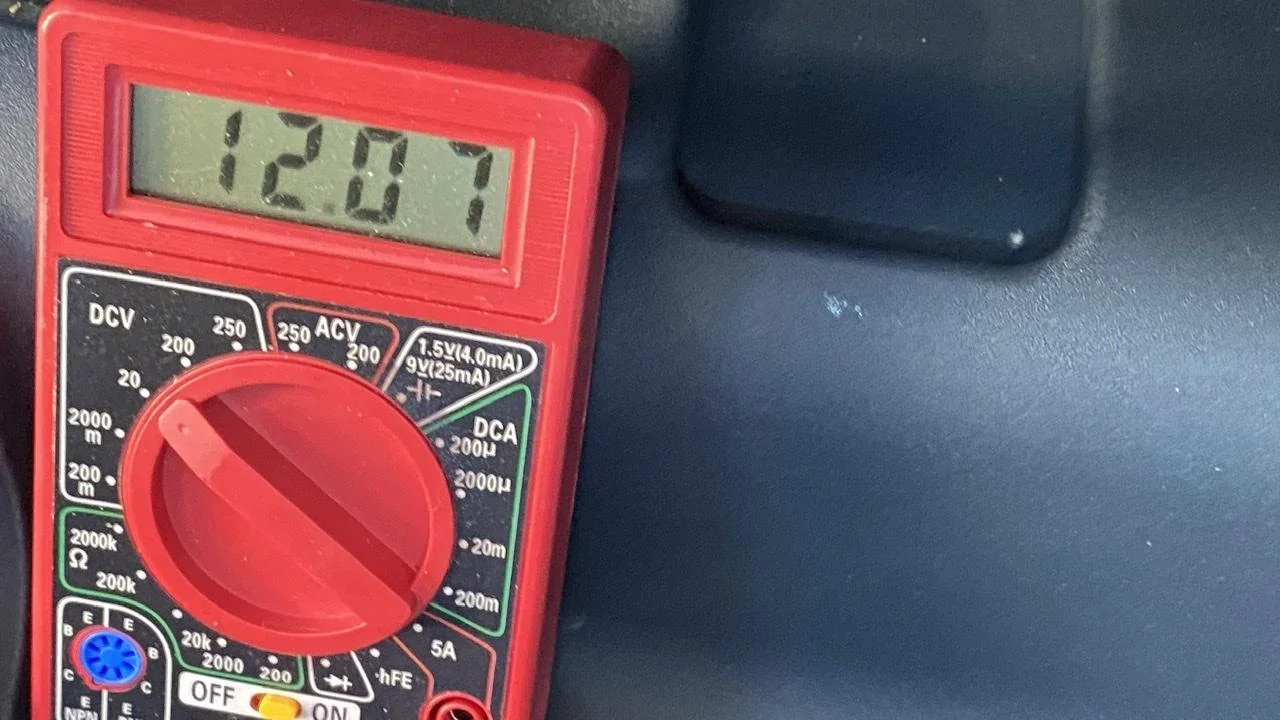

Seconds after turning the key off nets this confusing result:
And slightly higher here:

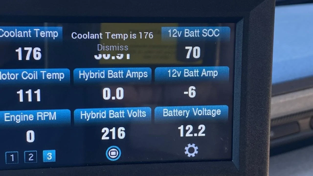

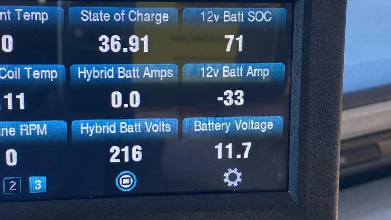

Then, turning on the headlamps nets:
(Might have been headlamps and more; I forget. But was just for a minute.)
and
Not sure what to make of this.
But does not make me feel like this is "healthy". Your take?

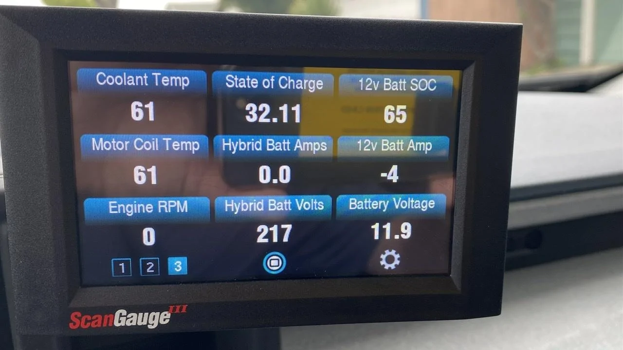

The following morning (you can tell ambient was 61 degrees also 😎)
Interesting: in first pic scan have shows 70% soc. Where is scan gage getting 70% bms or probably a memory location that has not been updated and possibly was or is the trigger point soc at which some function will happen (I am ex programmer and can see multiple table items related to 12v soc) and is not the current soc. The voltage at 0 implies dcdc converter is furnishing current and 12v may be charged or too hot to be charged or? The voltage at 14.6 appears to be the 100% charge settled voltage and there probably has been no charging for 45-60 minutes maybe more. Since you show 14.99v at the battery I assume that the dcd converter is still active. The bms is attached to the neg battery post and will control charging from there. (I know not how). If you wait for the dcdc timeout you would read the battery at 12.6 LESS WHATEVER IS DRAWING CURRENT AS YOU WILL BE TAKING AN OPEN CIRCUIT READING. The 12.2 and 12.3 reading are just different devices and maybe at different lengths of wire to ground.
The 11.7reading is because of the 33 amp draw. The 12.07 reading is probably closer to the battery and again open circuit readings at different points.
The following morning. The 12v soc at 65 implies that 5 have been used of the 70 (whatever that means) the truck had a snack of 5 which is reasonable. Ok a thought "it is logical that if the 12v will be disconnected (aaarrrggghhh= DEEP SLEEP) at an soc of 30% the 70 and 65 field readings is the soc countdown switch off at zero and is in computereasy "if soc countdown equal 0 perform DEEP SLEEP routine". Any how that's a thought. Put a volt meter in cig style plug and read battery open circuit reading with key in accessory position before turning to run. I do believe in a post you said was in 11.xx range. I do think there is something wrong happening which will be found.
