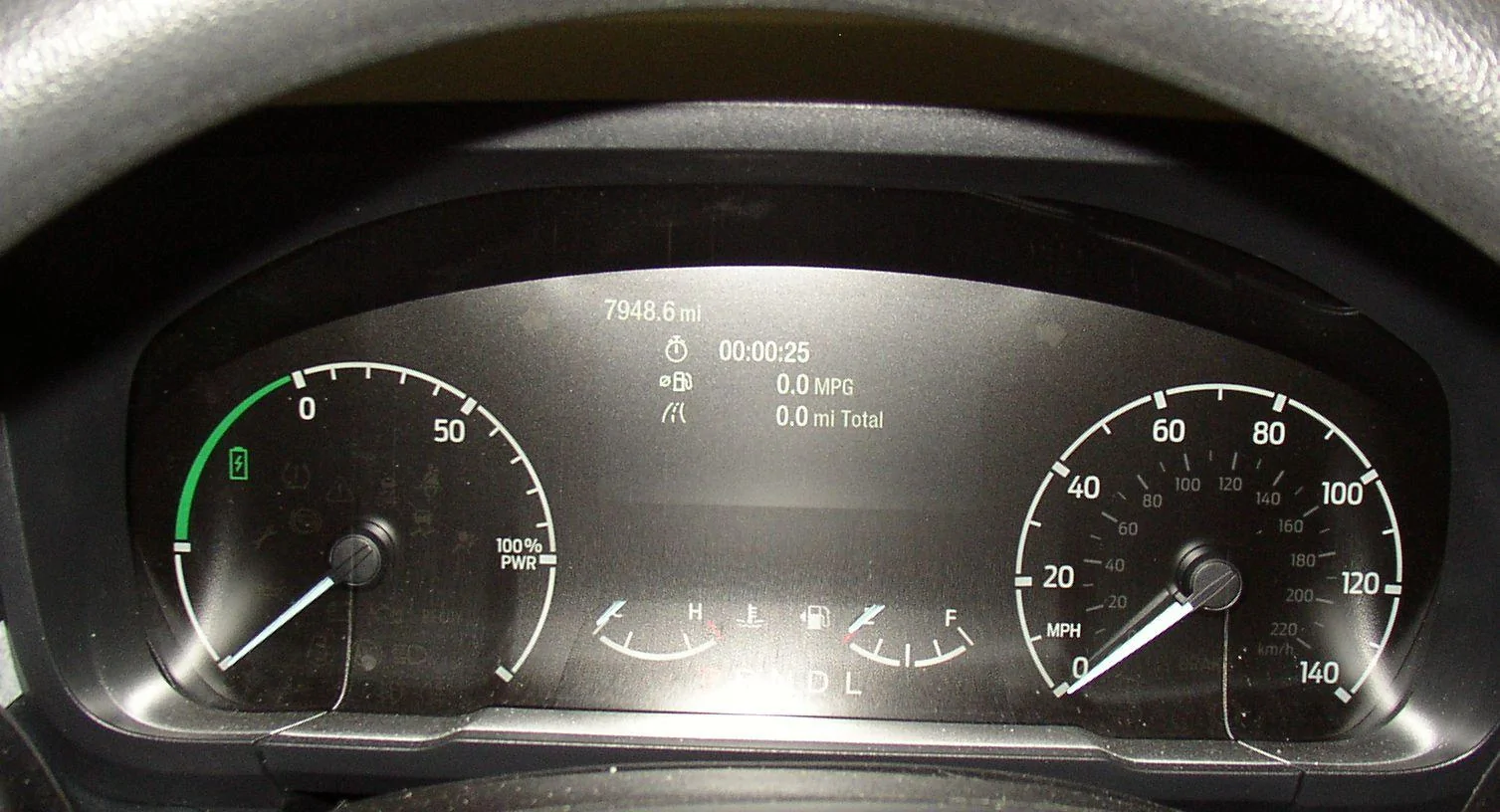

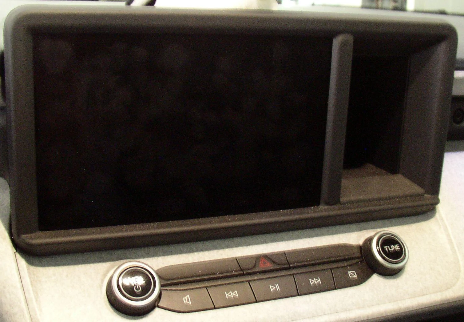

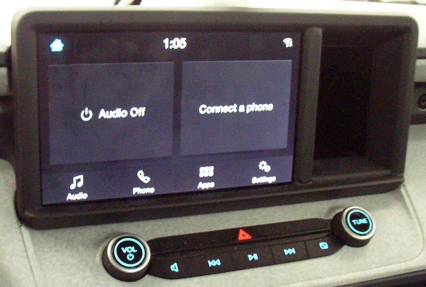

I too have checked and my Hybrid Maverick does the following:
Picture of vehicle dashboard just "Turned Off with Door Closed"
Ford Maverick 12V Parasitic Drain - could it really be this easy? Service managers say "Lock your truck" Vehicle Just Turned Off with Door Closed
Display Still On with Vehicle Off and Door Closed
Ford Maverick 12V Parasitic Drain - could it really be this easy? Service managers say "Lock your truck" Display Still On with Vehicle Off and Door Closed.JPG

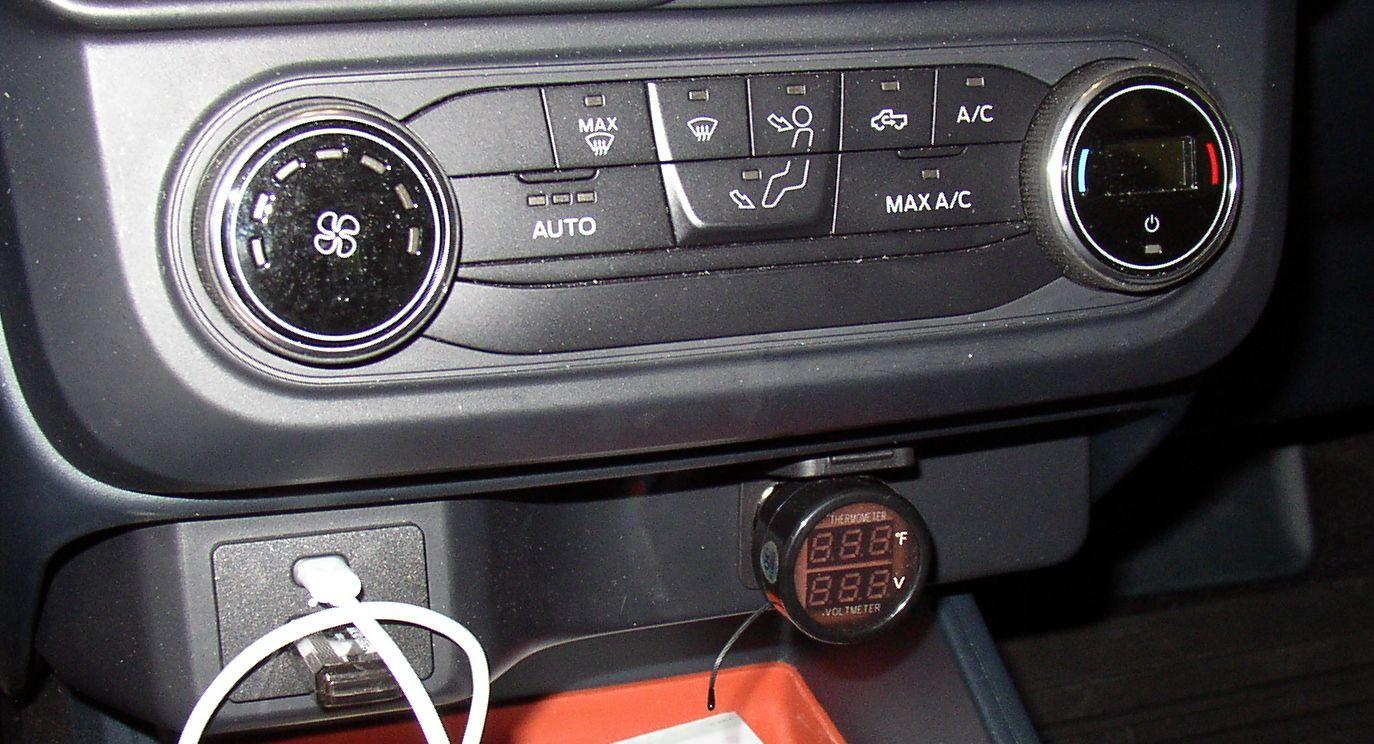

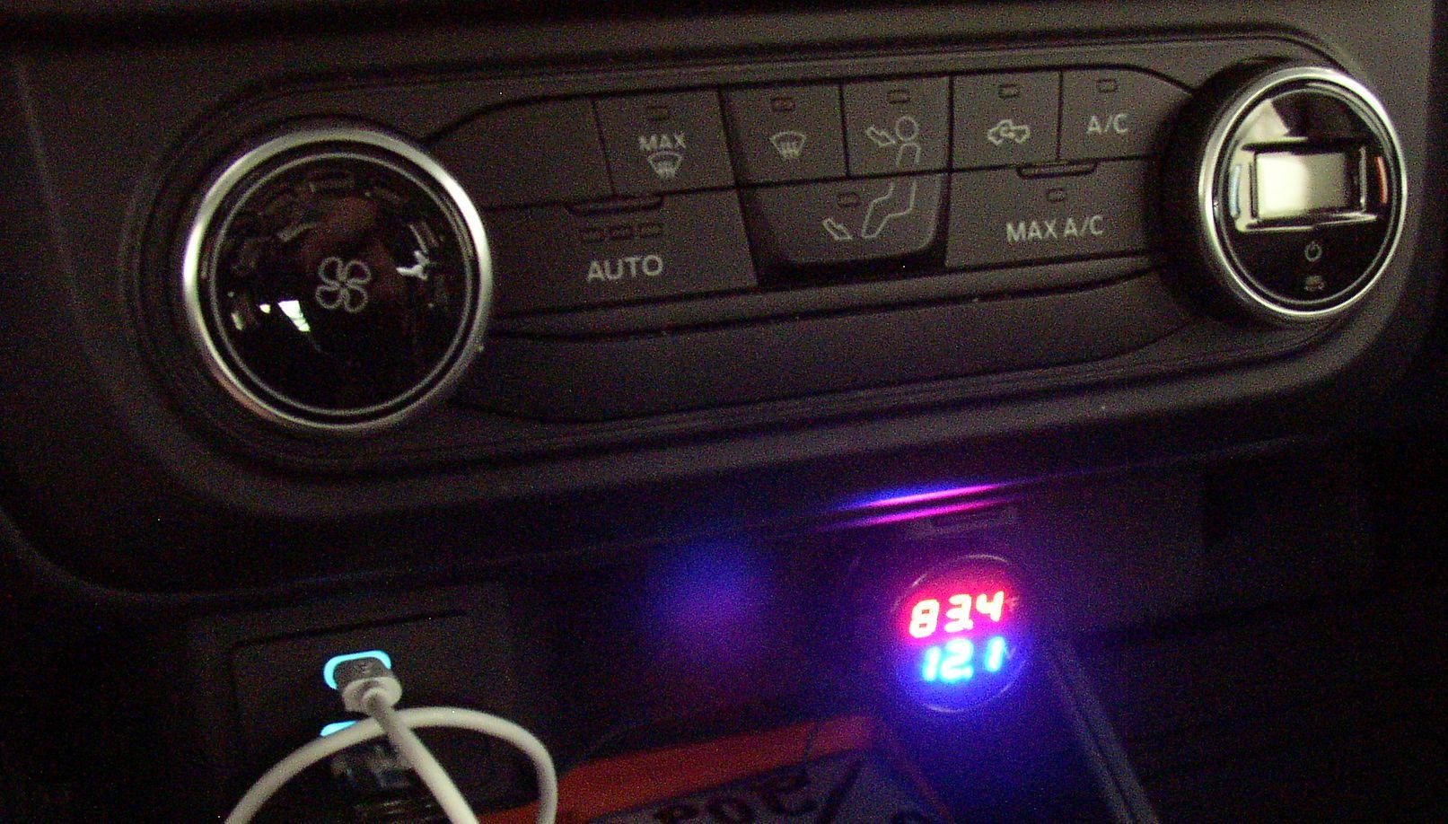

12V Outlet Still Hot with Vehicle Off and Door Still Closed
Ford Maverick 12V Parasitic Drain - could it really be this easy? Service managers say "Lock your truck" 12V Outlet Still Hot with Vehicle Off and Door Still Closed.JPG

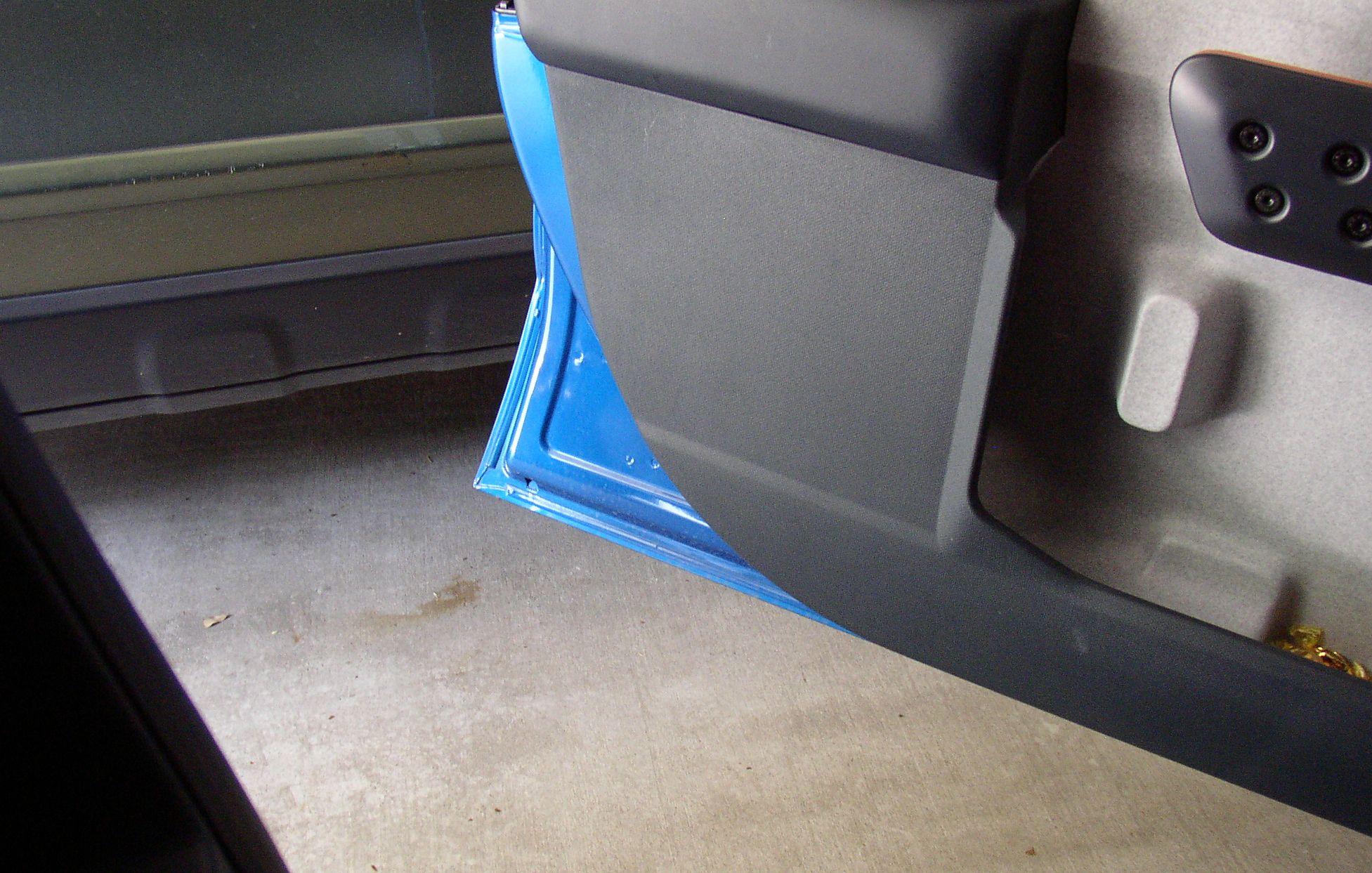

Door Opened
Ford Maverick 12V Parasitic Drain - could it really be this easy? Service managers say "Lock your truck" Door Opened.JPG
Door Opened and Instantly Display Goes Off
Ford Maverick 12V Parasitic Drain - could it really be this easy? Service managers say "Lock your truck" Door Opened and Instantly Display Goes Off
12V Power Instantly Off When Door Opened
Ford Maverick 12V Parasitic Drain - could it really be this easy? Service managers say "Lock your truck" 12V Power Instantly Off When Door Opened.JPG

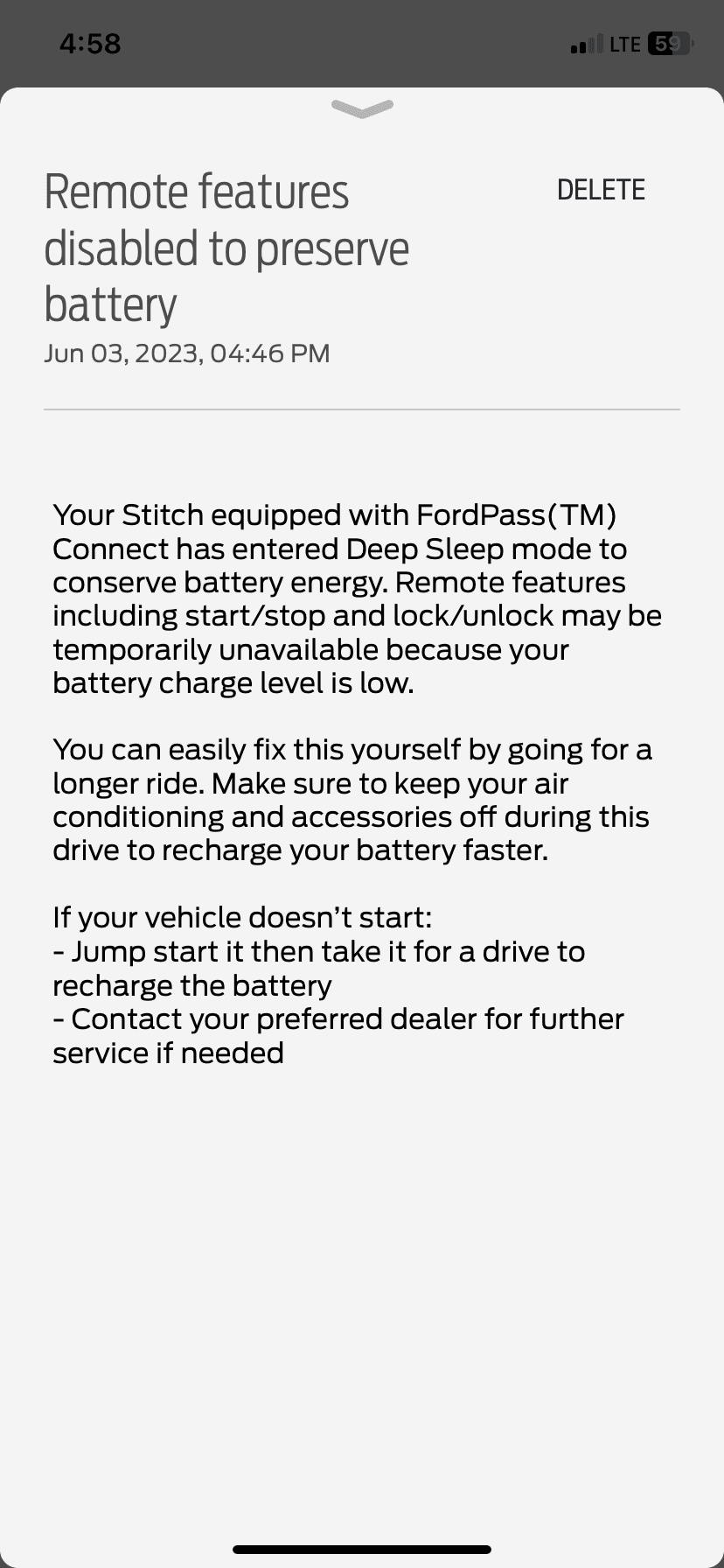

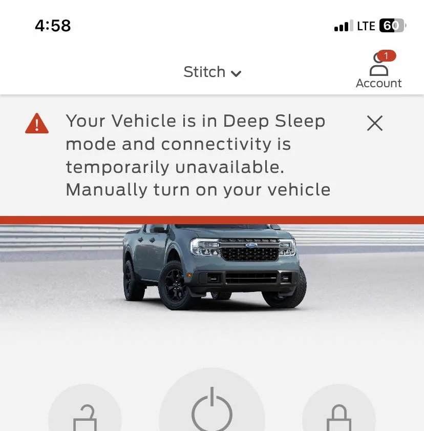

I can say without a doubt that the EcoBoosts are also going into Deep Sleep mode… I got the notification from my FordPass app and took a screenshot of it in the app too.
Ford Maverick 12V Parasitic Drain - could it really be this easy? Service managers say "Lock your truck" IMG_7167
Ford Maverick 12V Parasitic Drain - could it really be this easy? Service managers say "Lock your truck" IMG_7065
Unfortunately for me, my Mav is out for hail damage repair right now and has been for a bit so I can’t do anything about it for a few more days…. But it is definitely a Maverick issue NOT a Maverick Hybrid issue only!
