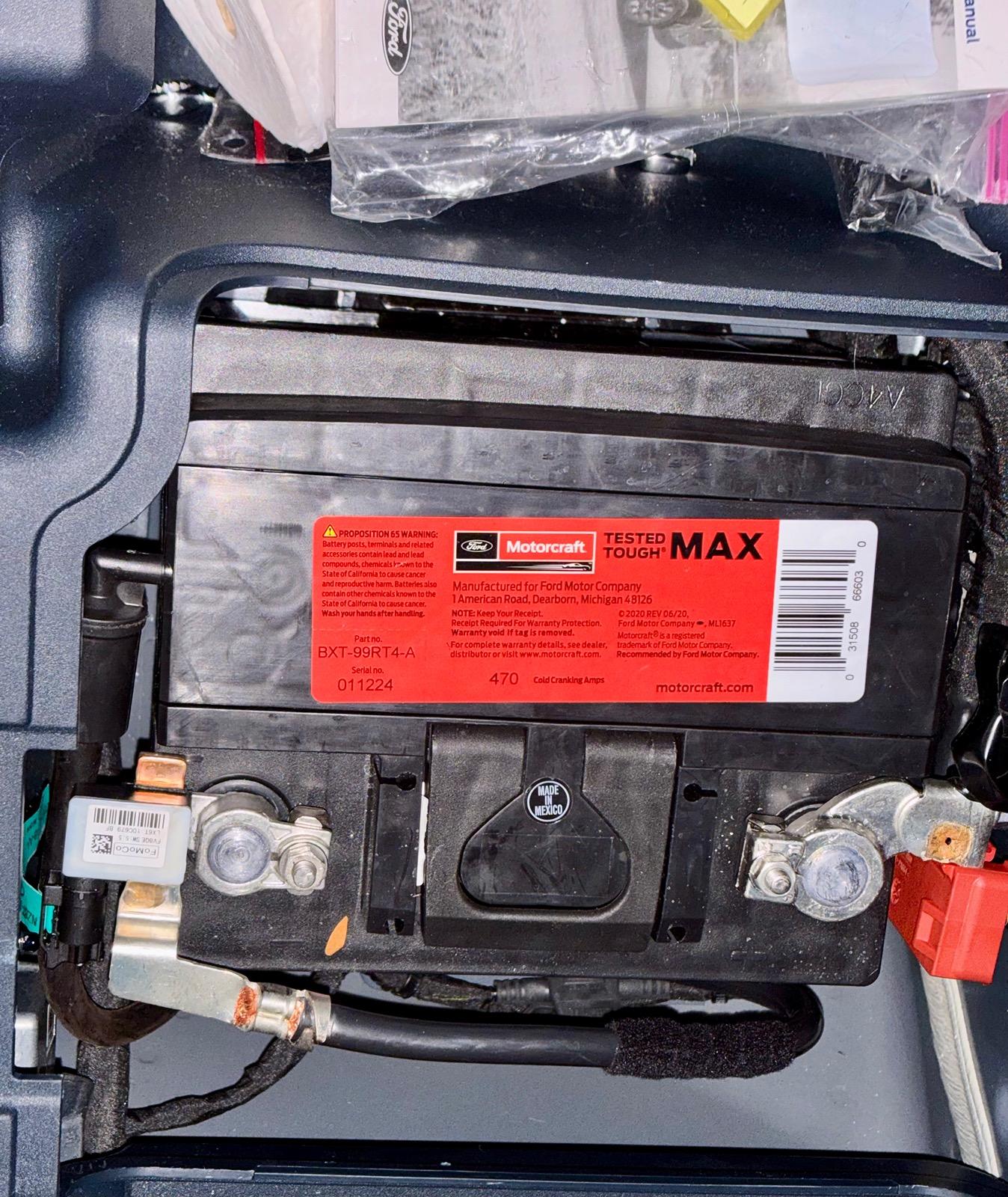

Update : I went to the dealership and told them about the battery drain and they installed this under warranty . I’ll see if this new battery is different .

Until you replace Ford's OEM battery with a AGM non-Ford battery with a greater capacity, you will most likely haves issues with your battery in the future. Many other treads discuss this at great lengths...
Yep. After three Ford Motorcraft batteries were replaced by the dealer, I gave up and bought a Diehard last year. No problems since.
