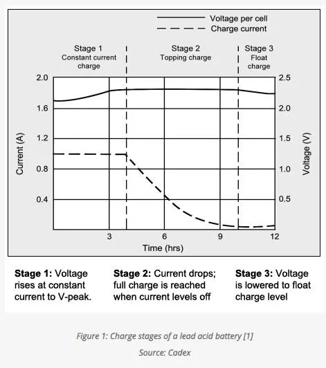

Here's what happened during your long drive.
This is what should happen in hours, but the truck system according to logs is actually minutes, and sadly even a tad shorter than this chart. So you got an extended float charge around 1A or less for a long time.

A recent log of my truck's state of BMS tracking shows this.
Assuming the sensor is even accurate. These are Amp Hrs.
20 - Cumulative Charge Engine On
17 - Cumulative Discharge Ignition Off
4 - Cumulative Discharge in Sleep Mode (I've never received Fordpass notice of this, so must be a different sleep mode)
So even by their own math, accurate or not - this is always on the side of undercharged, never matches (20 vs 21). If this has any bearing on the charging strategy.
Now, somehow despite that I've risen from winter time abouts 50% SOC, to currently around 63%.

Thank you for the chart and real world findings. Ford has got to come up with a solution to recharge the battery quicker, even if it means redesigning the engine compartment to fit a belt driven alternator like should have been in there. We bought our Maverick hybrid specifically for short distance local trips of 10 miles or less to take advantage of the 42 to 50+ MPG in city driving. Was never told you would have a dead battery continually because the Maverick won't recharge the battery. We have two other vehicles and have never had a situation where the battery was destroyed by short trips. Ford needs to own up to this major flub up and fix it.
HeyBales
May 3, 2024
4,942
4,534
KC Metro area
The system controls exactly how many amps are going to just the battery for recharging, from the power that is coming from the DCDC conv, either from motors or the battery.
No need for alternator, as those are even PCM duty cycled to imitate that ability to only be used when needed for the amps desired. And for some systems that method doesn't work great either.
Some of it is smart - like don't enable during the startup and initial warmup, or on accelerations, to cause extra load to the system. Then kick it on higher, tapering off at some point. I've seen some in videos go by time, some by reading a sensor and current status.
Perhaps like the hybrid seems to be doing - tracking in and out amps.
Smarter yet to notice normal driving patterns - and base charging strategy on how often truck is actually driven.
Good grief - there's a table for transmission learning, can't they track average drive times on hybrid!
