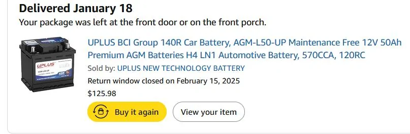

Here’s the one I got but it’s gone up about 50 bucks since I bought it got it on Amazon installation is pretty easy but you’ll need an extension to get the nut out if there’s a clamp that holds it in place and there’s also a drain tube hole you just have to route, but it was about 10 minutes. Make sure to follow the battery. Reset instructions in your manual after that.
Question on the drain tube, is it really needed? Are the maintenance-free AGM batteries sealed? I don't like that they are in the interior and want to be sure it is needed or not.
Sealed batteries have a pressure relief built in incase overcharged.
Vent tube gets it outside if that happens.
Understand how your replacement battery does it - and use it.
Prolly not a big deal skipping it. I guess I was told AGM batteries can release some gas but probably no gel or liquid it’s fairly easy just to replace it since the one you were removing will already have one
