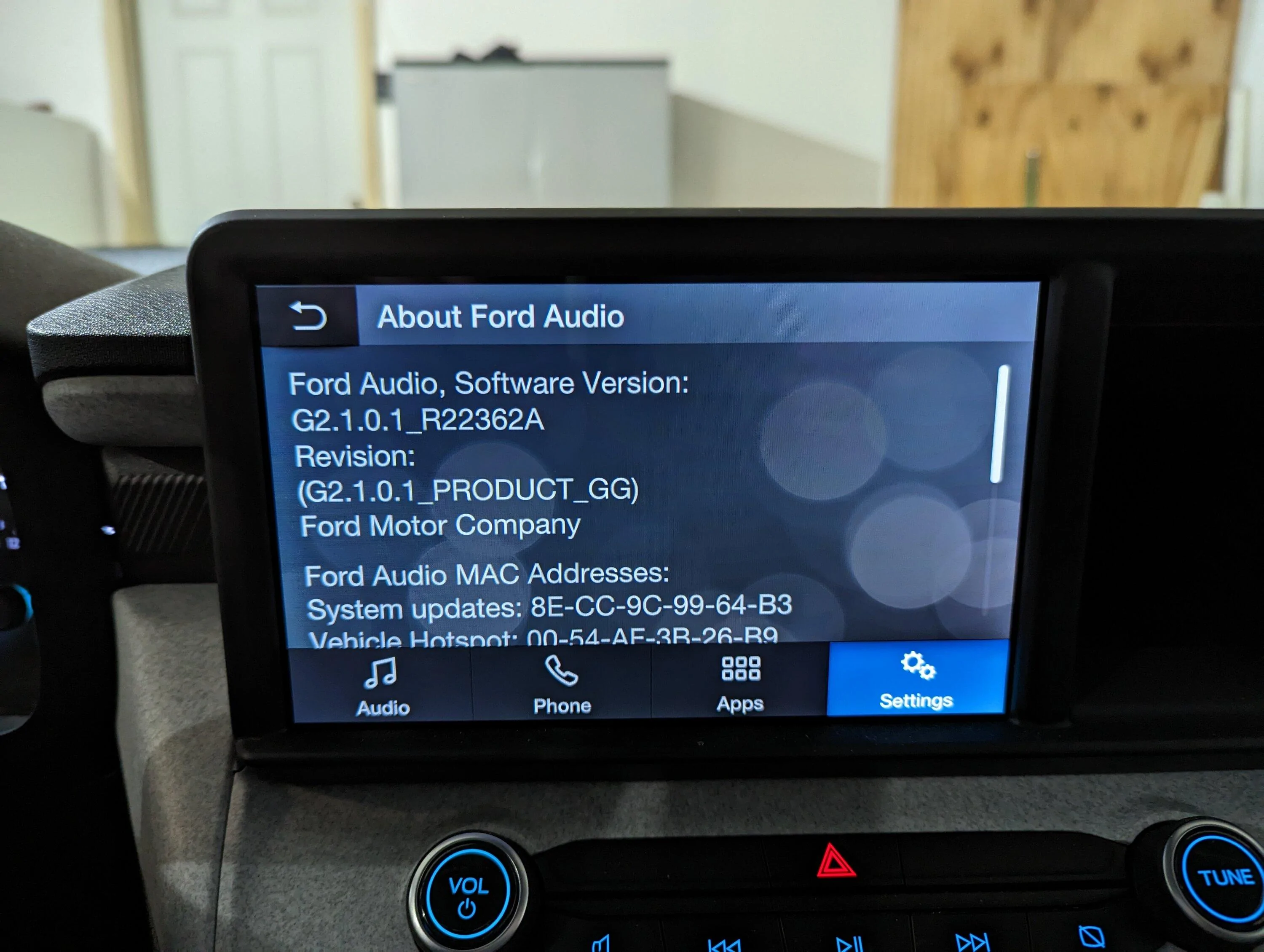

I just updated my 22MY XLT to the most current version. Went from G2.0.0.1_R22285A to G2.1.0.1_R22362A without issue. Just connected the Mav to my 2.4 network connection then tapped the update button twice and away it went!
Just completed the update. It took all of 12 minutes. Soft restart was required. then verbal confirmation was given.
