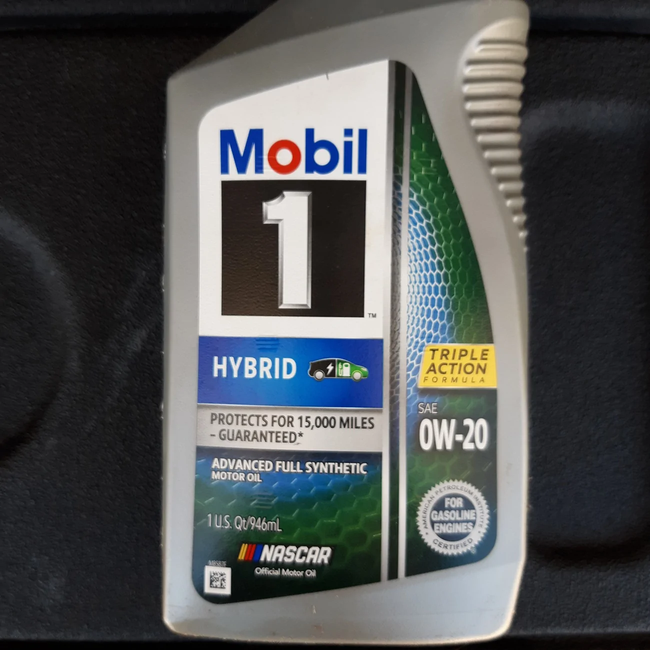

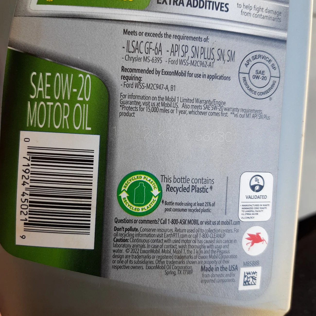

I'm curious.

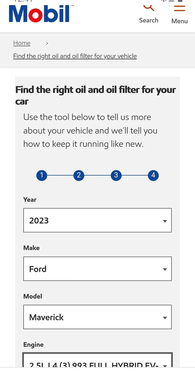

What mobile one did you buy that did not meet these specification WSS-M2C961-A1 for 5W30, or WSS-M2C963-A1 for 0W30
According to mobile using their Interactive online app. Their oils meet or exceed the above Ford specifications.
I believe it was the ESP, it had a green label and they said it was best for turbocharged engines. The only Mobile 1 I found that met the Ford spec was the Advanced Fuel Economy. This is in the 0W30, maybe it is different in 5W30. I will find out in the spring.
Before making a blanket statement about mobile 1 oil. I would go to Mobile's interactive app and download my truck's information see what oil they recommend and then check the specifications.
I looked at the back of the oil jug and it does specify WSS-M2C 961-A1 for both their regular and extended service Mobil-1 full synthetic.
