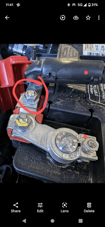

Hail Mary- But this secondary battery lug caused a lot of troubleshooting and a battery swap- Figured out later it was loose from the factory- This lug does not get touched during a battery swap which was over-looked. Good luck
