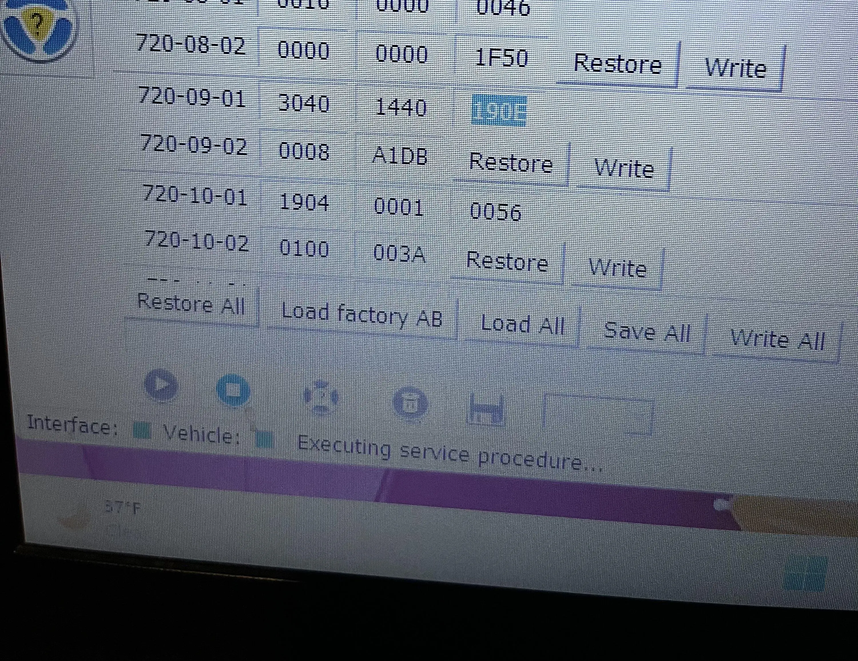

I did method 2 from the first post.
I did just these two settings:
IPMA 706-01-01 xxxx-xxD3-xxxxx
(I had a C9 where the D3 went)
IPC 720-09-01 xxxx-xxxx-8xxx
(I had a 1 where the 8 went)
When complete, I had a ’Traffic Sign Recognition’ menu option. In that menu I have ‘Active speed warning’ checkbox and ‘Tolerance’. Under Tolerance I can go to 5mph max. I ended up not checking the Warning option because I did not like how the sign flashes when you go over the limit.

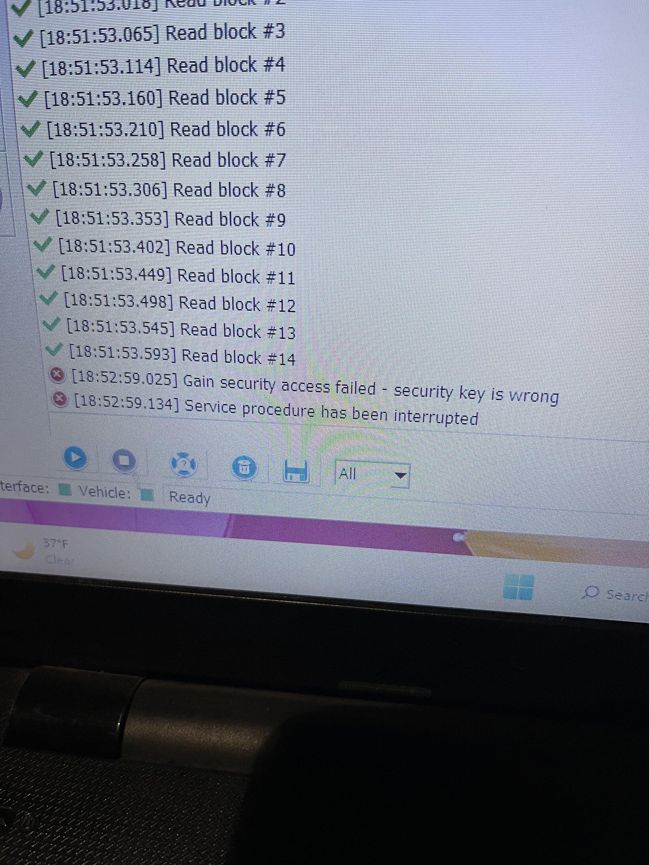

I try these methods and get this error code when I try to rewrite the highlighted code to a different code provided in this thread. Any advice would be great.
Ford Maverick Traffic Sign Recognition (TSR) FORScan mod (confirmed working) 8BDD2B1B-B071-4297-A326-995E4F0B3F0D
Ford Maverick Traffic Sign Recognition (TSR) FORScan mod (confirmed working) EC8538F2-27EF-4252-BD2D-88E1E0F33A56
Did you retry? I had that happen to me when doing some modules. Some took 2 or 3 retries.
I tried probably ten times and got the same error every time
That stinks. Maybe search the Forscan forums, so see if any else has seen that specific error on other vehicles. I know there were some issues with some versions, so make sure you the latest,
When FORSCAN ask to load the saved configuration check NO. Try that.
