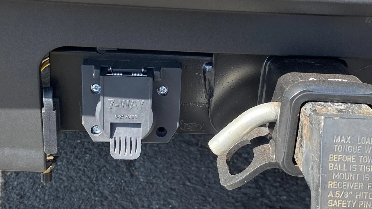

I have both the original 4 pin and I added my own 7 pin.
(4 pin moved, and yes I'm missing a screw, lost one during install, no biggie and has been low priority to find a replacement)
4 of the 7 in the 7 are identical and are interconnected. You'll need to add 3 additional wires only.
1 continuous 12 volt power (or switches on with ignition)
1 for trailer brakes led to brake controller in cab
1 for reverse lamp on trailer (optional and if so equipped).
That install looks great. Care to do a write up? How did you connect to the brake controller and what controller are you using?

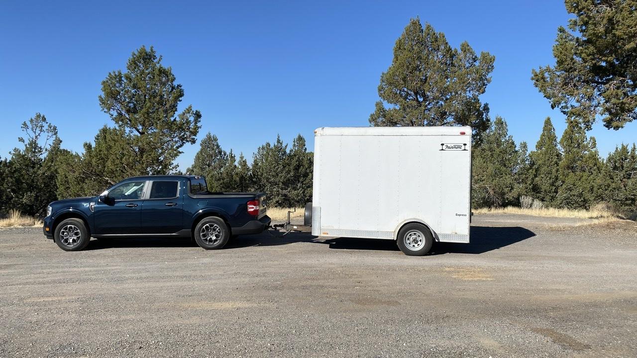

7x12
I added aftermarket equipment.
Will tow an amount over 2 and under 4k. This is a hybrid.

This looks almost exactly like the trailer I own. Full of tools it’s pretty much 2000lbs. How have you found the hybrid for towing? How heavy is that trailer loaded and does it lag on hills?
GPSMan
Jul 28, 2022
4,325
5,340
Many
I think it is as much a parachute effect than the weight that hurts your towing.
That said, reading the OBDII port on the trip, it takes about 55 horsepower to cruise at 60 mph on flat interstate.
Takes about 130 horsepower to climb a 7% grade at 55 mph. It did it without complaints on a 96 degree day.
Water got to 215°F on the 7% grade.
Water was 195°F all day long on flat sections. Of course I had air-conditioning on during most of that 96 degree day. Never considered turning it off to save power. Wasn't that strained for power.
I have trailer brakes, which ironically are mostly for city - stop n go. On the highway, the parachute effect is so great just lifting foot off the gas it slows nicely, even in 4% to 5% down-grade. I think I only tapped the brakes on a 6% and 7% downgrade.
The engine brake does a good job in the hybrid. I was impressed.
You should be gentle with it on hills.
I mainly went 50 mph uphill, no greater than 60 mph downhill, and 55 on flat highway.
