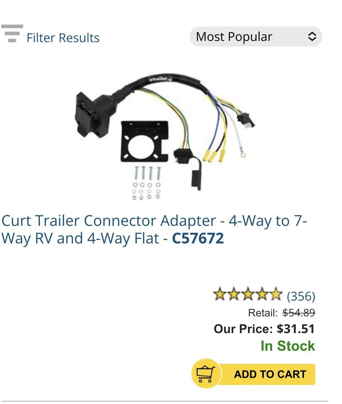

I have a question for people who tow a small trailer with their hybrid. The Hybrid has a 4-pin connector but what if the trailer is a 7-pin? Do you use a "quick connect" plug to connect the 4-pin to the 7-pin or have you been able to convert the Hybrid to a true 7 pin?
GPSMan
Jul 28, 2022
4,325
5,341
Many
I have both the original 4 pin and I added my own 7 pin.
(4 pin moved, and yes I'm missing a screw, lost one during install, no biggie and has been low priority to find a replacement)
4 of the 7 in the 7 are identical and are interconnected. You'll need to add 3 additional wires only.
1 continuous 12 volt power (or switches on with ignition)
1 for trailer brakes led to brake controller in cab
1 for reverse lamp on trailer (optional and if so equipped).

So, it is possible to add a 7-pin connector to the Hybrid. My teardrop does not have electric brakes but a 7-pin connector. I wanted the wire from the 7-pin to the 12-volt battery so I could charge the teardrop battery while driving. Did you do the install or have someone do it?
GPSMan
Jul 28, 2022
4,325
5,341
Many
This:
Ford Maverick Towing a 1500lb camper trailer with hybrid? 9C9E0161-EB52-4842-82FC-2E3ABE475D1F
This connects to the stock plug. No cutting or splicing.
You run your own 12v positive and brake control wire to cab. There are pre-made holes in the battery box under the seat.
Very convenient to DIY.
HTH
GPSMan
Jul 28, 2022
4,325
5,341
Many
The nice thing about the above part is you get two ground wires. Two SEPARATE ground wires. Being outdoors, wet, in motion, etc. this will double the reliability. Many times lamps fail due to poor grounding.
The white wire (stock) supplied by Ford is one ground path. The Curt white wire with ring terminal (to go under a small bolt) is a second redundant ground path. I kinda like that.
