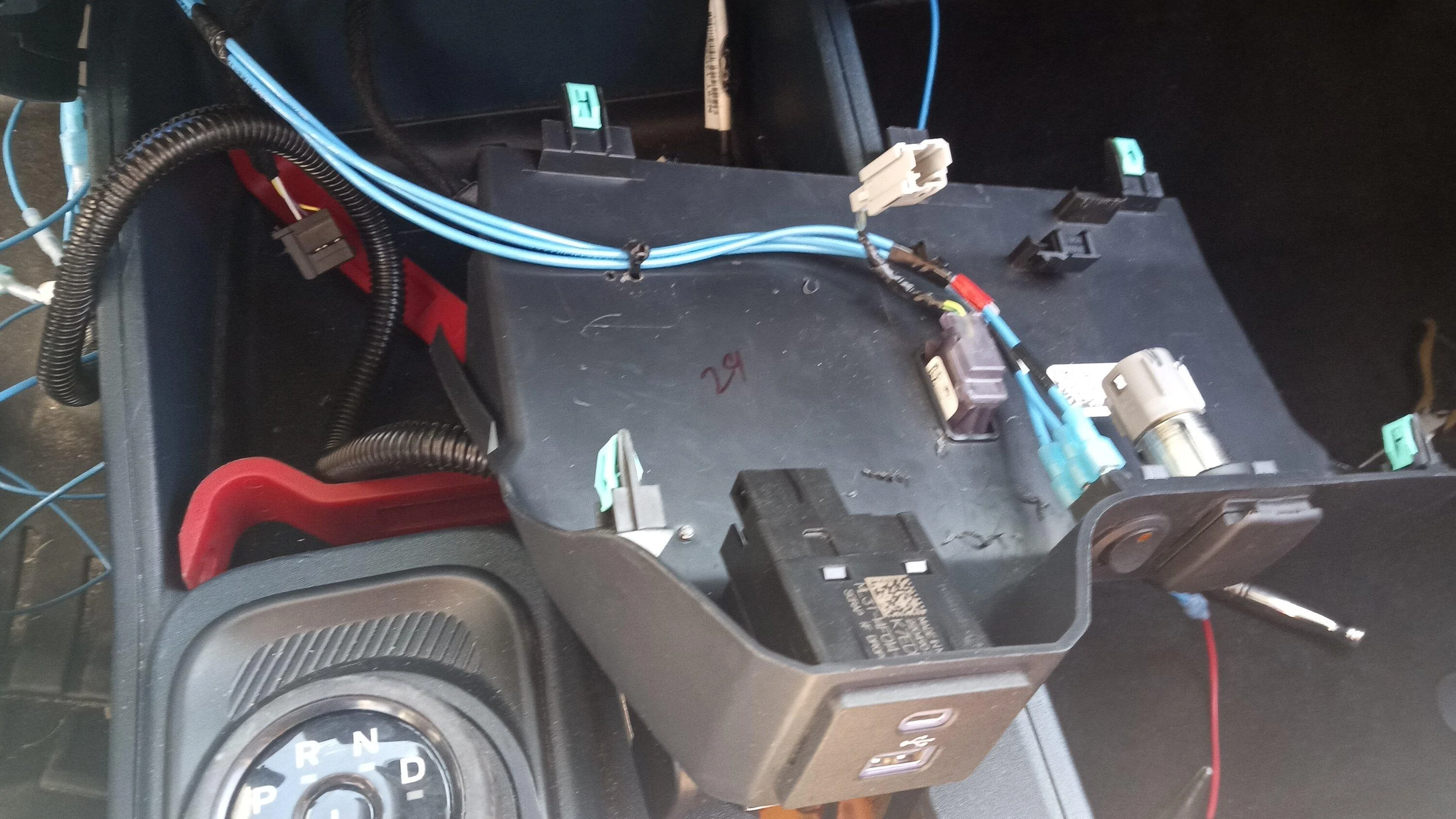

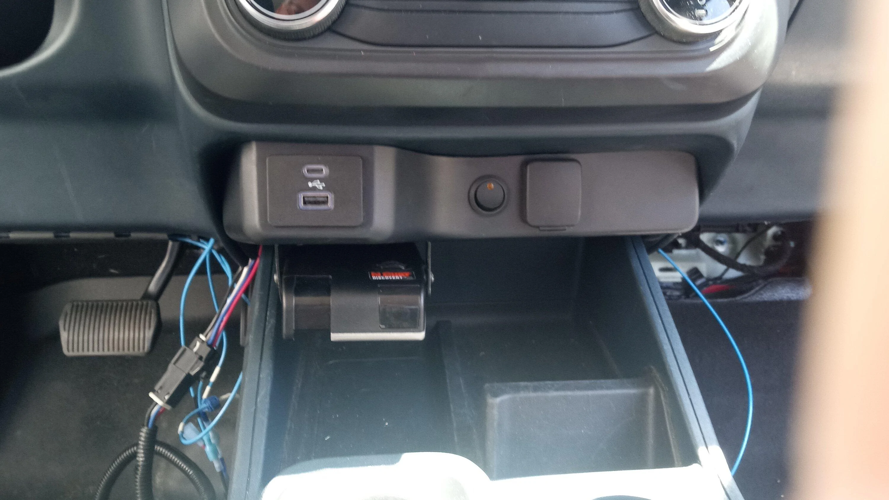

My Brake controller add on information:
After long winded explanation are pics of unit and my schematic showing the electrical connections of the project including the brake switch connections.
Note: I used a lighted toggle switch for power to Curt controller to prevent possible battery drain when sitting for periods of time. May not be necessary but wanted to be on the safe side.

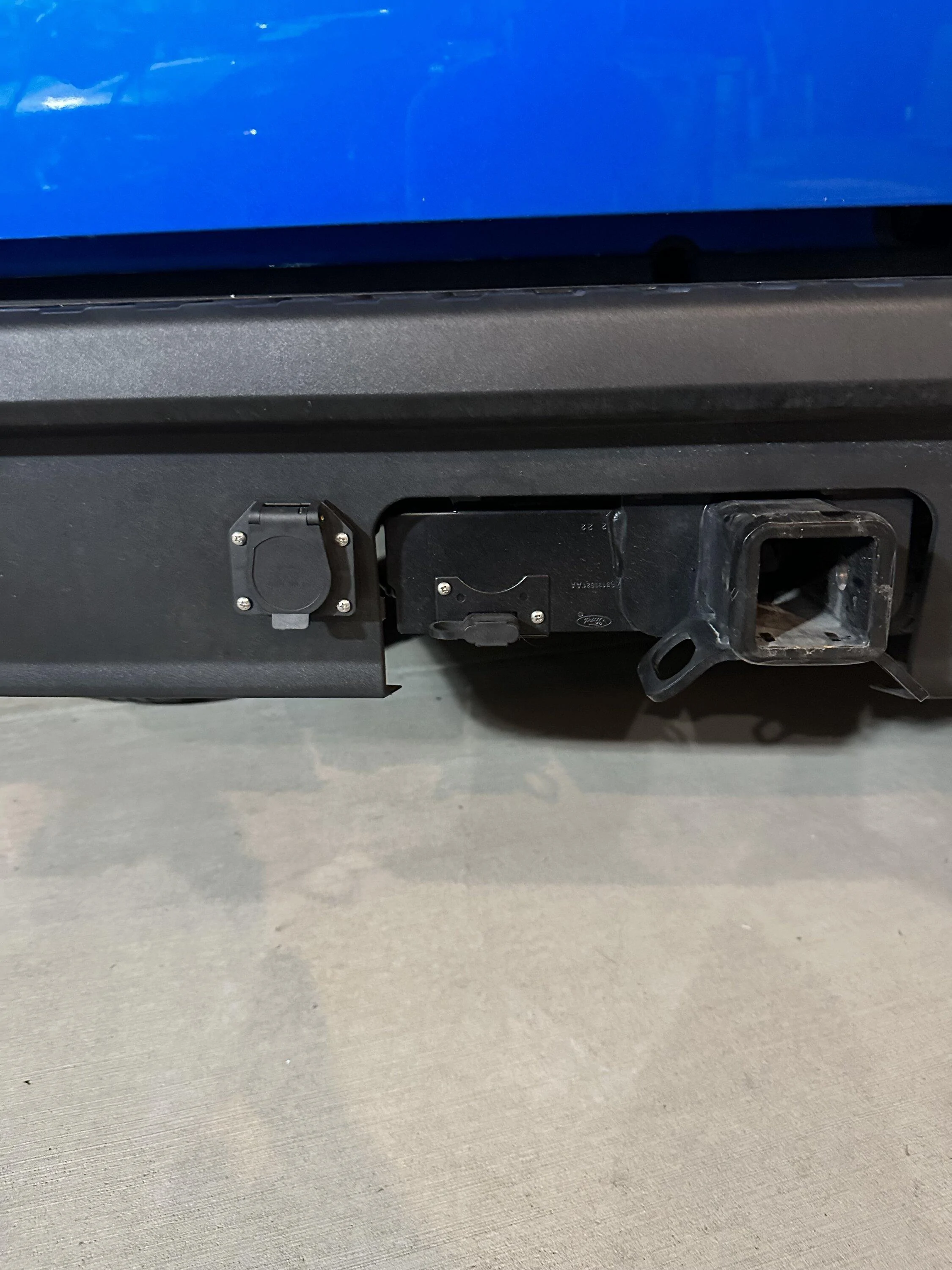

On my 22 Maverick I bought a universal fit 4-way flat to 7-way RV blade and 4-way connector kit. I did not have to splice into factory wiring to get the 7 pin from the 4 way on the truck. The factory truck 4 pin plugs into the kit and the kit supplies a second 4 way pin and bracket.
I ran 2 wires from the rear of the Maverick to under the dash for the ground and brake output signal on the Curt brake controller. These 2 wires were routed under the trim on the driver's side and out to the back of the bed under the truck.
One of the 2 wires is used for the ground for the curt brake controller and the brake controller toggle switch light. It is grounded under the bed area of the truck to chassis ground.
The other wire was for the curt controller brake output signal (to pin 2 of the 7 pin trailer connector) for the trailer brakes.

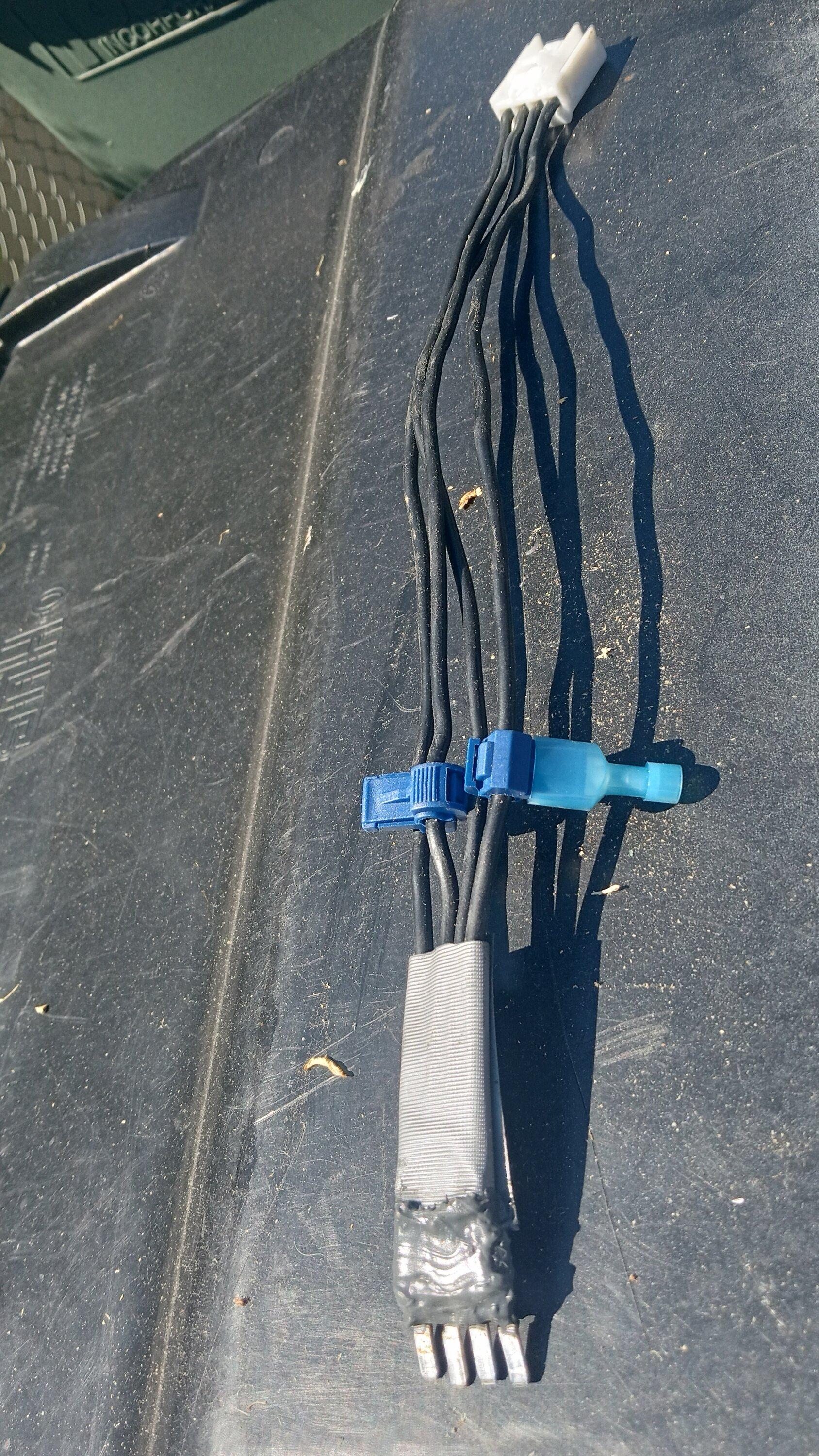

To get the brake pedal signal to the Curt controller I made a jumper to tap into the brake pedal switch without having to splice into factory wiring.
This enabled me to use the output brake pedal switch signal pin 4 to supply the brake signal to the Curt brake controller. (see photo of jumper)
The jumper was a brake switch pigtail connector for the brake switch, and I added the male end by using 4 micro 2 fuse tabs (legs) to make the mating pins. The brake switch is the male end and micro 2 fuse legs are the same dimensions. I soldered the pig tail wires to them. I made a rigid connector using JB weld (non-conductive to hold the pins in place as a connector). I could not find anything online to get a mating male plug for the brake switch connection wiring so had to make my own.
Picture of the connector jumper attached. The splicing tap was done on the jumper so as not to risk any possible damage to the factory wiring of the brake pedal switch.

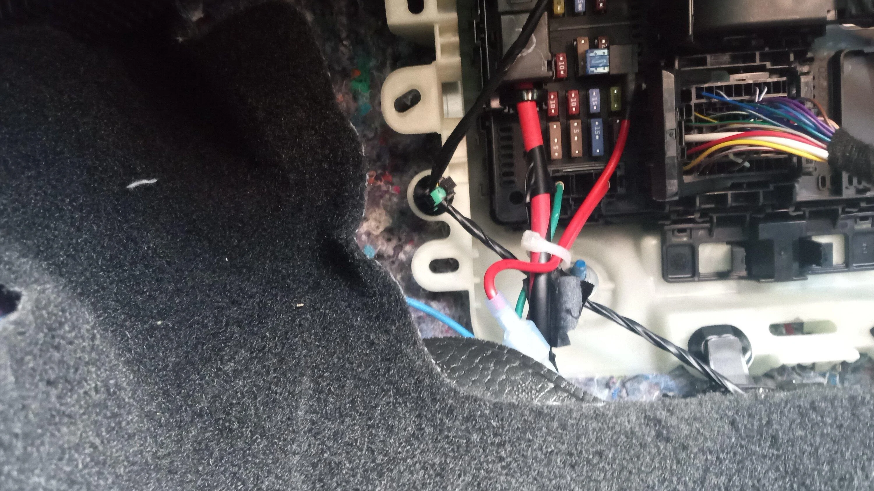

I used the spare fuse panel slot 24 (fused for 20 amps) on the passenger compartment floor and added a fuse tap and fused it with 15-amp fuse to power the Curt Discovery Brake controller. This supplies my Curt brake controller power.
I used the factory supplied flex bed connector with its 20-amp circuit to power the trailer 7 pin auxiliary 12 volts for charging the trailer battery (pin 4 of 7 pin connector). This makes it a separate circuit and eliminates the need to splice into any factory wiring.to the rear bumper area to connect the brake output signal wire from the curt controller and the other wire from chassis ground near the rear bumper to supply the ground for the brake controller and the ground for the indicator lamp on the trailer brake controller power switch.
I am including a wiring diagram I made of the circuit.
Also, I am including a picture of the 7 pin and 4 pin connectors mounted on the truck.
Hope this long-winded explanation is of some help to those wanting to add a brake controller to the Mav.

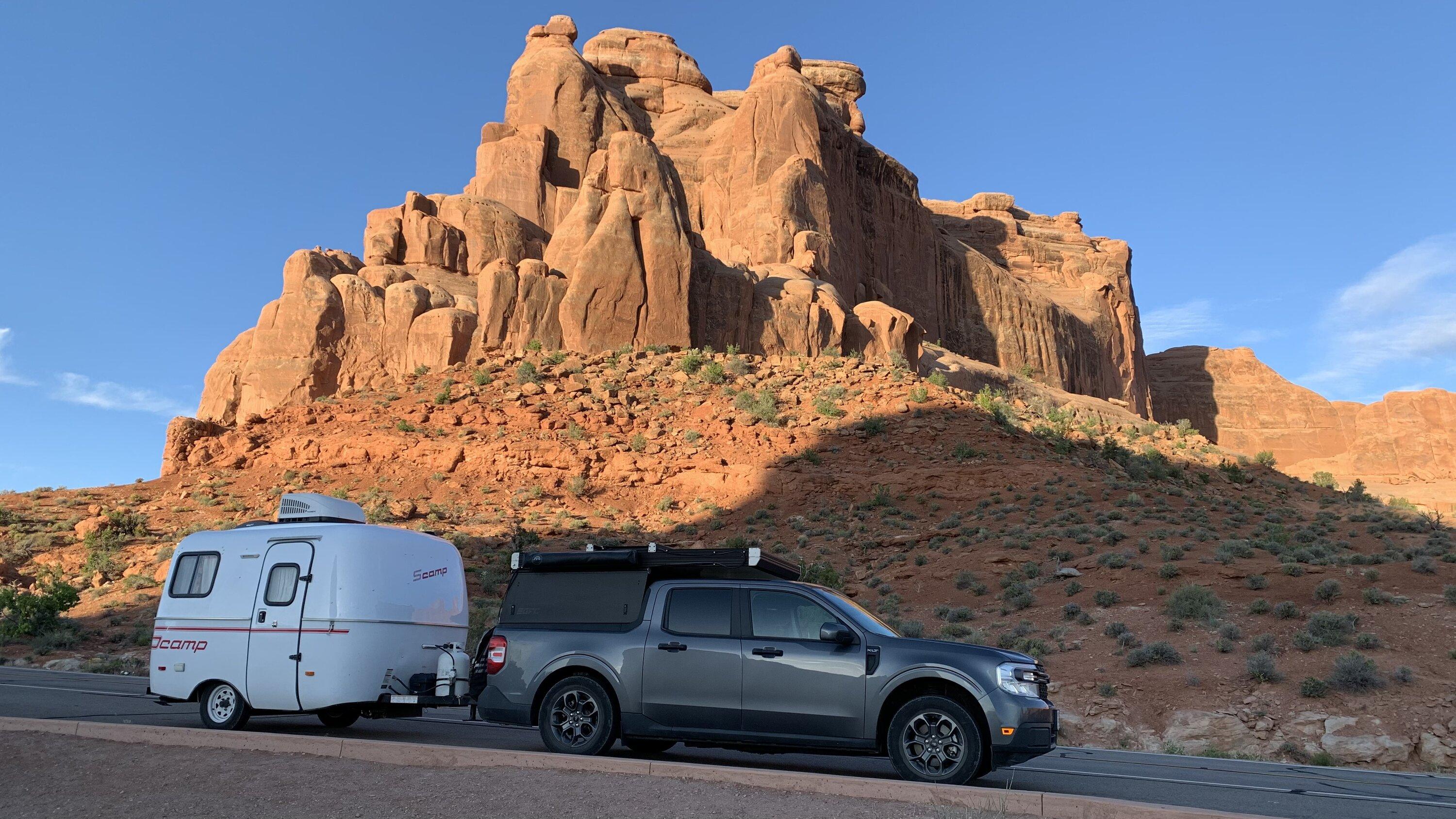

Been towing my Scamp 13ft with zero problem fulltime for a couple months now. Barely know its there (other than MPG dropping to about 25-26 mpg).
My trailer weighs about 1550 lbs when empty. But I usually have the water tank filled and a bunch of stuff in there. So probably closer to 1700 lbs.
i also cary 20 gallons of water and gas in the trunk. Plus a gfc camper on top.
I do not have extra passengers though. Just me.
It seems to have absolutely zero problems with my setup.

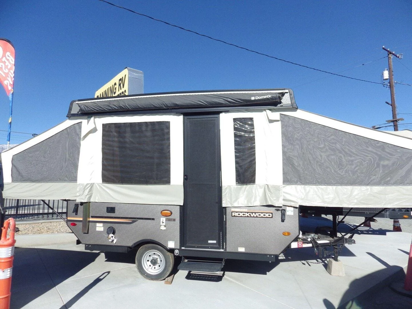

Just purchased a 2020 Rockwood Freedom 1950. Picking it up this weekend with my 2023 Maverick Hybrid and really excited. Getting a 4 to 7 pin converter and electric brake controller installed. Should be a great set up.
We did same
I got u haul do do connector and they got me into a blue tooth brake control
So far great
Made it from ca to New Hampshire
Then taking a month to go back
