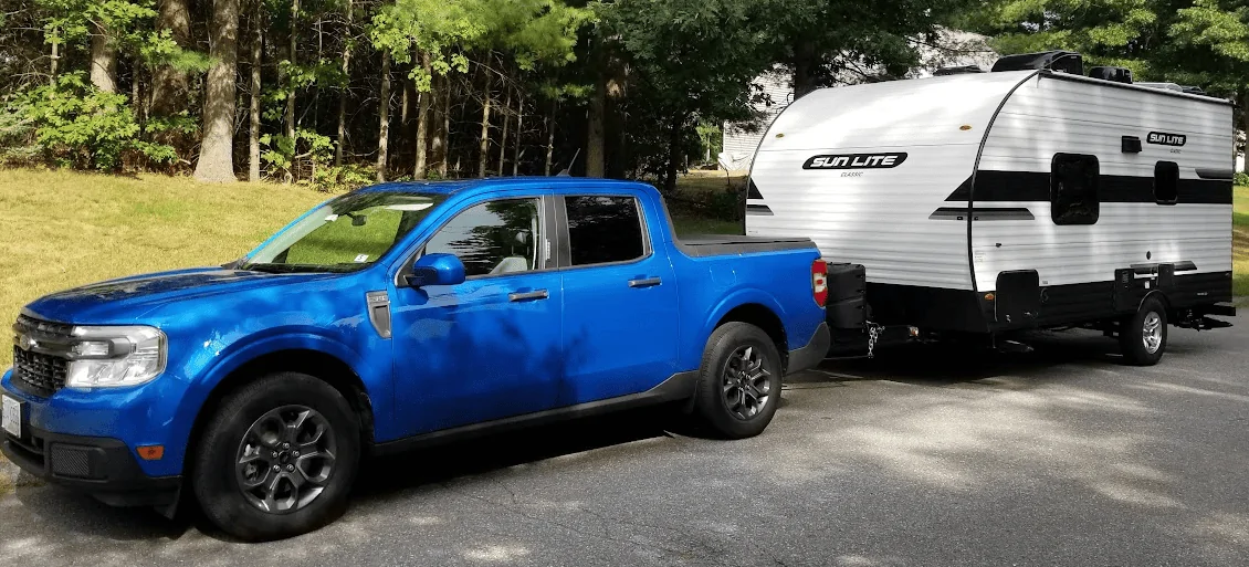

2024 Ford Maverick
I just purchased a nice little camper trailer - a Sun Lite 18RD
This is 19 foot tip to tail.
I do have the 4k towing package, in fact I switched my buy from the hybrid because we wanted a trailer and nothing I wanted really fit well (with towing headroom) in 2k.
Lately I have been hitting around 29 mpg without the trailer - keep that number in mind....
The "dry" weight of this trailer is 2900 lb (dealer est), and GVW (which I doubt I could hit) is 4k. The difference for those that don't know is that dry is "empty" - no propane (2x20lb), water (25 gal * 8lb ~= 200lb), kettles, camp chairs, beer in the fridge...
I did have propane but the rest was empty.
Tongue weight is said to be 270lb.
I did have a load balancing, sway control hitch for the initial haul. Turned on Trailer mode as well.
With the trailer and mostly highway for a 2 hour drive home, looks like about 14 mpg which is close to what I was hoping for. With the trailer brake gain dialed in (7.0) , I had a pretty decent ride. Never felt like the trailer was pushing me when stopping. A touch of porpoising but no more than I expected when you have 3k waggling your hitch ball :cool: Overall - I was pleased with the towing performance. In particular - just for fun I hit the gas a few times just to see how much acceleration I had left, and felt it was plenty. Note: the words of wisdom is that 65 mph is a good cap when towing - so that is what I did on the highway.
This Sun Lite is aerodynamic than the sweet trailer I have on order.... (due March of 2024... a Safari Condo Alto F2114) so it will be interesting to see what if any gain I get when that arrives. And I would really be interested if someone gets the retractable roof version the R1723 - which we really think is amazing, but we wanted more storage and fridge.
So - why this Sun Lite trailer ?
  • I did not want an east/west bed as that means someone is always crawling over someone to get in/out of bed. This has a camper queen with space on either side to get out.
  • Big fridge/freezer
  • enough space for 2 adults and a dog to move around 🐶
  • separate dinette (many smaller campers your dinette may be part of your bed.)
  • good price, nice build quality - for my short term camper.
  • huge amount of storage - though that can lead to you overloading.....
  • weight. My goal was to leave head room in the towing, and a dry of 2900 means I have a chance to keep my towing weight to ~3600.
Hopefully I will get it out for a weekend trip in a few weeks :)
Here it is behind the Maverick

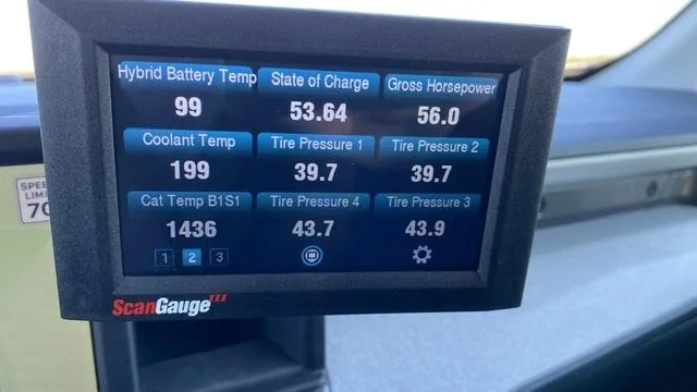

In my 25 years of towing, I've never had a problem with sway. And until now, all my trucks were old with no electronics. It may be my exact setup. It may be I put MAXIMUM allowed weight on the tow ball, not minimum.
When towing GET AN OBDII reader to display the truck's data while towing.
For under $300 you can see EXACT water temperate, oil temperature, transmission temperature, exhaust temperature, engine load, torque, horsepower being generated and much more.
If you see ANYTHING getting into a caution zone, just slow down by 5 or 10
mph until everything turns green again.
Best thing you can add to ANY tow package.
Now, go get your dream trailer!
example from mine:

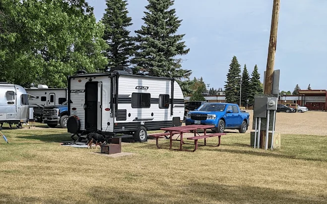

Just an update. We pulled this trailer for ~4000 miles on a trip to/from New Hampshire and North Dakota. We took the trans Canada for a good part of the route out and tried to stay off the interstate on the way back.
MPG ranged from about 10 to 15 depending on conditions (the 10 was a hot head windy day).
Over all the tow was fine with the Maverick. Never felt I needed more power or anything like that. We triggered sway controll twice so know that works :)
We learned to ignore the estimated times on Google maps. And to some extent the route suggestions. Given the tires we have are rated for 60 mph, we are not going to be going highway speeds (and really I don;t want gallons per mile instead of mpg so 60 max is a good limit). We learned to pick a nice "direct" route, often not using the interstates and working with an estimate of about 50 miles per hours. So force the route I wanted in Maps, then divide by 50 for the time. (You force your route by picking a town or two along the desired route....) Driving US 24 below Chicago was delightful compared to the interstate - and avoiding the traffic around Chicago was fantastic.
Here is a picture of us at the Langdon, ND town

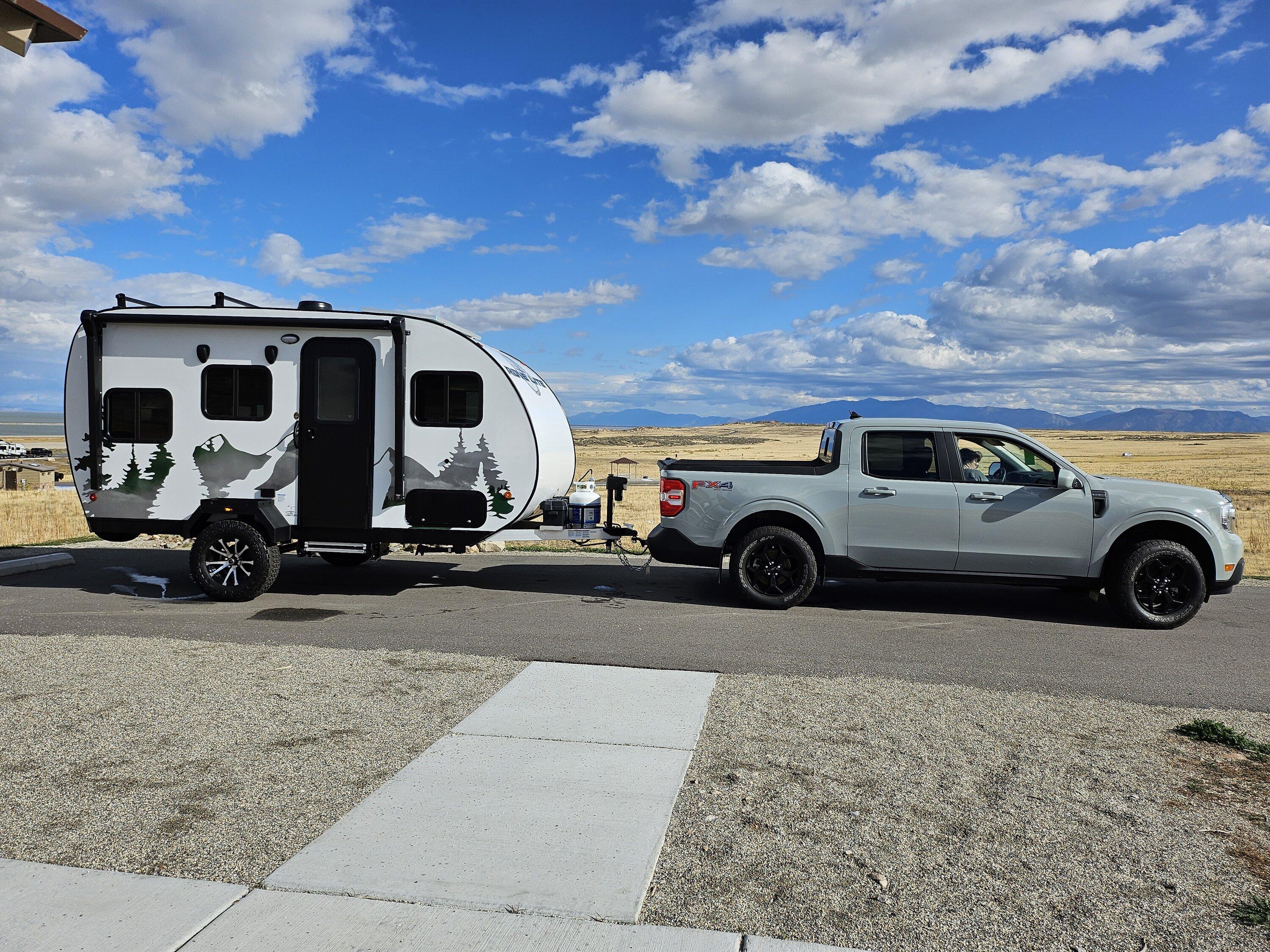

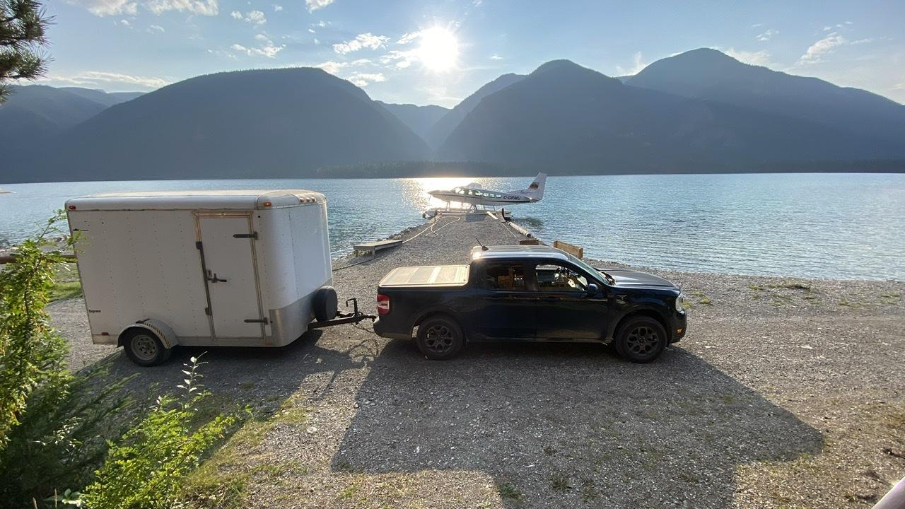

I also found it a comfortable sweet spot towing at 62 mph / 100 kph and net 18 mpg on all sorts of mountainous terrain in the western states, western Canada, and Alaska. It will get better than 20 mpg at 55 mph.
Have a side-by-side OHV inside.
About 3000 lbs.
7x12x9
Ford Maverick Towing a nice little camper trailer - Sun Lite 18RD E1F0DE9A-4EA8-4DFD-8D8C-9E644105F622
