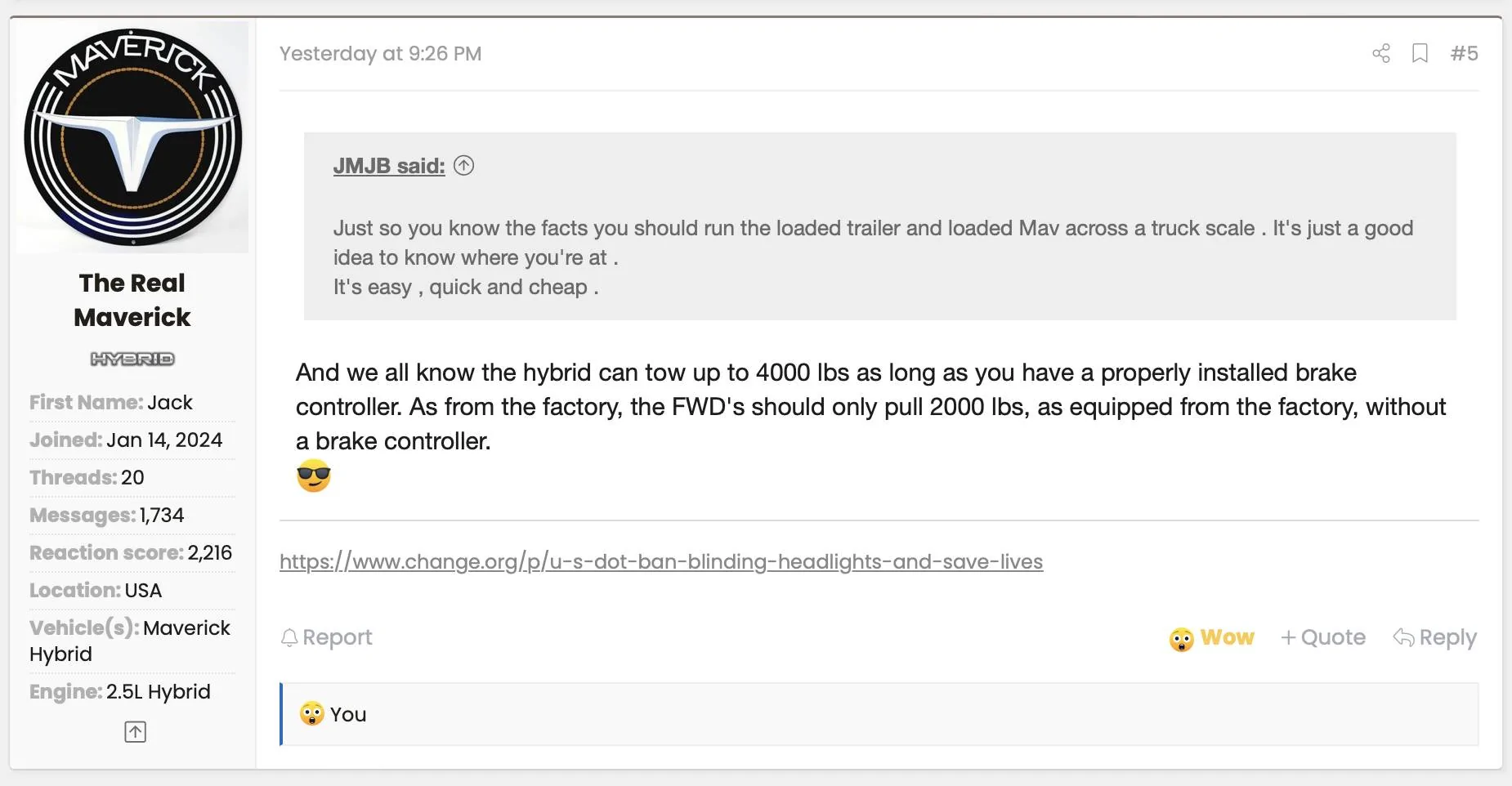

This is the post I am referring to. My question is can the transmission handle it without modifications.
Yes it can. In 99% of all conditions.
If you are in the 1%. If you are going to be absolutely brutal to your truck, like go up heavy grades every single day in summer.... don't do it.
If you fall into the 99% of customers, and are even a tad bit conservative, it will handle it with flying colors.
Do not sustain greater than 50% power output. But try it. You'll be surprised that unless you are on the Ike Gauntlet, 8 miles of 6% and 7% at 10,000 feet elevation, you won't need to.

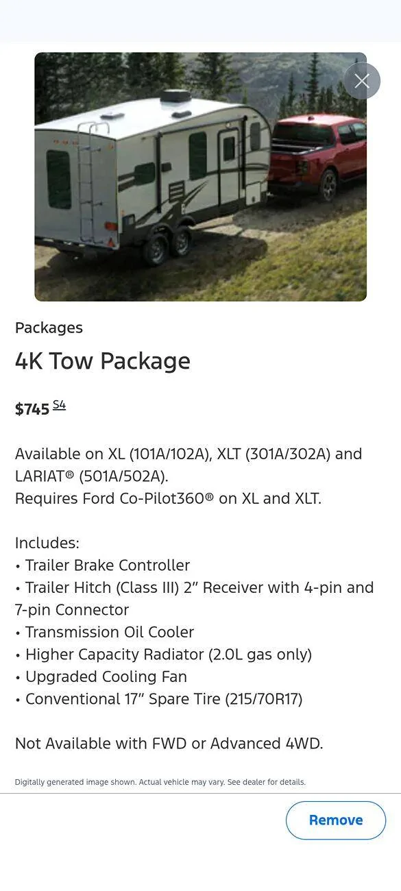

That's not true. The 25 ECVT was beefed up. Also you need AWD and the 4k tow package has an upgraded fan, transmission oil cooler, conventional spare and requires 360 co-pilot besides the 7 pin wire harness and the brake controller. Some like the co-pilot 360 and spare are safety
I want to know which trailer that is that has pop outs, dual axles, walk-on roof and still is under 4000lbs...
That's the secret 2028 Maverick hybrid they are testing that can tow 6,000lbs :D.
You can almost guarantee the redesigned Maverick will be able to tow 5,000lbs with a 500lb tongue weight limit to match the Hyundai Santa Cruz.
I have to wonder if that is Photoshopped/AI, look how far back the tandem axles are,,,,,,
