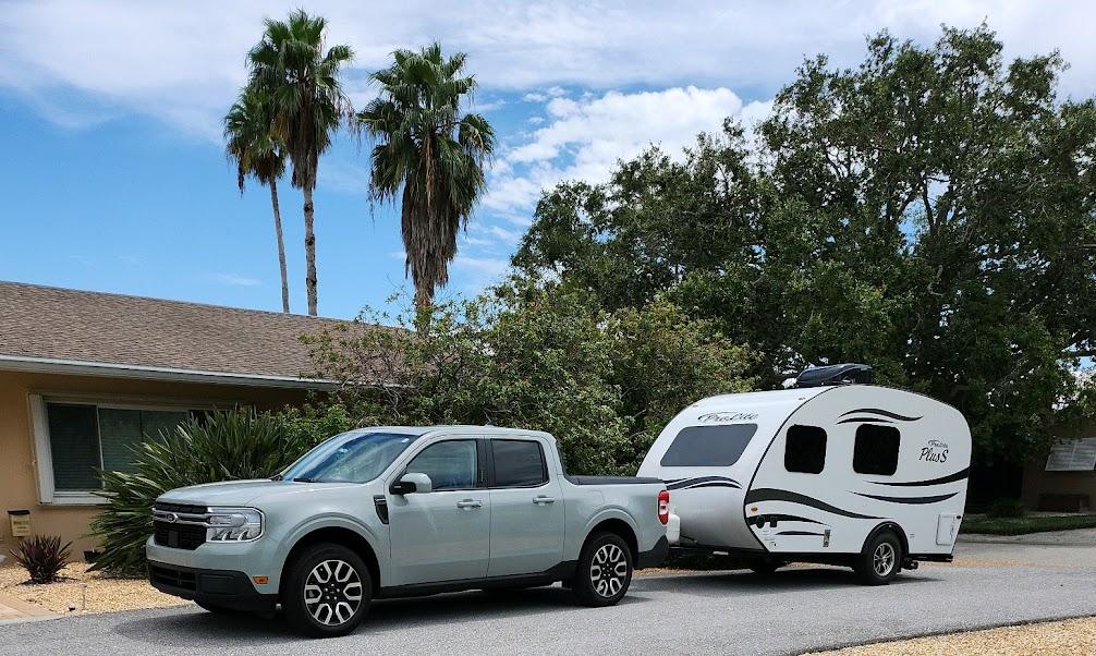

We just bought the Prolite S Plus & towed it from Adamsburg, PA to St. Pete FL! No problems! Of course the gas mileage was lower, but nothing we didn't expect.
Looks like a good choice. But internet says you spelled it wrong. 😎
Show some photos behind the Mav!
Keep the power gauge 50% or less on long sustained hills and nothing will overheat. It can do it!

LOL! Yes, I got it backwards! Prolite Plus S! We kept it under 50% or under. I was nervous at first, but it towed like a dream!

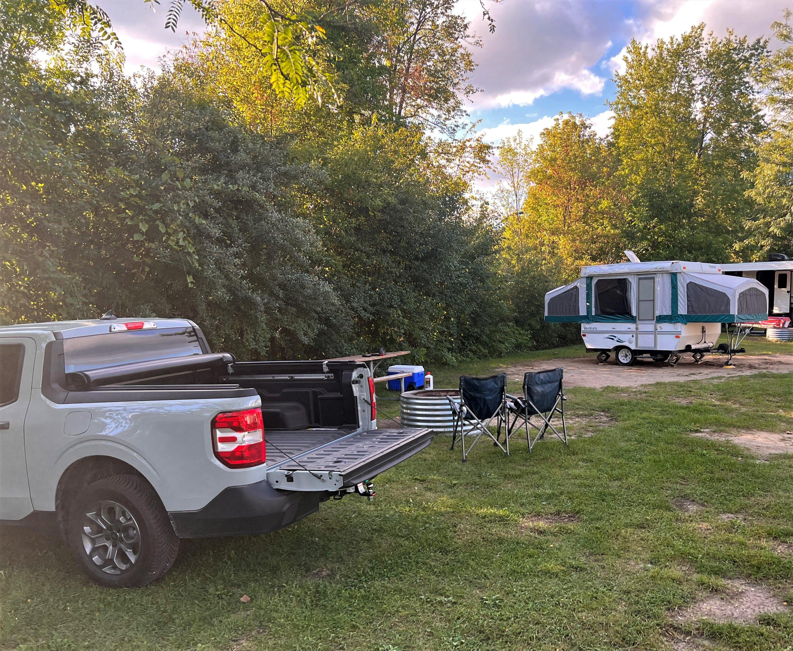

I just got a used Venture popup. It is only about 1200 to 1300 pounds. It towed fine, but I wouldn't want to go much higher than that.
