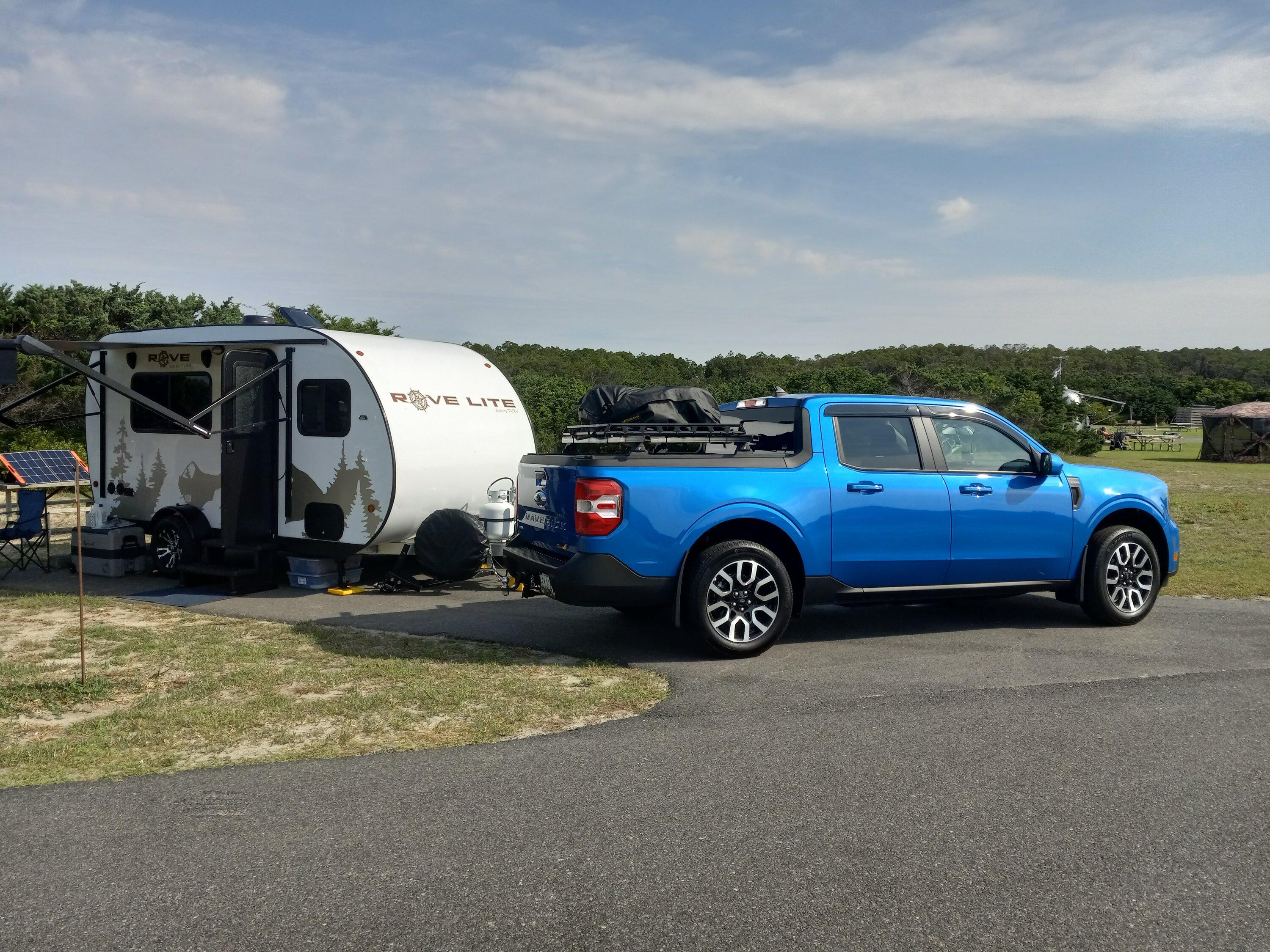

@BradGroux - Sounds like you have a solid plan. My truckbed does double-duty. I installed a ReTrax tonneau cover that supports a basket carrier atop it. I keep my camping supplies beneath and soft luggage atop the carrier. Definitely gotta be strategic and efficient about loading both levels with each trip.
That’s a great looking setup! The Rove Lite is definitely in my top 3 trailers right now. Because it is so affordable if nothing else, I could gut it and set up the interior like I like.
