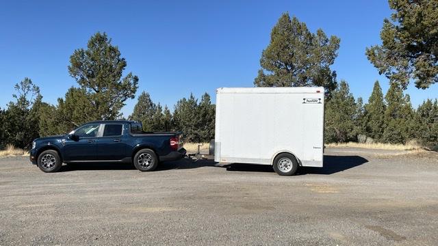

I pulled this:
(with 25 years of experience and 50,000 miles of towing, non commercial - this may be a bit ambitious for the newbie)
If you are new to towing, my #1 advice is SLOW DOWN. GRADUALLY add speed after you have 500-5,000 miles of practice, not 5 minutes of practice. The common thread you will see below, is my moderate speeds even as a highly experienced tower.

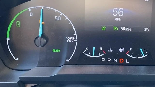

While on flat roads, it only needed about 20% power output.

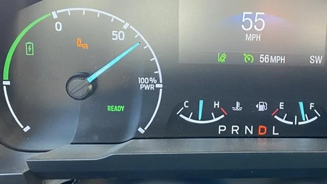

On 4% to 5% grade it took about 50%.

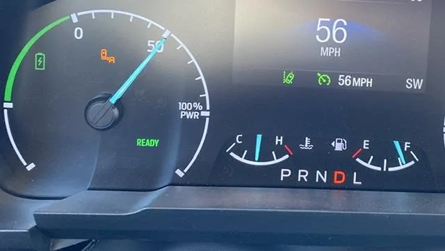

On a 6% grade, a bit more as expected.

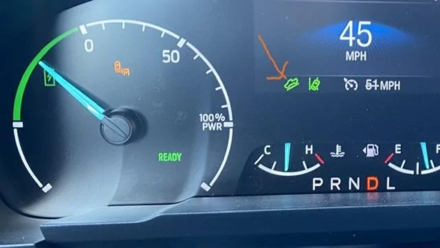

Now next it gets interesting and this may include never before published information.
The Green part of the power gauge is not only for regeneration, re-charging of the battery. The green gauge also indicates the amount of engine braking! In fact, when the HV battery is "full" this green part of the gauge is entirely dedicated to engine braking.
In the following photo, notice downhill assist is active and the needle is mid-way into the green area.
Ford Maverick Anyone towing a camper with Hybrid Mavierck? 71EAB1FA-6F17-4C2D-B739-83C0397EAE8A
At the same time I was getting zero regen brake; zero recharging; because my battery was "full". At no time during any of my trips, no matter how long the downslope was, the battery NEVER went above 72% charge, as I have digital read-out for the battery.

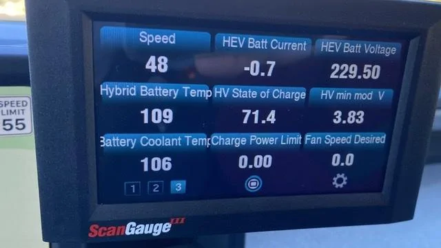

Ford Maverick Anyone towing a camper with Hybrid Mavierck? 08F3E70A-78D0-4FFA-A6D1-FCE6FA69CC49
Note: Charge Power Limit 0.00
This means zero regen allowed.
Note: HEV Batt Current: -0.7 amps. NIL
Note: HV State of Charge: 71.4%
Note: Battery Coolant Temp: 106
I have noted there is no active battery cooling until the battery exceeds 106 deg. This 106 must be a "safe" nominal temperature.
Zero Charge. Zero amps coming in or out of the HV battery. Needle 50% in the green shows 50% of the available engine braking being utilized at this moment. At higher speeds, on steeper grade, I did once see the needle hit the peg, go horizontal to the left. At this point, time to consider using friction brakes and trailer brakes.
I am curious about your ScanGuage. I just looked it up and it’s very interesting in what all it can do. I read somewhere on the forum that devices like these, you have to unplug when shutting down otherwise they can drain the battery. Does this on stay on drawing power when you have the vehicle off? Thanks for the posting.
