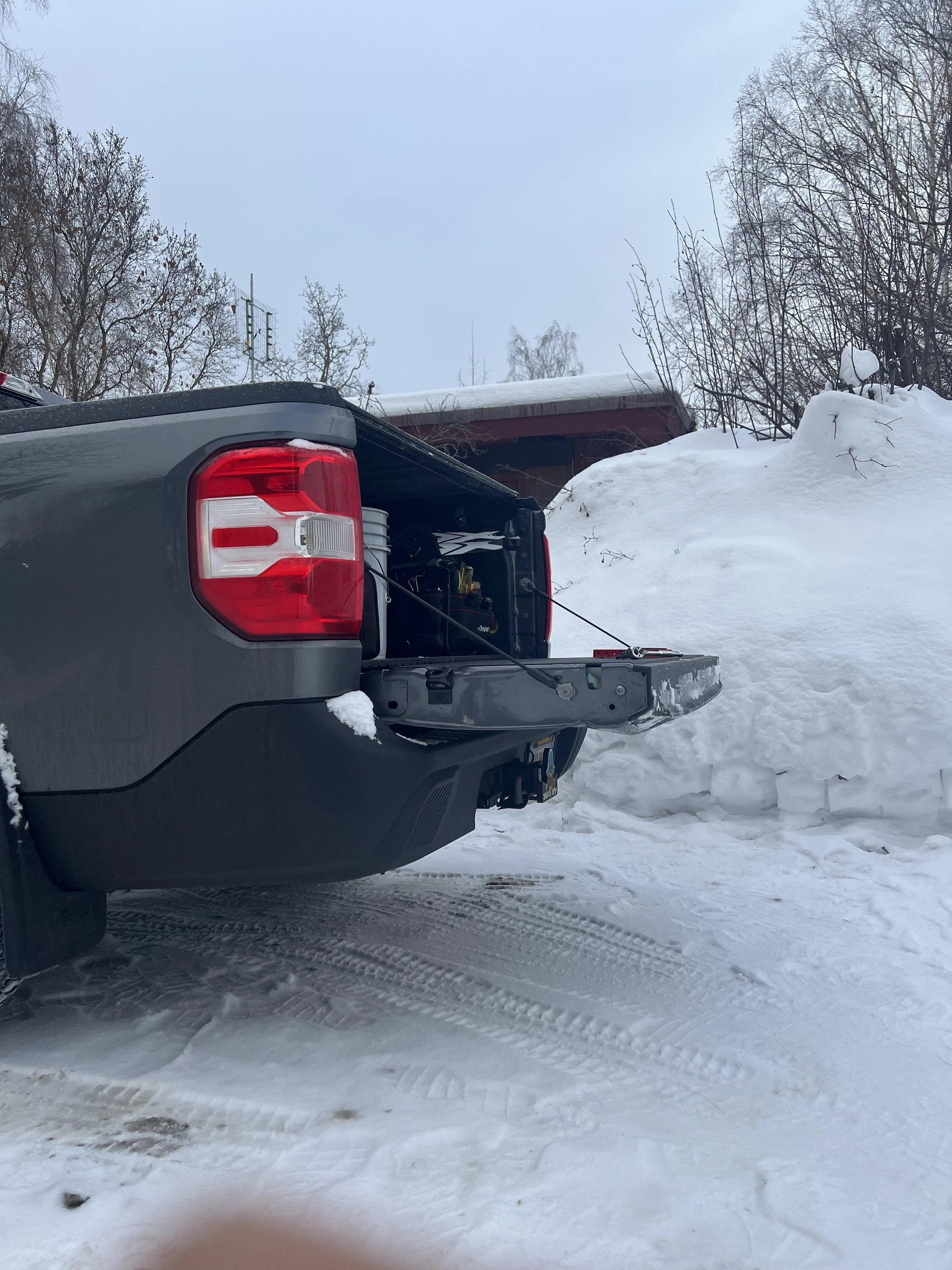

Unless I've missed a thread or two somewhere, Ford has still not acknowledged anywhere that all of the Mavericks have the wrong length of tailgate cable. Ford simply needs to provide a shorter cable and all the Mavericks would have beds that are coplanar to the tailgate as expected. I bet we'll never see it addressed by Ford but maybe an aftermarket cable will be sold by some company for a decent price. I'm curious if the 2023 models will be the same or not.

Could you take a picture of the bed and tailgate with a level or some flat object to show it being coplanar, for science? Do you have the tailgate assist installed?

The tailgate is supposed to sit level and not follow rake of truck. That way crockpots and coffee pots sit level.
Yeah I better see a level and some pics- Thx Management

Yeah I might have to just take the strut off. I mean not only not level but looks like a Mexican dog chewed on it.

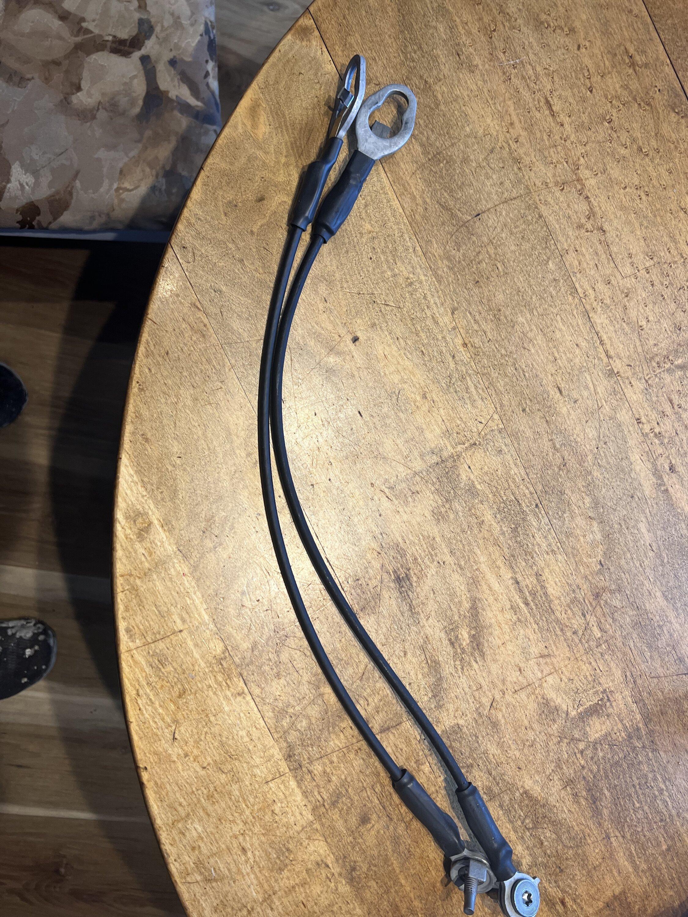

Interesting - I think a couple of folks have had luck correcting the droop with a new cable and or set - Not sure though
My XLT was delivered in June.One of the things that bothered me was the tailgate droop, looked to be an inch at least. Today I installed 2 new cables from Ford. I bought 'em. 30 bucks apiece. It solved the problem. The new cables look to be at least 1/2" shorter than the ones that came with the truck. The part #'s are NZ6Z6043052A (Right), and NZ6Z6043053A (Left). Also, unlike the old cables, they both are equally taut. #45 Torx fit well. The pic is of left side cables, new and old.
