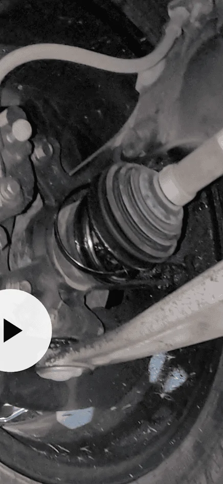

Just got a video multi-point inspection done at the dealer- R/Front shaft boot is toast- This must be pretty new as I did not notice anything 3 weeks ago- Rig has 19k Miles - Fun times, looks like they are replacing it under warranty. 1.5 Inch Lift/FX4 -
I have had mine replaced under warrantuy and now they are bad again and Ford won't do anything about it. They suck
