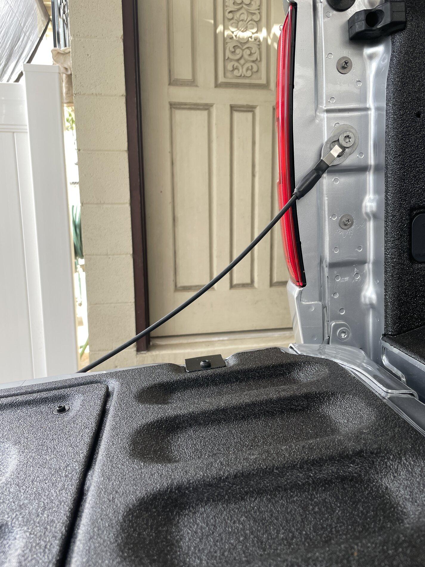

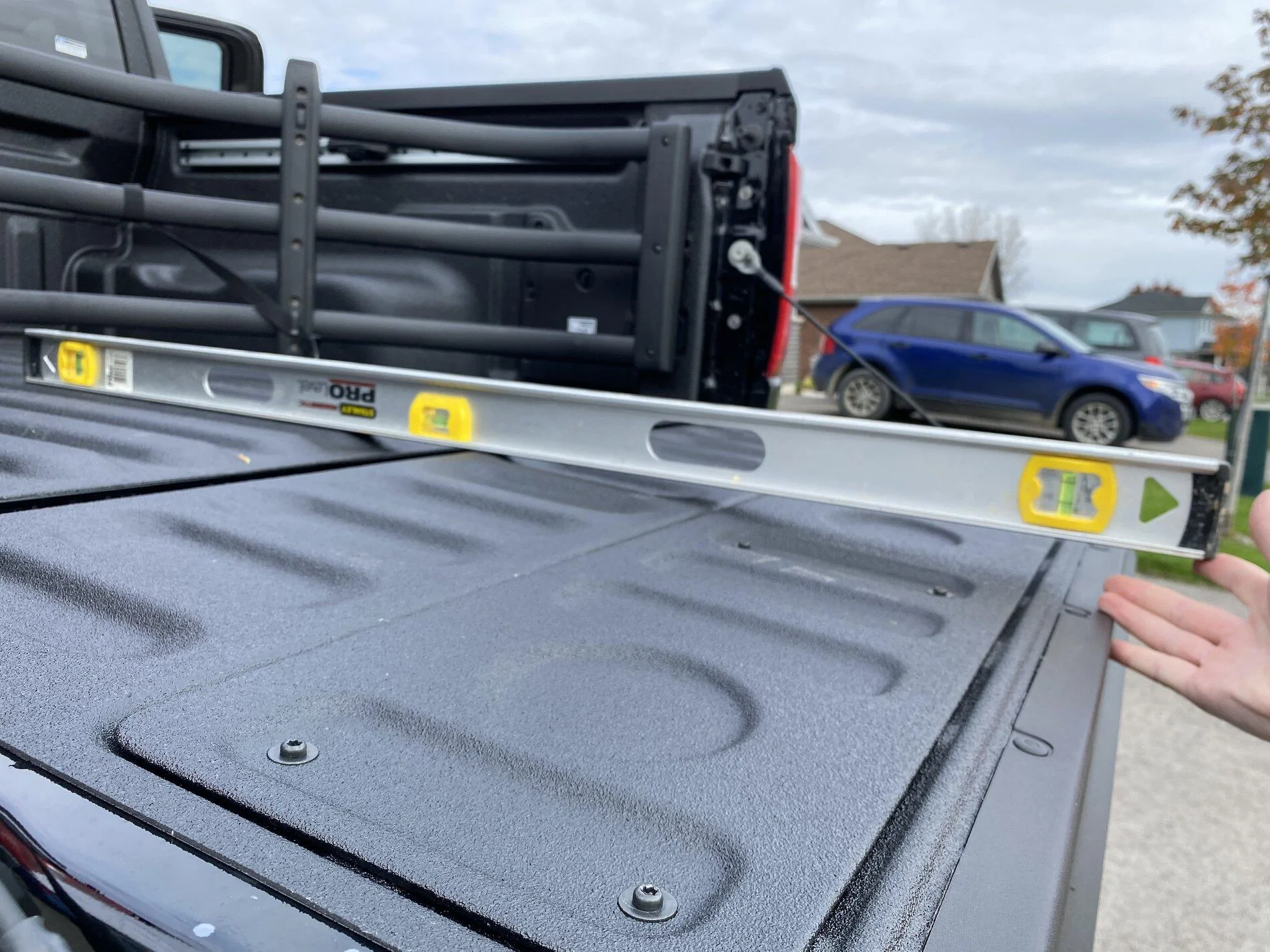

Just wondering, when your tailgate is down, is it level with the bed floor? Mine slopes downwards, trying to see if my cables are way too long, or if that’s by design
Ford Maverick Uneven tailgate cables F7D2CBB0-EFD7-4201-AB68-A4C9DD6A2FC6

My cables are also uneven and the tailgate slopes down. If I sit on the tailgate they both have tension and the gate does not touch the bumper so I guess it is ok.

put 500 lbs (which i think is max of tailgate in down position) on tailgate and the slack should disappear.

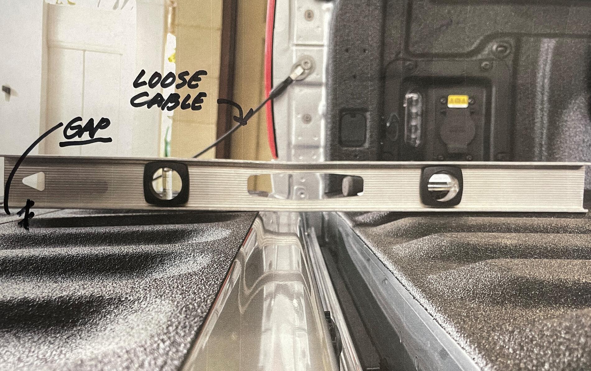

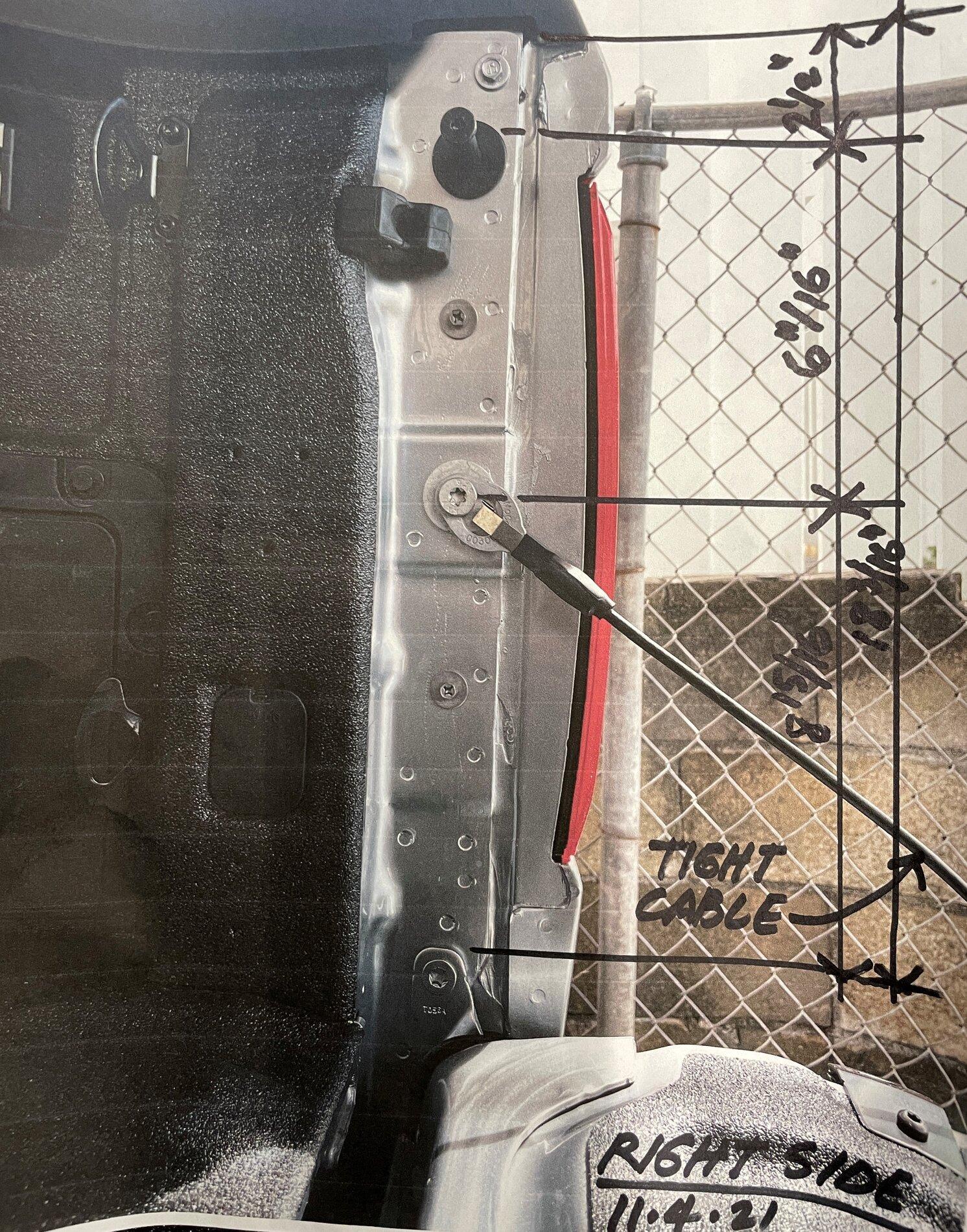

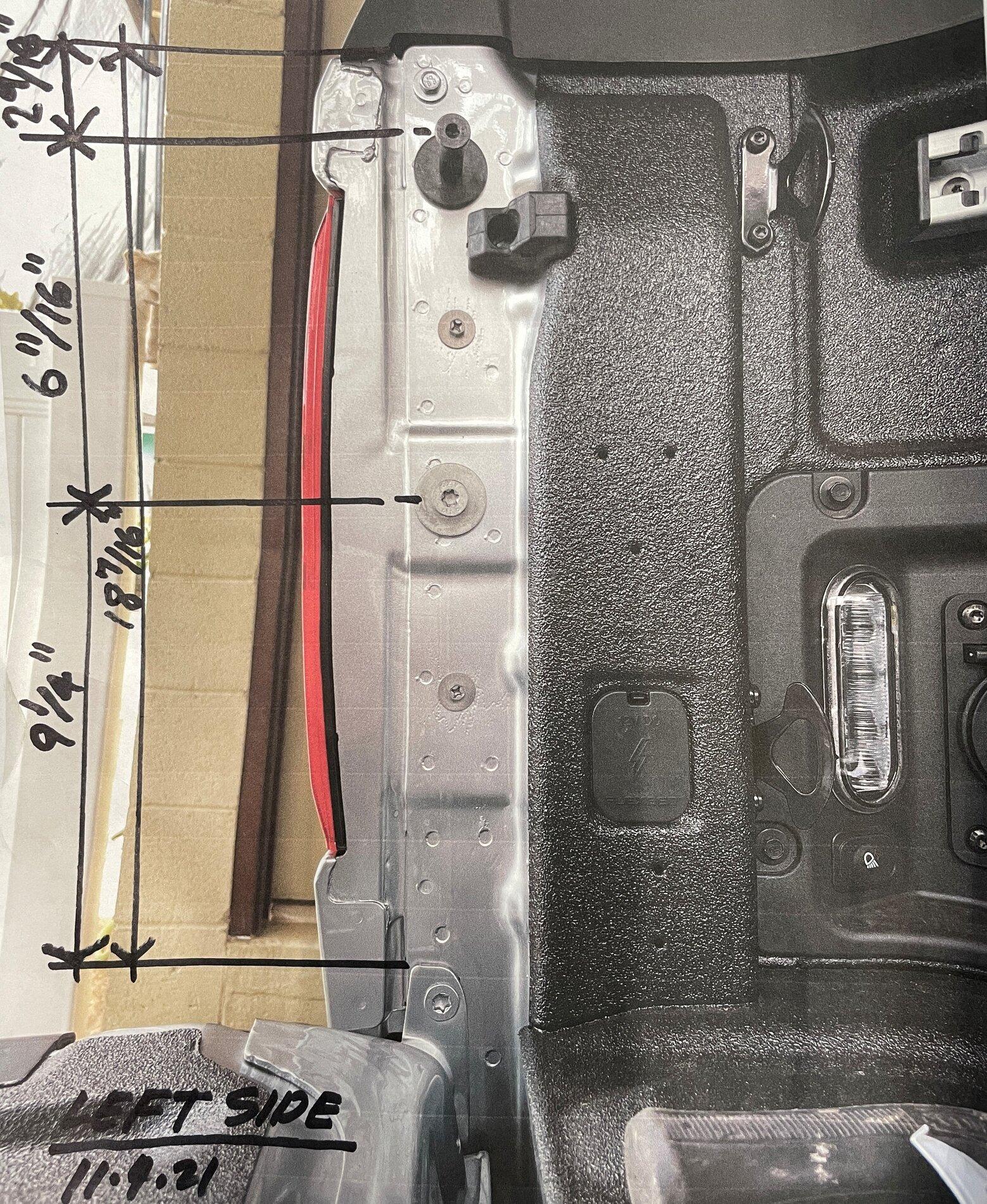

I just dropped off my truck to check this tailgate issue. Apparently, there is slack showing on the support cable on the left side. While the tailgate is closed, everything looks square and fit. However, upon measuring the primary cable posts to the hinge, it seems like the left side is spaced farther than the right side. So you'd think the left side would be tighter and the right side slacked. Also, the tailgate is not level to the bed of the truck. (See attached photos)
I don't believe it was "designed" this way since it would not make sense to unequally load the two cables, especially when placing a working load on it. I am hoping this is not a manufacturing issue. I've owned (and seen) many trucks in the past and never saw a slack in the tailgate cables.

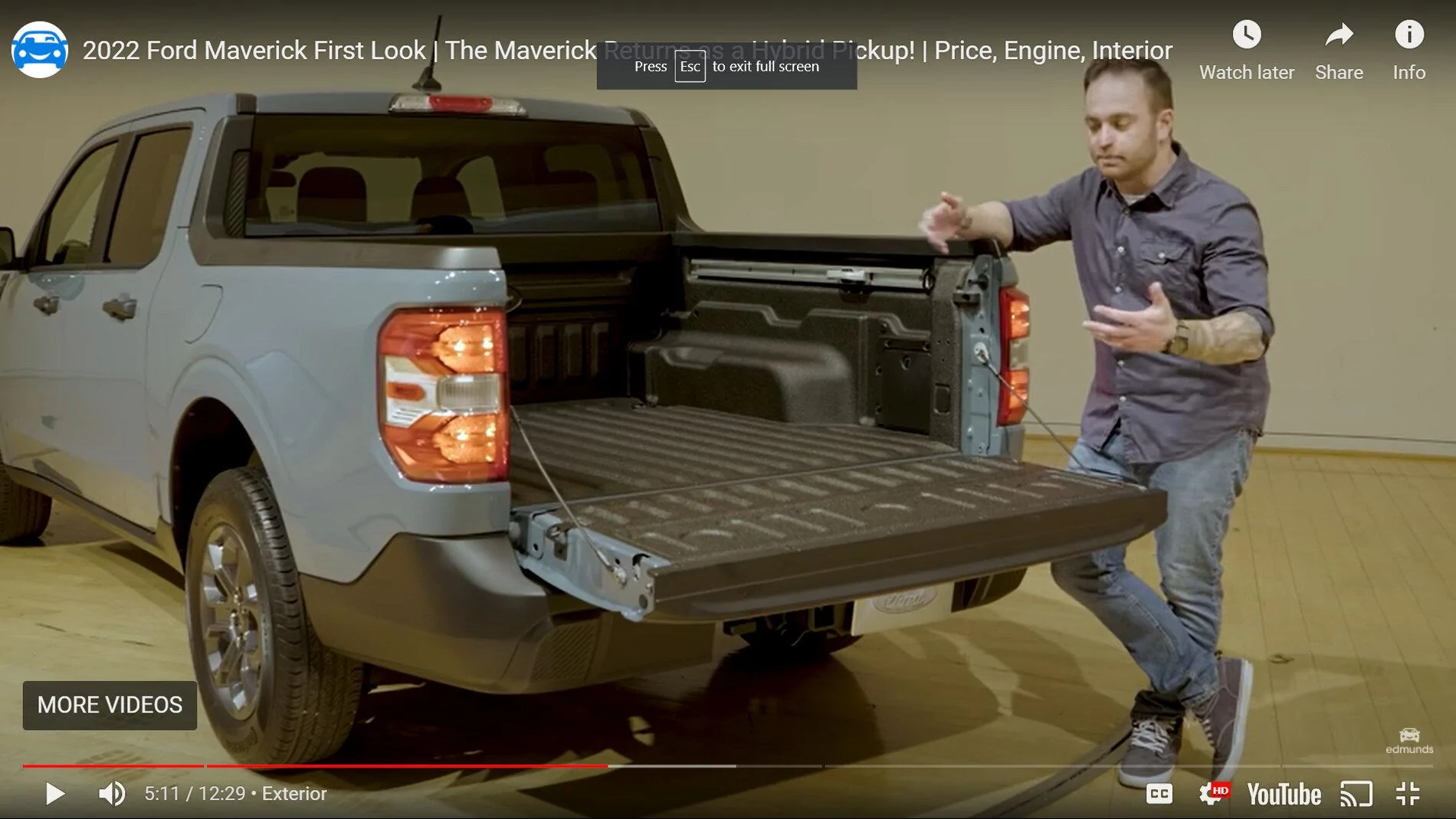

Just got a call from my local Ford Service Department and they confirmed with Ford Technical Support that it is normal. They checked it with three other Mavericks on site. I'm satisfied with that until such time that this becomes an issue with the function of the truck.
I've been screenshotting some photos from the web and seems like it's normal. See attached photos.
