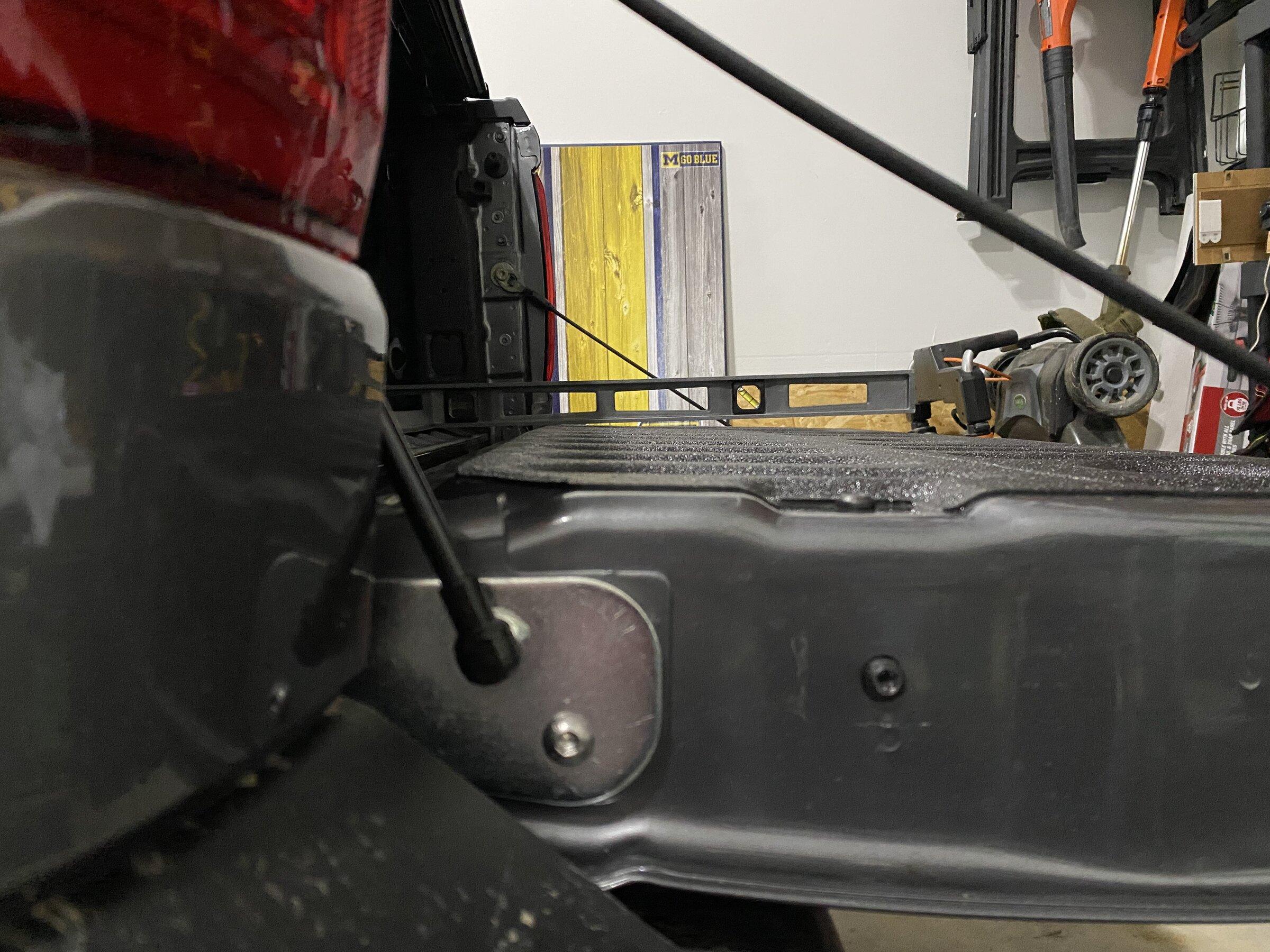

Just got my truck last night. Add my Mav to the list of tailgates that don’t drop even with the truck bed…🙄
