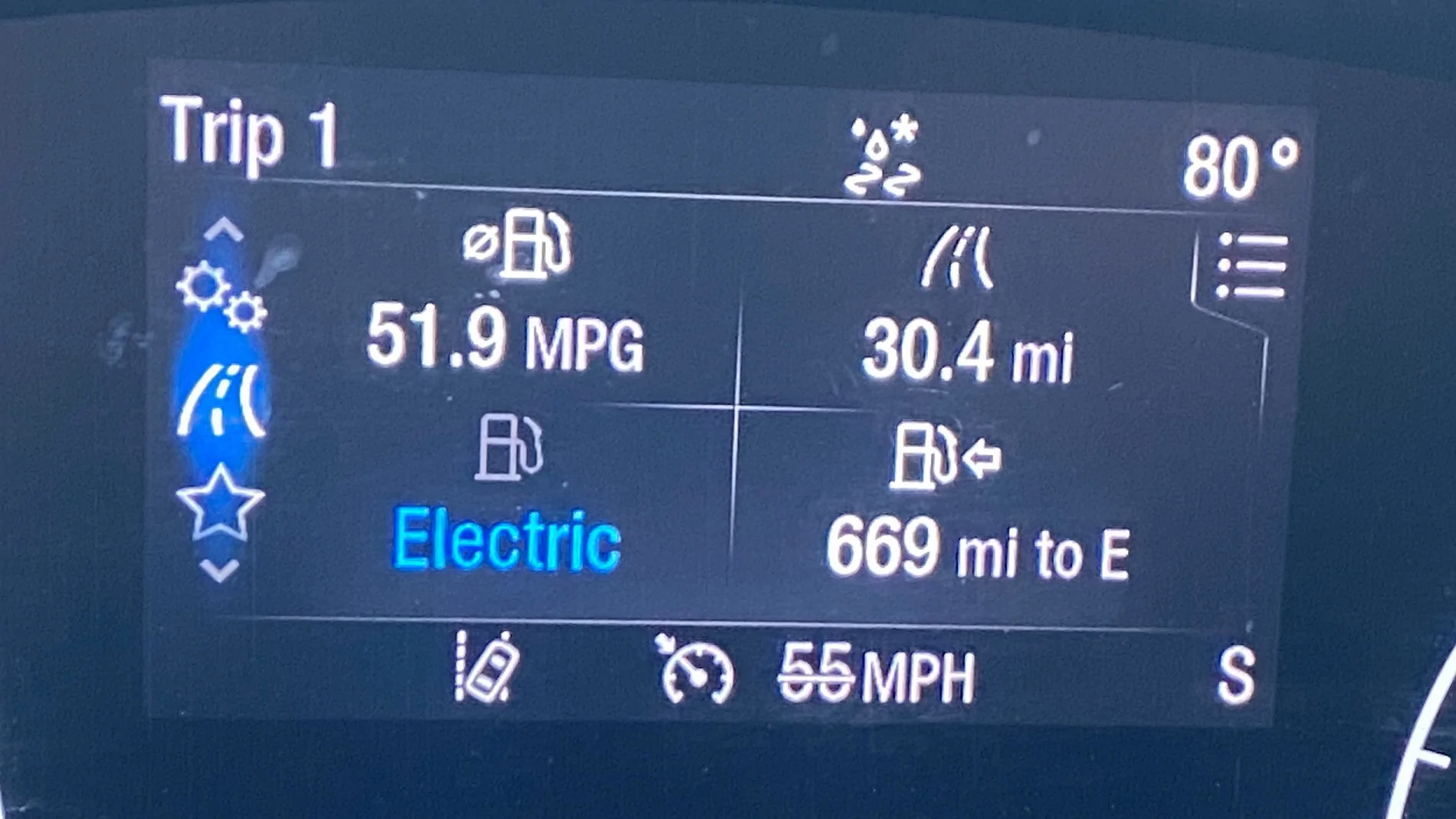

Drive more conservative- ie, don’t floor the gas when accelerating at green lights and don’t brake at the last moment but let the hybrid regenerative braking do its job. I have a little over 7000 miles and averaging 40 mpg for all those miles. I got 45.9 yesterday on my drive home
Ford Maverick Terrible gas mileage! IMG_7907

Most get better than the stated mileage, some getting a lot more. If you're not getting at least the stated mileage, then it's probably your aggressive driving and not the truck.
