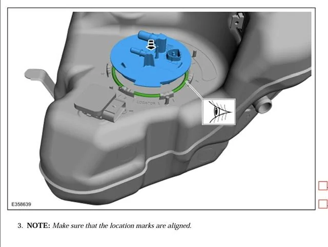

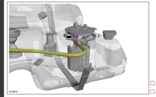

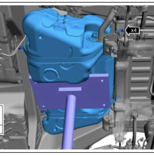

The pump is in a sump at the extreme lowest point in the tank.
Since every ounce of every gallon comes from the extreme bottom of the tank, there's really no place for sediments to accumulate. There are 5 filters before the fuel lines and injectors. Two filters before the pump, three filters integral inside the pump.
General arrangement diagrams follow for removal and repair.
Tank: shows deepest area, and area for fuel pump, nearest the camera. Shows a jack stand to aid during unbolting.
Ford Maverick 500 mile tank and real gas mileage 94FDB7C8-3F8E-4C3D-B466-7ED5DC081D27
Shows external view of fuel pump at lowest spot of molded tank.
Ford Maverick 500 mile tank and real gas mileage 5C2C2341-9AF0-4901-A4EA-05D02525EB60
Shows internal view of fuel pump inside the lowest spot of the tank
Ford Maverick 500 mile tank and real gas mileage 63B7FAA9-0F7A-44A6-B37E-DBEFE7999027
