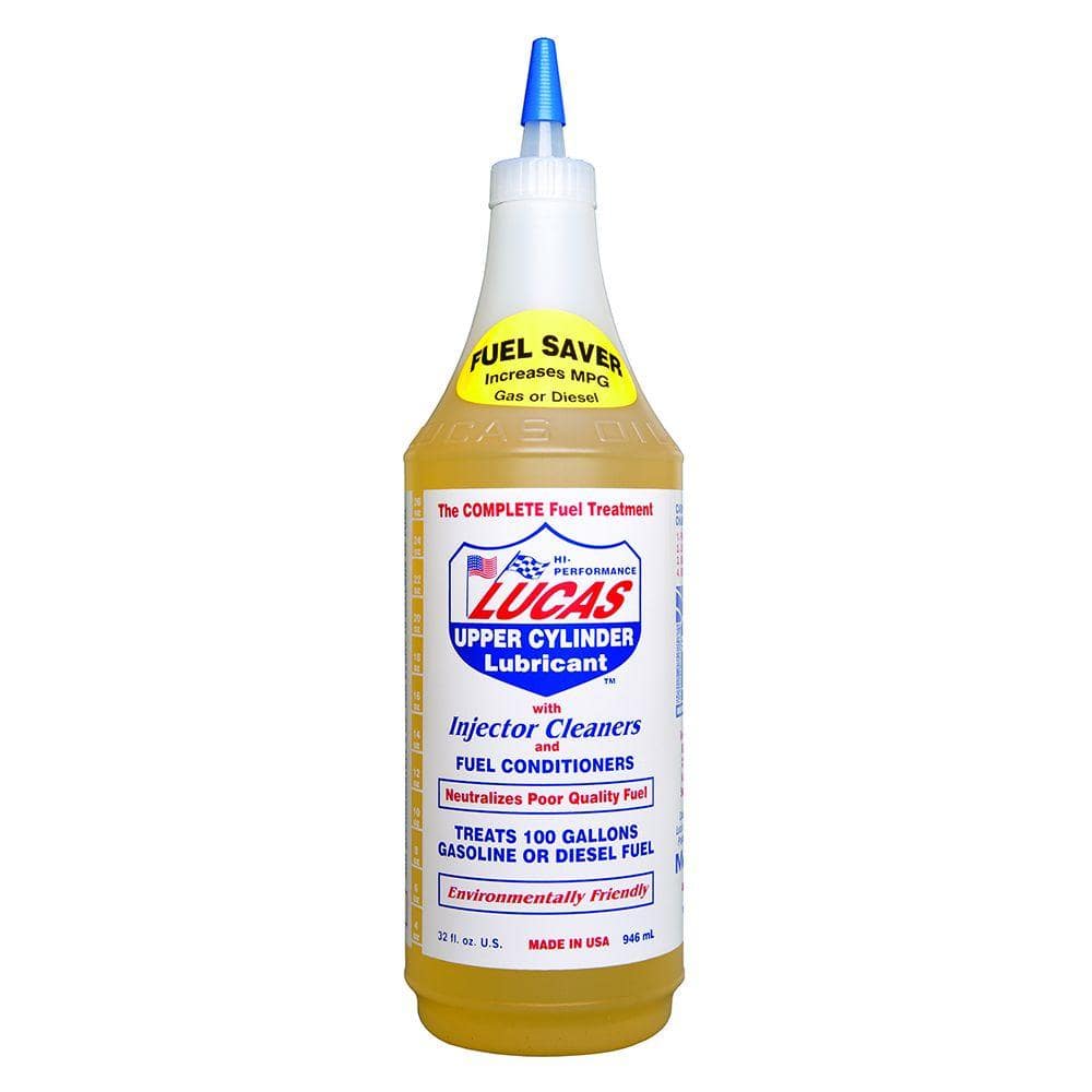

This is what I use in my "may contain up to 20% alcohol" gasoline in all my polaris, mowers, generators, etc. NEVER an issue even if I don't start something for several months. Fuel filters even are not even clogged by condensate which sometimes happens even with alcohol free gas. (About 1 1/2 oz per 5 gallons of gas).
