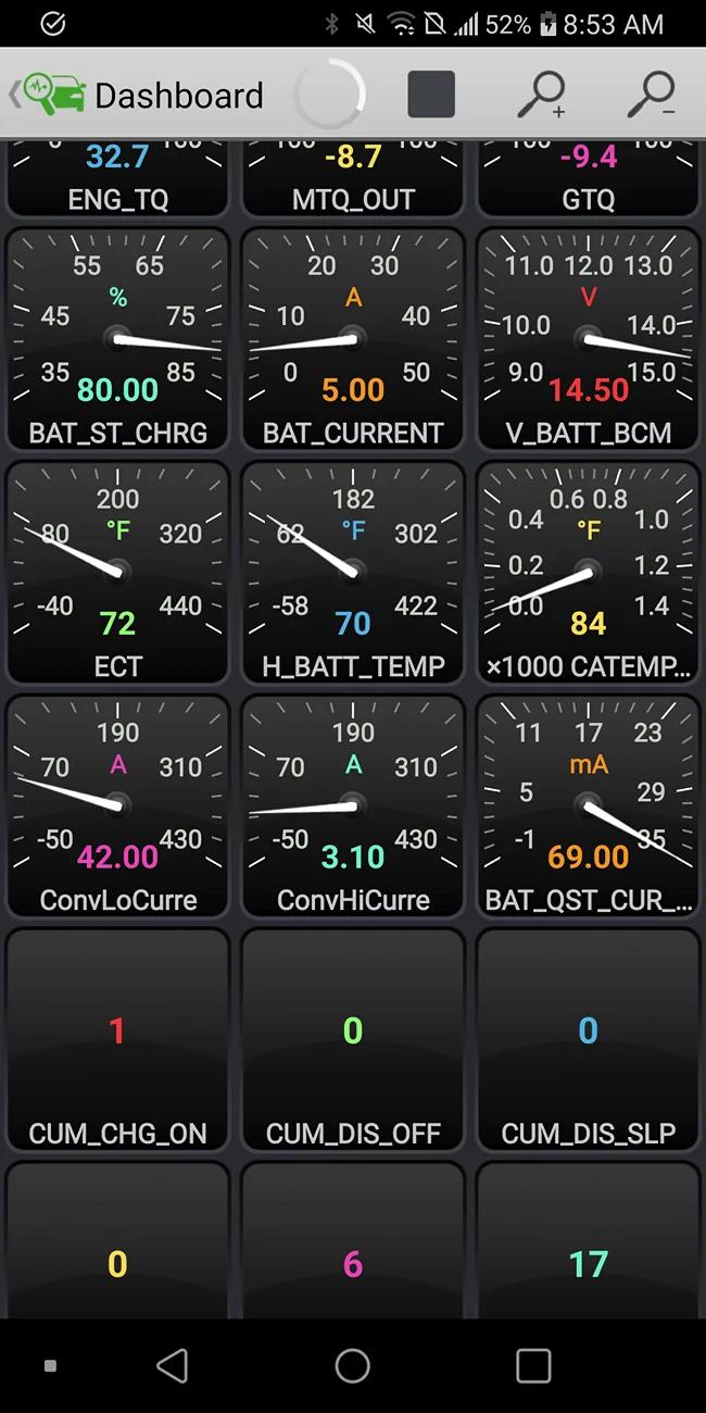

Here's temperature example pretty quickly after ICE turned on, due to coolant, HVB, and catalytic converter almost matching.
Ahhhhh - this was from the heady days of the battery being charged up fully.
Did I say days, I meant day. Ha!
To be fair - 6 days old, and still at 80% SOC (out of 85% full charge), but Amps was on it's way down to 1, pretty quickly after turning on.
