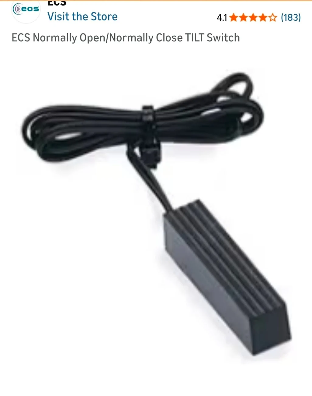

I used this that I stuck on the inside of the tailgate.

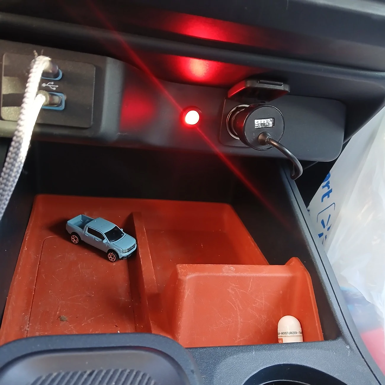

I then ran a cable to the inside and used an LED lamp that would light up when the tailgate is down.

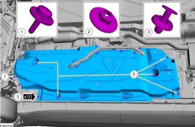

Do you mind sharing the path you followed to route the wire into the truck?

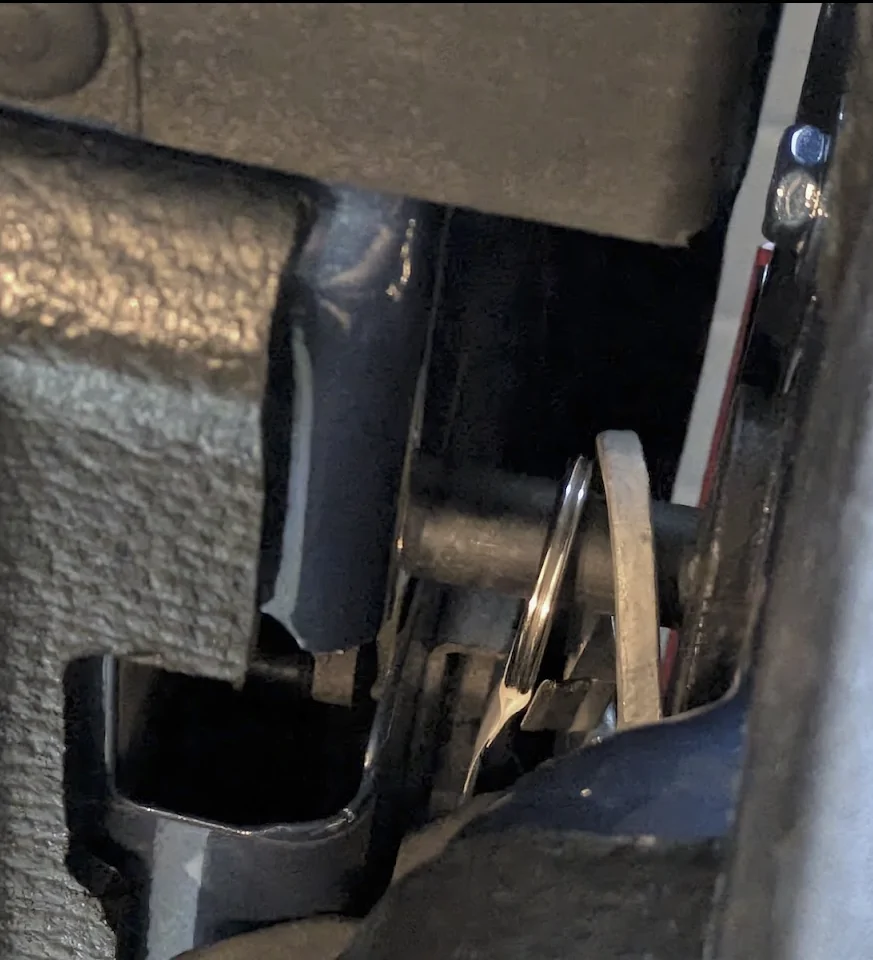

Sorry I'm just getting around to this.
Ford Maverick Tailgate Open Notification? 1000028569
I ran the cable under the truck after removing the HVB cover. There is an access hole down there that already has cable going into the battery compartment under the rear seat. You can't miss it.
