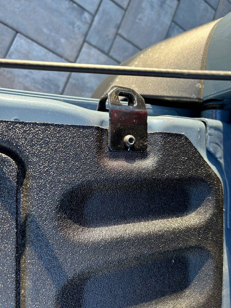

The pointy ones I got have two screws. I like the fold down idea though... if it will hold the weight. A single screw doesn't leave much redundancy.

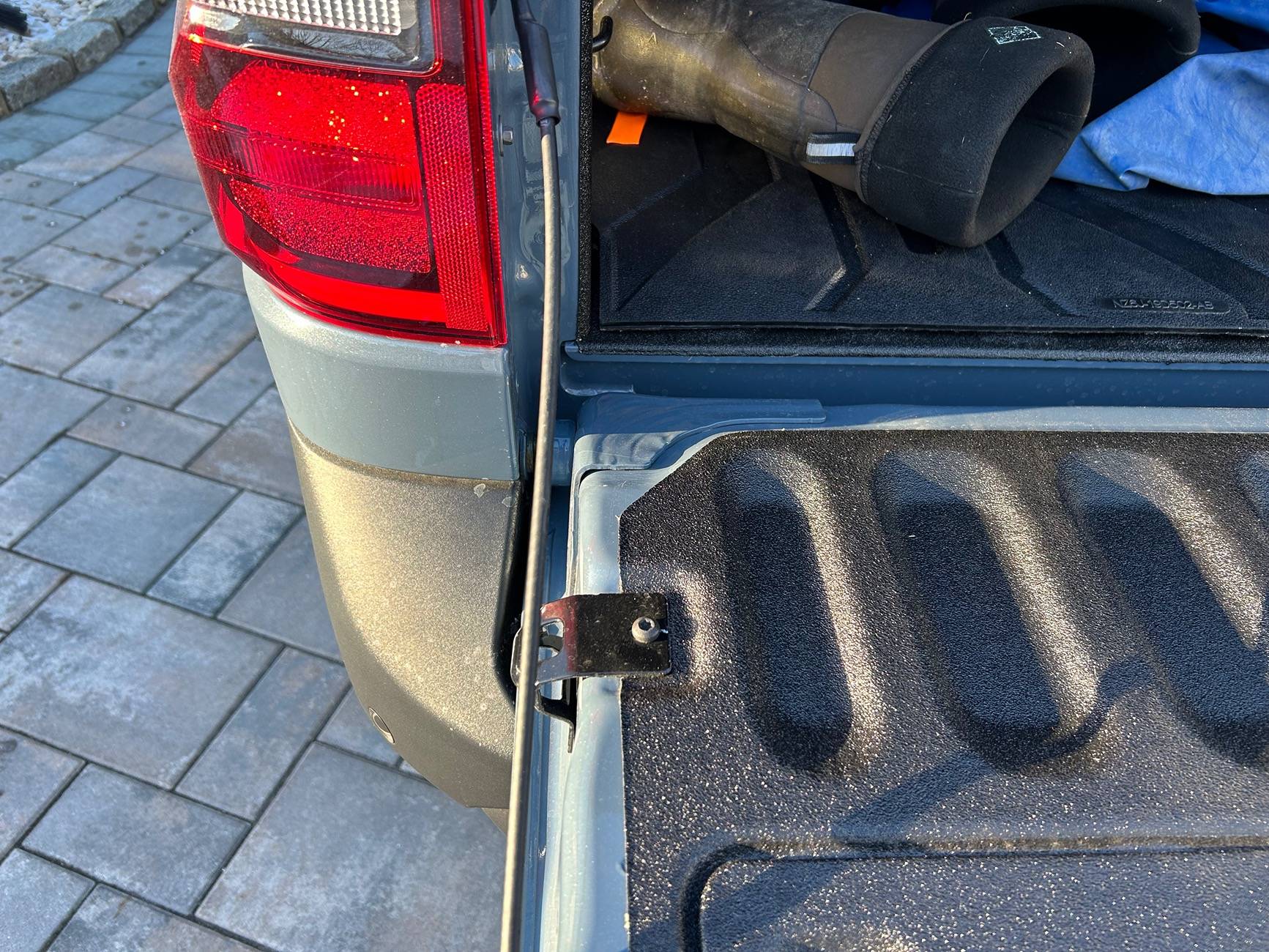

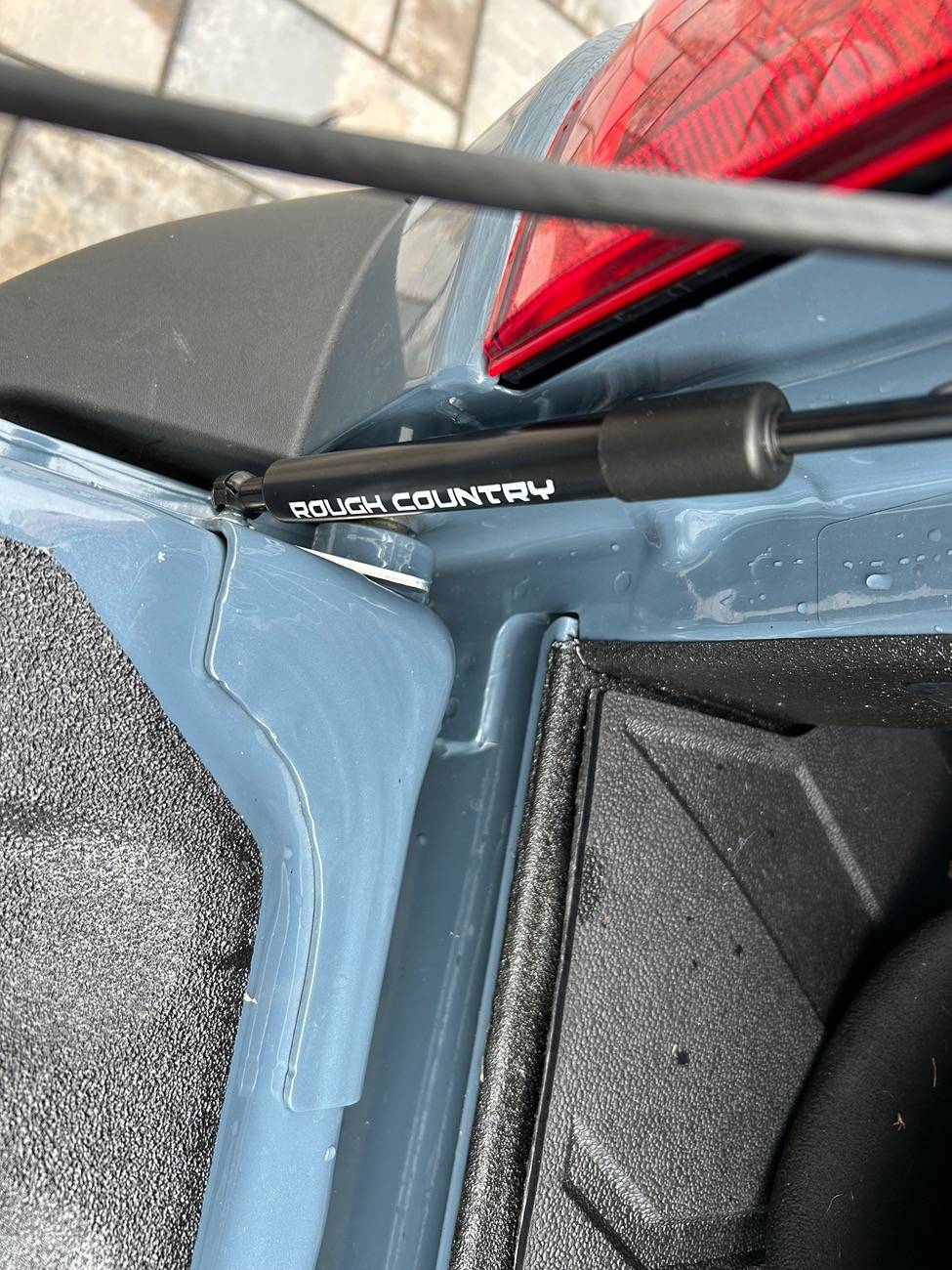

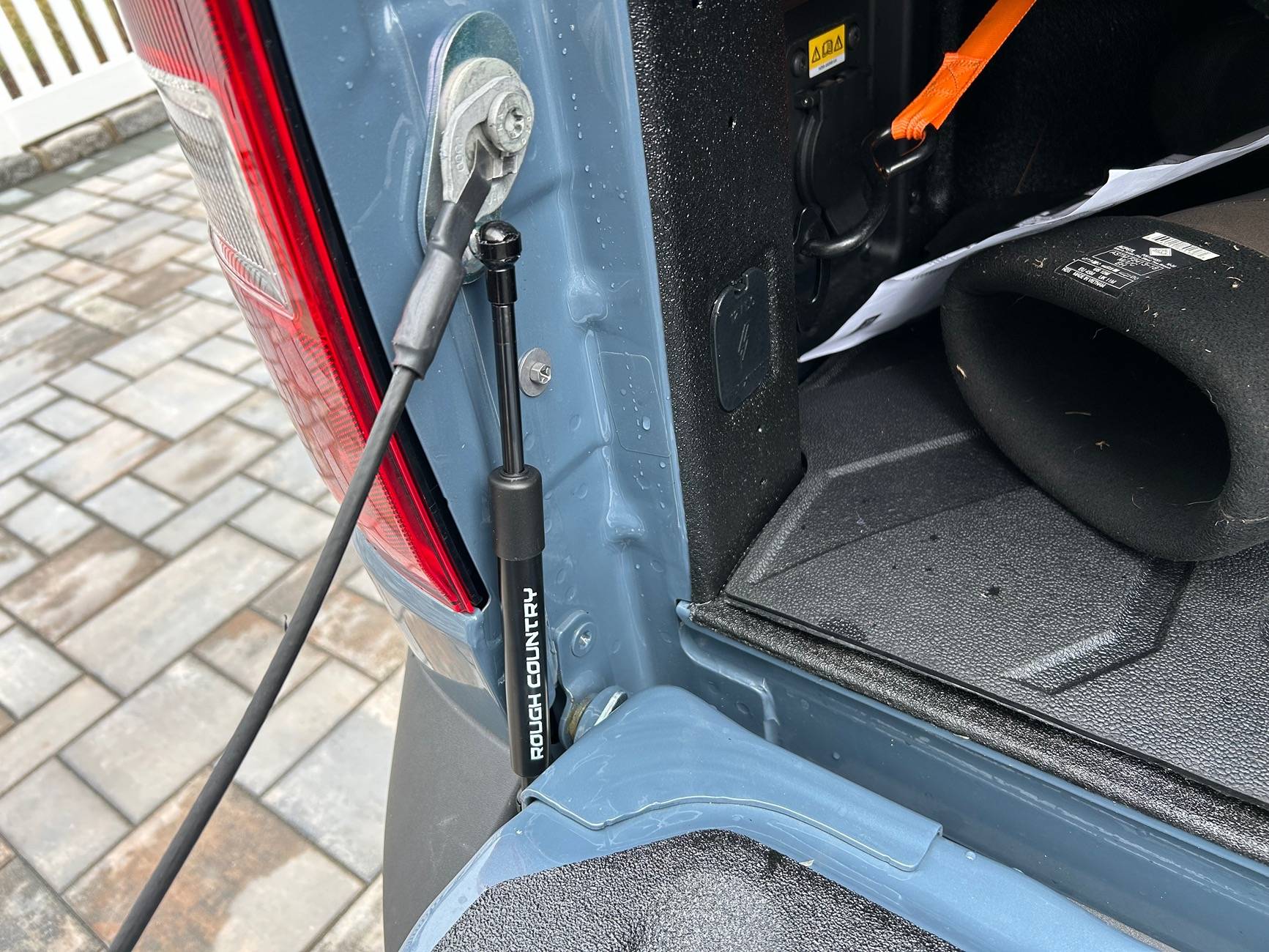

Can someone tell me if I have it upside down? Seems to function the same way whether I have the piston at the top or bottom.
When it’s at the top the tailgate strap gives me a hard time when closing the tailgate. This way it closes perfectly.
It works fine both ways.
Some will say the black piston part that retracts stays cleaner the other way around.
Truth be told probably 90% of the time it's going to be retracted inside the cylinder anyway.
If it works fine I don't see any reason to change it.
My personal opinion is. The less you muck around with pulling it off the mounting balls and snapping it back on the less chance of anything loosening up. Don't fix it if it isn't broken.
It will work both ways but most instructions I saw have the "barrel" part at the top. Your main problem is that the top plate that holds the assist should be straight up and down (aligned with the tailgate post). Loosen the cable Nader pin, straighten the plate, tighten it up pretty tight, and you should be good. Hope that helps.

Do you (or anyone else) see any reason for concern that the fold-down ring types only have a single screw to support the load vs. the two screws of all the OEM types and the "pointy" ones I found?
All the mounting holes for the in-bed side rails - I don't have rails so I installed single-screw d-ring type tie downs in those holes. It feels like they bend way too easily with a moderate pull on a ratchet strap. Not the d-ring part, but the bracket/strap part which wraps around the base of the ring which is always thinner steel than the ring itself. And with only one screw holding it down, ratcheting turns or spins them slightly. Just enough to scratch/wear the paint underneath and that bugs me. This was the reason I kept using both available screws when I built the gate tie-down, and used 1/8" steel that will not bend. Don't need any more stuff bugging me. I don't have to worry or care about it at all. It's not gonna move.

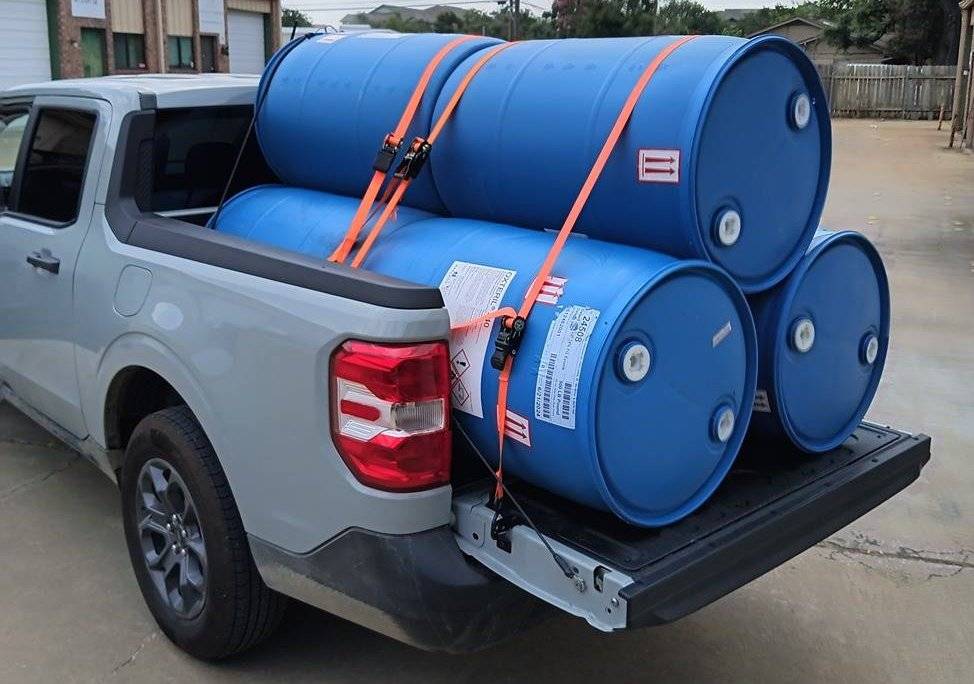

@MakinDoForNow posted this photo (in another thread), the BEST illustration I've seen of a situation where the tailgate tie down points did the job, but the in-bed ones probably wouldn't have been enough for this haul:
Ford Maverick Tailgate Assist Question MakinDoForNow gate hook usefulness
What's that saying - better to have it and not need it than need it and not have it.
MakinDoForNow
Sep 24, 2021
8,964
6,621
Yep. It was not the best. I could not get to the bed floor tie down points without unloading and drove 40 mph for 46 miles. Damn only one oem slider per side. Stopped twice to check for straps shifting. Tailgate tie down definitely saved the day. Four additional eyelets on each side are now available.
