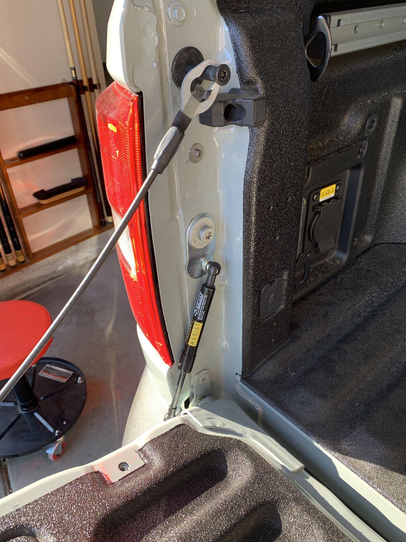

I'm still not seeing it. The second place where you put the cable it up higher than where it connected in this photo. How can it be blocked by this strut being on the lower tailgate connection. I want one but hesitating on ordering it because of negative comments. Can some take a photo to show how it won't work. I just can't see it. Please someone educate me and cure my ignorance.
Ah- I must have been looking at a picture of another truck. This appears to be a Maverick and fully serviceable

Ford Maverick Tailgate Assist Struts B233DA5A-EA36-4D61-94C6-EF1B5FE4E97C
just providing confirmation that the strut has no impact on the cable position.
you do lose the tie down on the tail gate but could mount a different style. I’d also just take the strut off and reinstall it if I really needed it for a project bc it’s a pretty quick job.

Do you have a picture of the side of the tailgate showing the Damper mount?

I like it and think it’s worth it. You will lose the left side bottle opener but there is a D-ring you can put in it’s place.

the instructions say you have to remove the bottle opener/ tie down on the driver side for it to fit
Only thing is the tie down / bottle opener hits the strut. I see no way for both to occupy the same space. Plus I will need that tie down for hauling plywood and Mustang parts.
You will have 2 threaded holes from the bottle opener removal . The one on top should allow some form of tie down to be installed with out interfering with the damper.
Weird we have to remove the tie down point though. Shucks.
