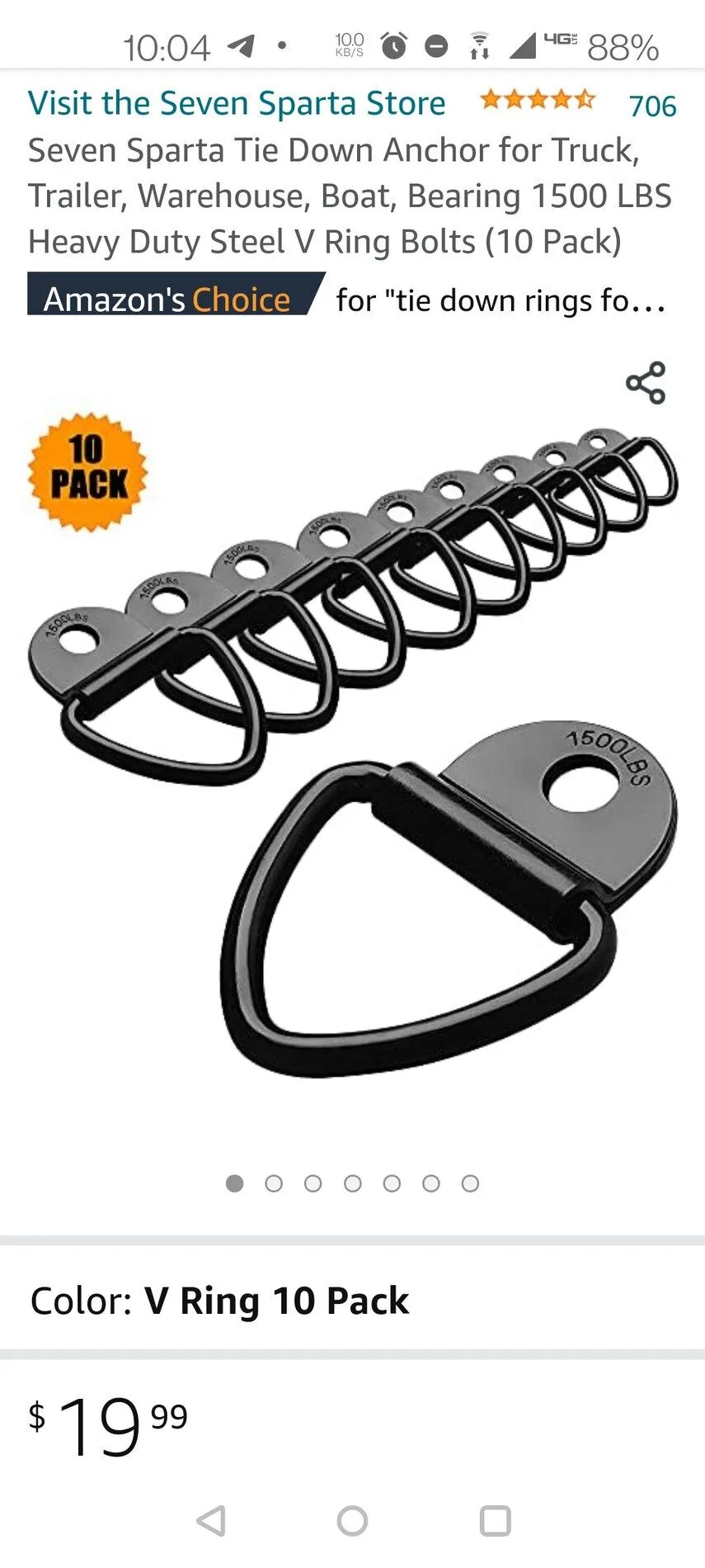

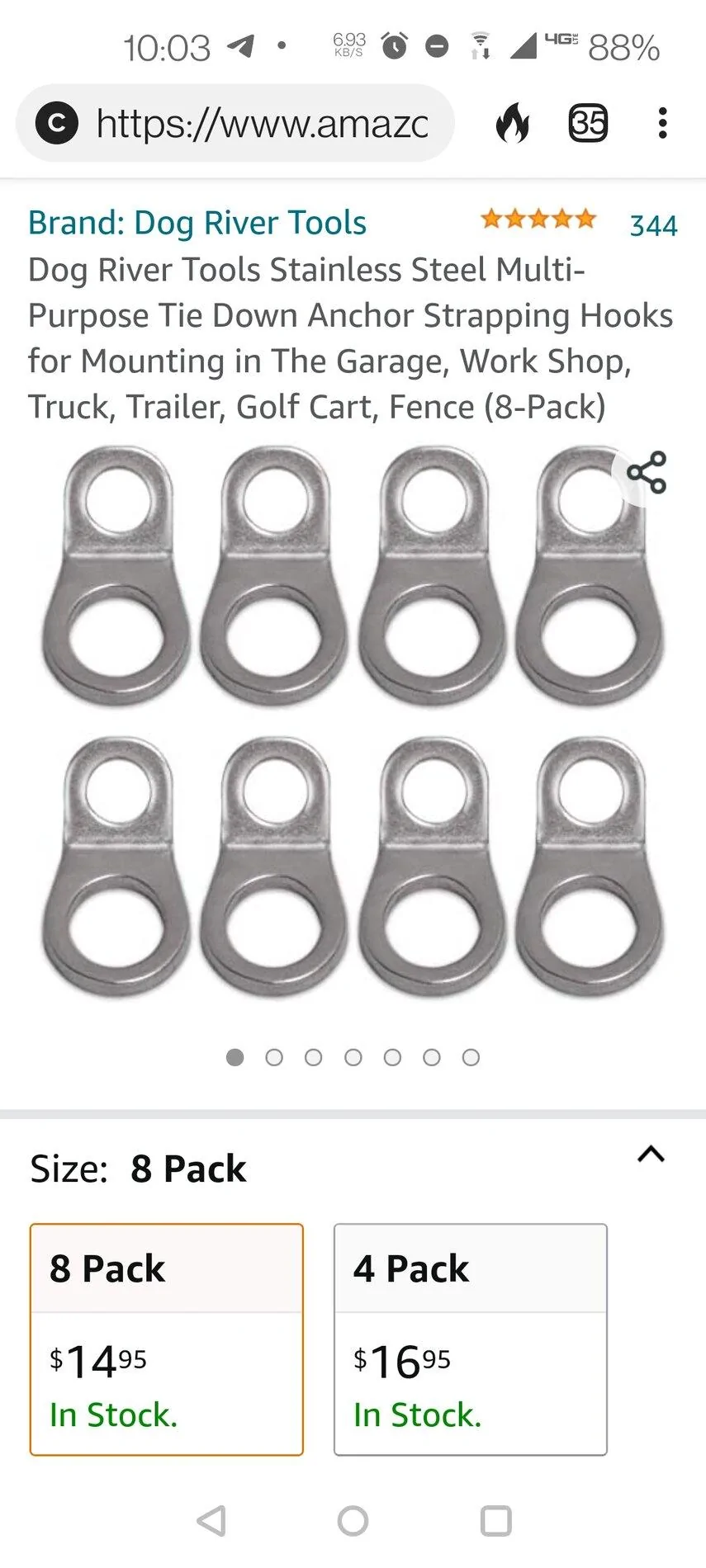

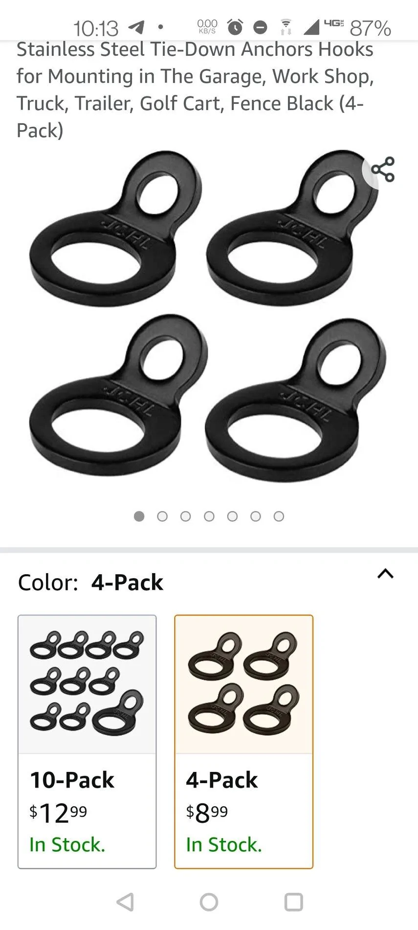

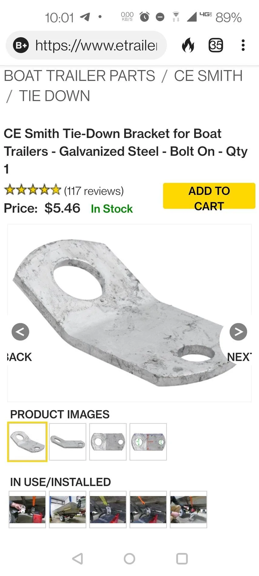

I would like to add this to my Maverick when I get it. I just don’ want to lose my tie down on that side of the tailgate. I could care less about the bottle opener part of it, just a tie down would be nice. If I can figure out a way to add a slimmer/smaller tie down, then I will add this for sure.
Something like these off amazon could work. One way or another you can find something to replace that tie down.
The folding variety that @huunvubu mentioned earlier are the only ones that might have a chance of working. If the are fixed like the first three you mentioned they will hit the strut.
Here's what he suggested.
I ordered them and I'll report back.
I was looking at the dimensions of those and they will only work if you pivot them inward. If they are pointing out they will also hit the strut. This is my main issue with this accessory, hope someone finds a permanent solution, then I’m doing it.
