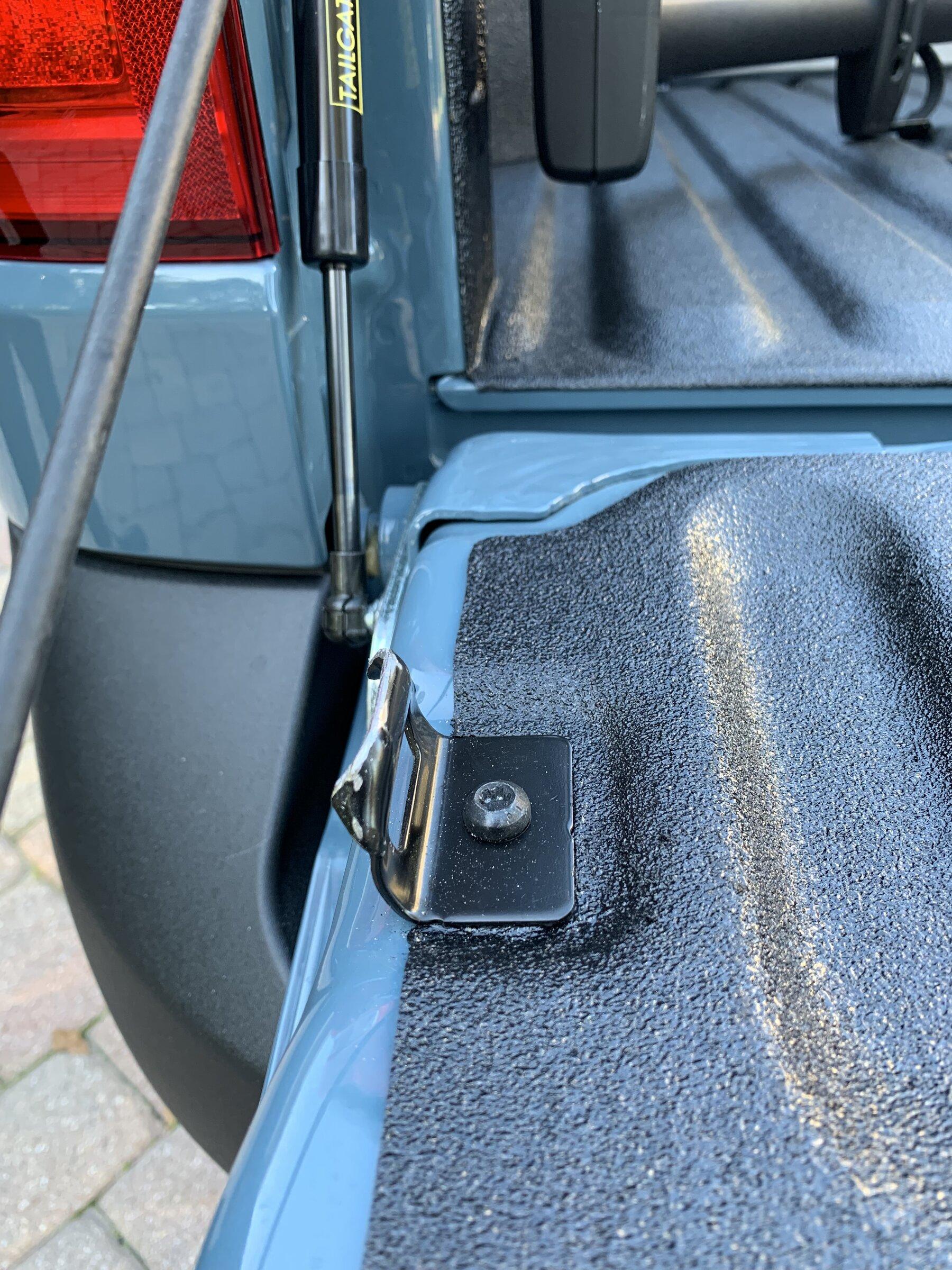

I installed mine like a week ago and kind of forgot about it…. Came out of the store today and open my tailgate and it catches and I’m like “WTF!! Oooohhh yeah, I installed the tailgate damper”Just installed mine 1 hour ago. The secret to a successful install is to read this thread. The bolt that attaches to the tailgate with blue lock tight is where most people are having problems.
I threaded the bolt with the nut away from the bracket. It was tough. All the blue lock tight came off. I then put the bolt thru the bracket. The nut threaded very easily. I put a few drop of lock tight on the bolt. Put the bolt in the tailgate hole. Pulled the bracket out while tightening, and in 2 minutes the bracket was tight. I read people are having major problems with this step.
Tailgate assist works great. Just watch and make sure the silver bolt that sticks out does not contact the shock. It is very close.
