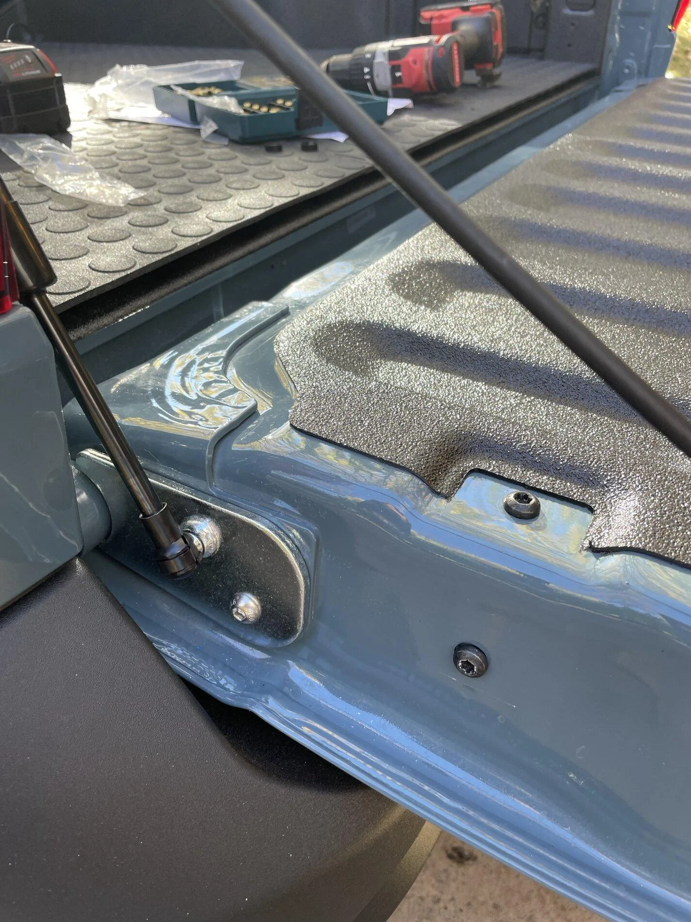

This is the official Ford Accessory Tailgate Assist - Hydraulic :

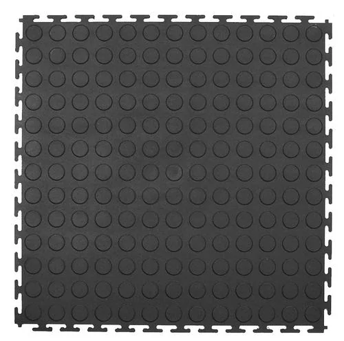

Update - the bed mat you see in the photos are actually two pieces of this exercise mat taped together with butyl tape.
https://www.menards.com/main/floori...6584011607.htm?tid=2735983253595367499&ipos=6

You can get the tailgate damper here for $40.25:
https://www.pfeifferwholesaleparts.com/oem-parts/ford-damper-assembly-vnz6z99406a10a
Tailgate Damper Installation Instructions attached.

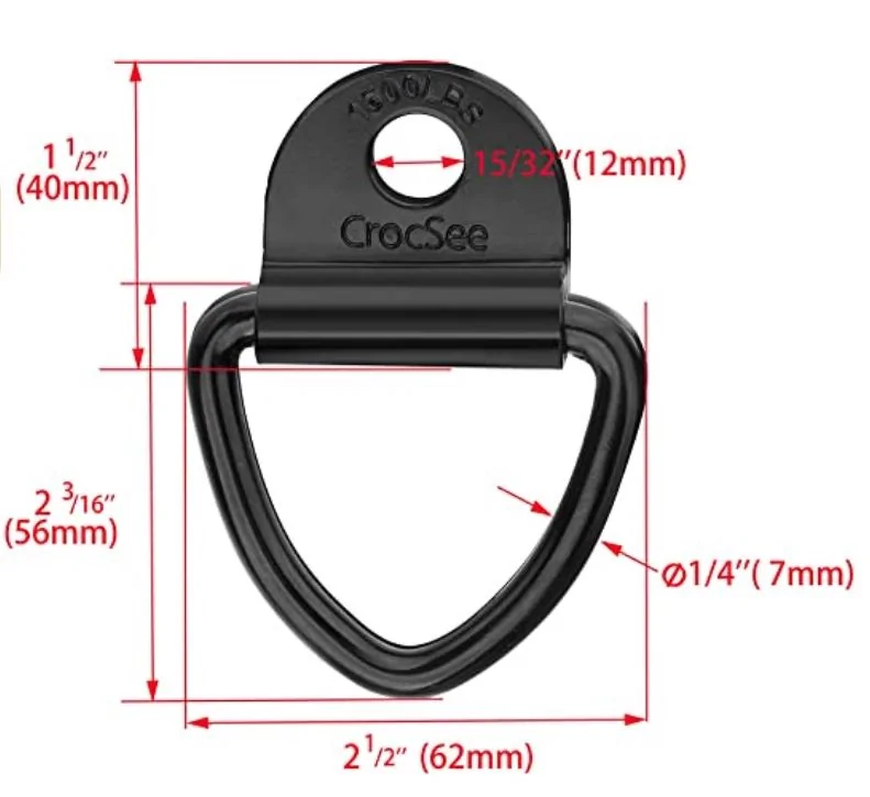

Note that Installation (step 8) requires the removal of the left tailgate tie-down. They call it the "bottle opener" but it is mainly a tie-down that includes the bottle opener feature.
I don't want to lose the tie-down so I am installing these:
CrocSee 4 Pack Truck Bed Tie Down Anchors Trailer Cargo Hooks Bolt on D Rings V Rings Heavy Duty
CrocSee Bed Tie Down Anchor
Ford Maverick Tailgate Assist hydraulic struts & custom bed mat on 2022 Maverick [video] CrocSee Bed Tie Sown Anchor

I would like to add this to my Maverick when I get it. I just don’ want to lose my tie down on that side of the tailgate. I could care less about the bottle opener part of it, just a tie down would be nice. If I can figure out a way to add a slimmer/smaller tie down, then I will add this for sure.
I don't want to lose the tie down so I am installing these:
See the above post for picture of Anchor and Installation Instructions.
That looks exactly like what I was thinking. Thanks for the link!

Update - the bed mat you see in the photo are actually two pieces of this exercise mat taped together with butyl tape.

Note that Installation (step 8) requires the removal of the left tailgate tie-down. They call it the "bottle opener" but is mainly a tie-down that includes the bottle opener feature.
Thats a great idea, post pics if it turns out well.

Only on one side. I was kind of curious how it would work if you put one on each side.
Not an option, the kit is driver side specific

Anyone can correct me if I'm wrong. I saw a post of a maverick using a f150 tailgate assist off Amazon. ($22 I believe if you want to get down to the brass tacks). Has a yellow warning rectangle on the side of the main body of compression tube... Sorry I don't have proper lingo. Look it up and see what y'all think, may be half price and fit just fine.... And 2 day shipping to those prime members.
The Ford Maverick assist is built by DeeZee, which sells directly on Amazon. The DeeZee labeling was in one of the pics by the author of this thread.
