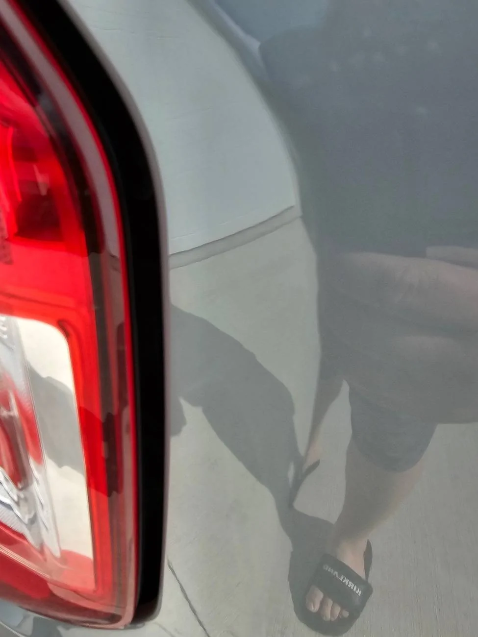

I'm having an issue on my passenger rear tail light. The front portion pops out and leaves this half inch gap. I can push it and pop it back in but it's a temporary solution and it'll eventually pop back out. When you take the tail light out, there are 2 posts that pop into a couple of grommets and then 2 bolts that bolt in, in the bed. I've tried tightening those bolts but that caused it to pop out even more from the additioinal tension of tightening the bolts.
Anyone else had this issue? Are the grommets worn out that those 2 posts sit in? Everything looks find when I look at them, but that's just as far as I can tell. I thought about taking off the other tail light to see how it is in there, but was was worried I may cause the same issue to start. I thought better of it. I wonder if you can buy replacement grommets if they are worn?

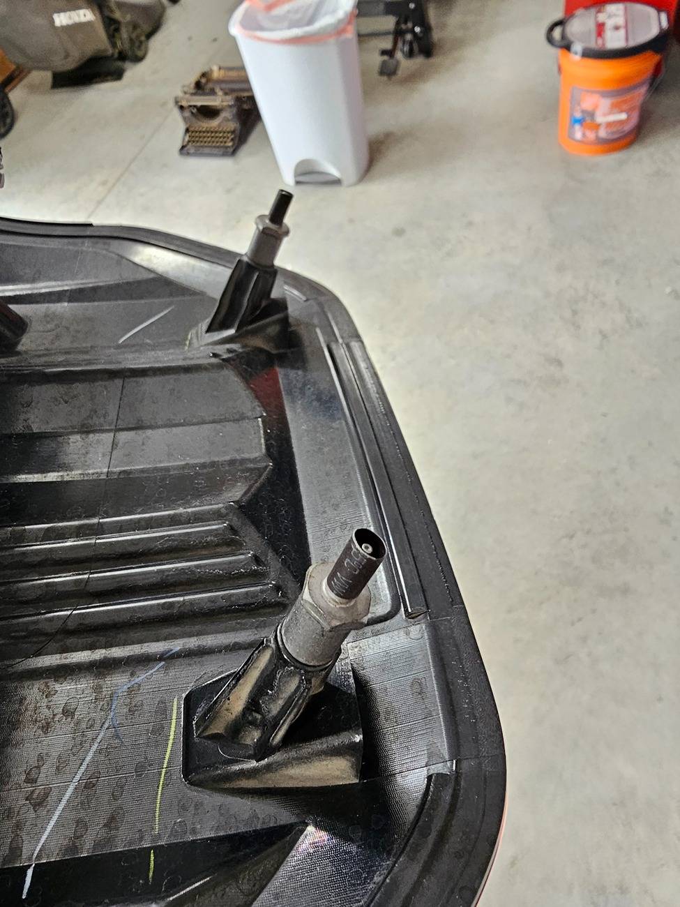

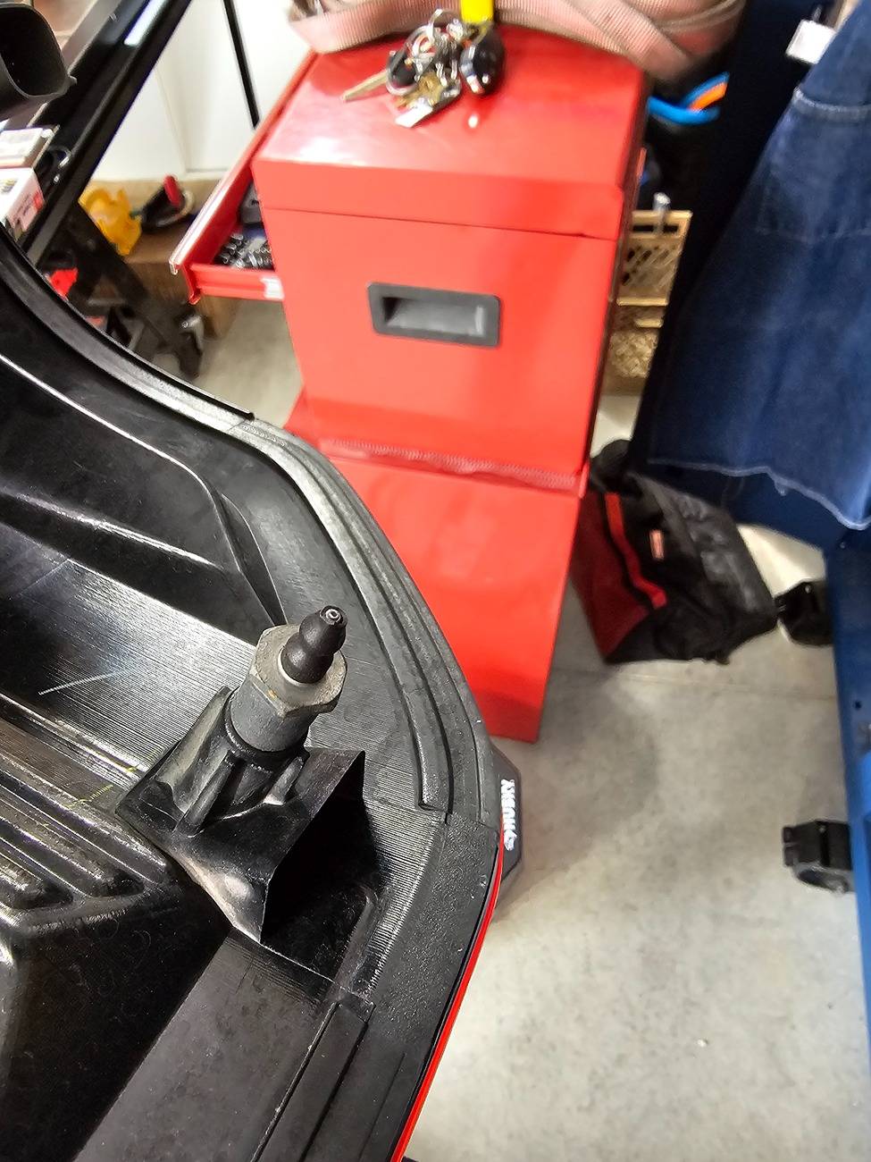

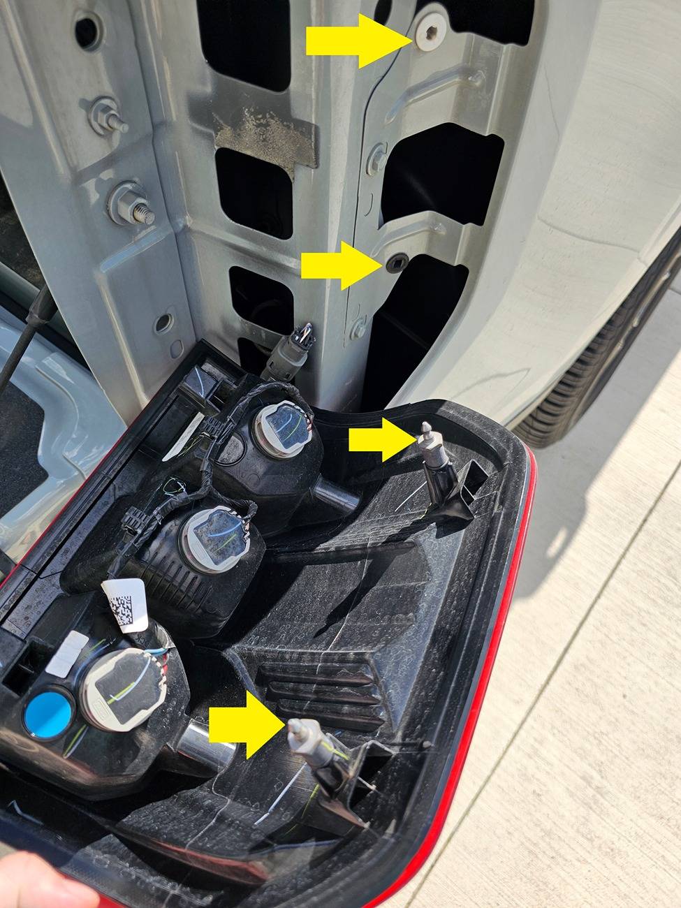

I removed my tail lights to connect some wires and when I put them back the passenger side took a little pressure to push into place where the screws could go in, not much but it seemed a bit springy where before it sat flush, where the screws didn't pull it in when tightened. I noticed that as I tightened the screws it was pulling out slightly at the front edge where the two pins snap in and I could see where over time it might pop them out.
In the daylight I removed it again and looked to see what was stopping it from sitting flush and found that there is a pin at the top of the light fixture that goes into a slotted hole in a flimsy tab on the fender and it was missing the hole and pushing against the tab. Once I bent the tab back to its original location the pin on the light slots into the hole and the housing sits flush against the metal the screws go through and there's no force trying to pop the front edge out.
You can check this pin/tab/hole alignment without removing the taillight by looking into the small gap between the top of the light and the fender, looking in from the side using a flashlight.
Here are pictures showing the tab and pin I'm referring to. The pictures I found show the right side fender and a left side tail light, but you can get the idea.

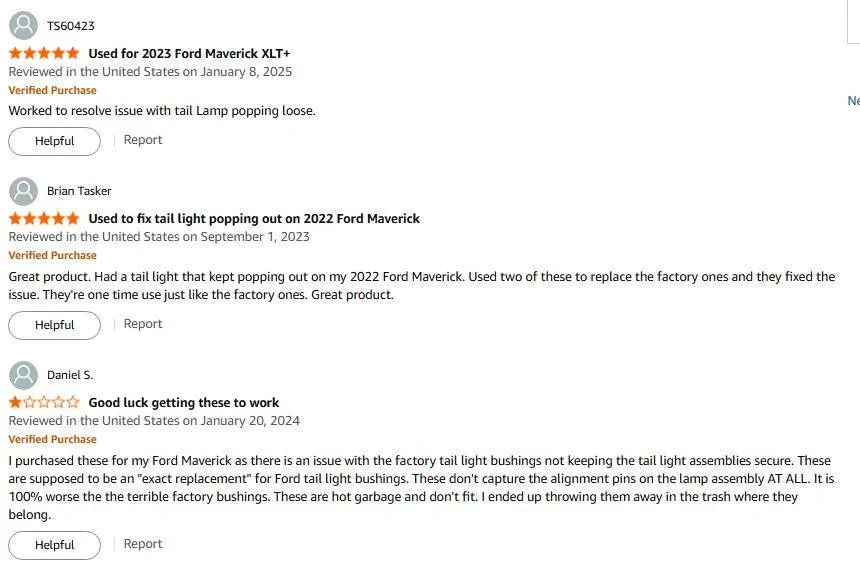

Below is the reviews on the white pegs.
2 good, 1 terrible lol.
I may roll the dice.
That bottom review is mine. Maybe I was a little harsh but I was angry that I destroyed the factory grommets by removing them and then the cheap Amazon replacements didn't capture the pins on the tail light assembly at all. It actually made it worse.
