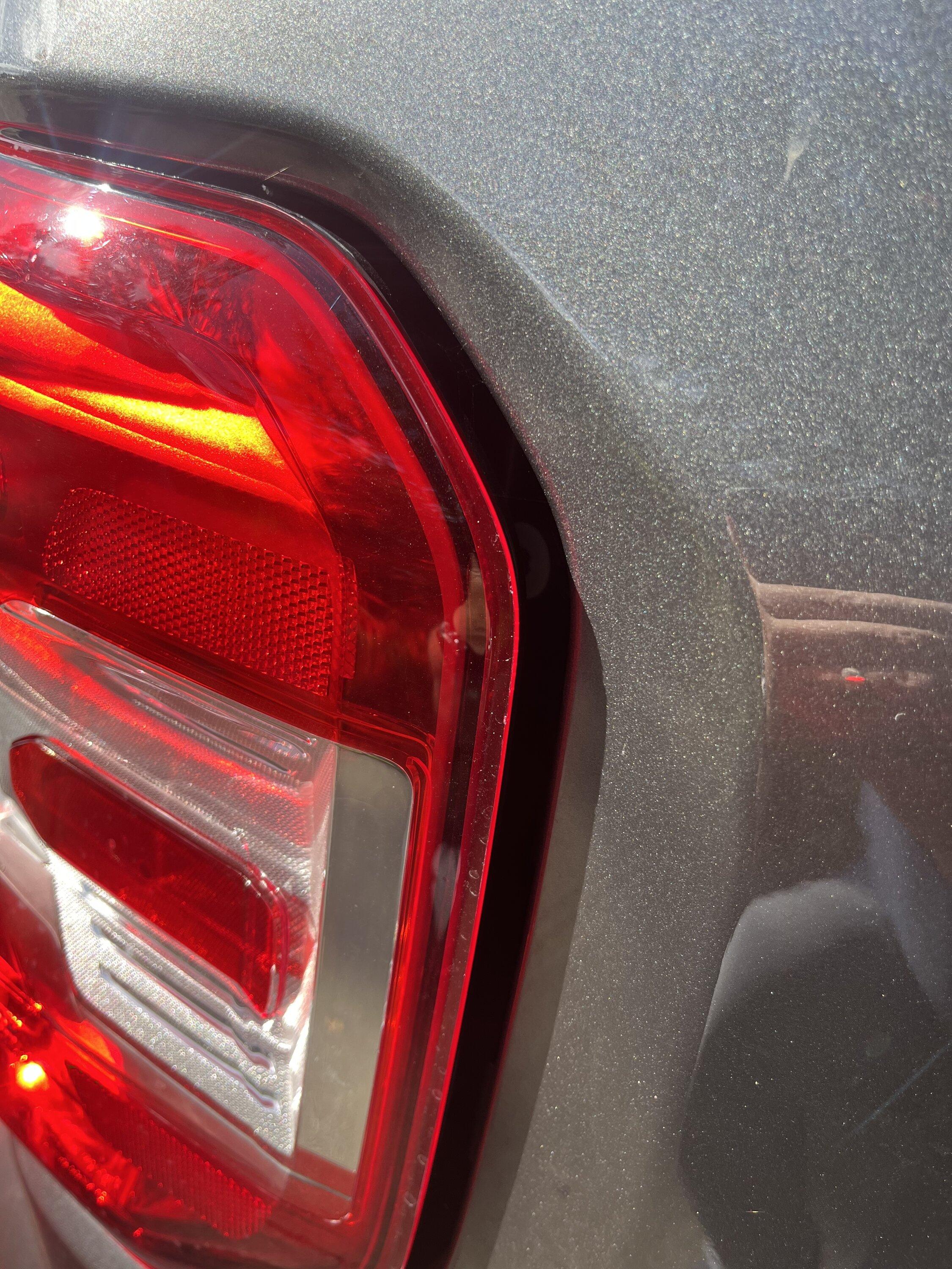

I took out my rear tail light. The next day my neighbor told me they were stealing rear tail lights. I went to look at my lights and the left rear was popped out.

Easy fix, at least for mine. All I did was removed the 2 bolts on the inside of the tailgate jamb, popped the front back in place and then kept constant pressure on the front of the light where it pops out of the rear fender/ quarter panel as I tightened the bolts back. If you give it all the beans, it'll cause it to pop out again so make sure not to overtorque. I'd say an easy way to get it snug while not over torquing is to use a socket on a screwdriver and only tighten as much as you can using only the index finger and thumb. This will naturally limit how much you can tighten and should be in the right ballpark to keep it from popping out again.
It is a poor design though, first generation models will always have these issues so it's part of the joy of owning. I'm still just grateful I was able to get one.

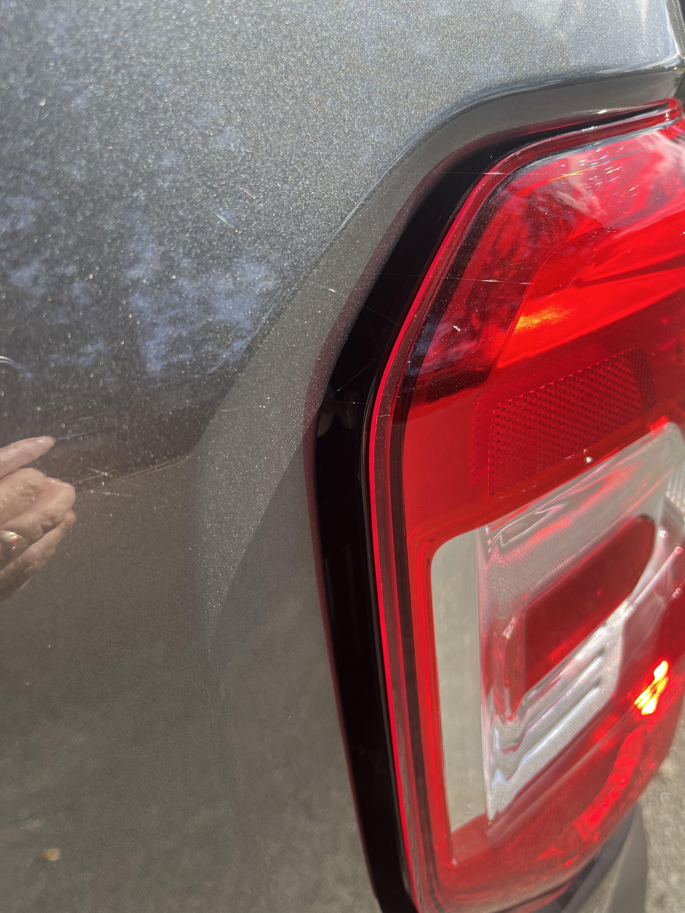

The left tail light on my Maverick has been popping out in the past few days. Every time I push it in, it just comes back out after a drive.
Has anyone encountered this problem as well? Maybe it's because of the hot weather?
Yes, we have had this problem from day 1. Our passenger taillight keeps popping out. It’s almost as if the mold wasn’t made exactly right. We’ve taken everything apart and put back in place and still pops out. If anyone has a solution I would love to know
Try tightening the two screws just slightly tighter than hand-tight, this worked for me.
