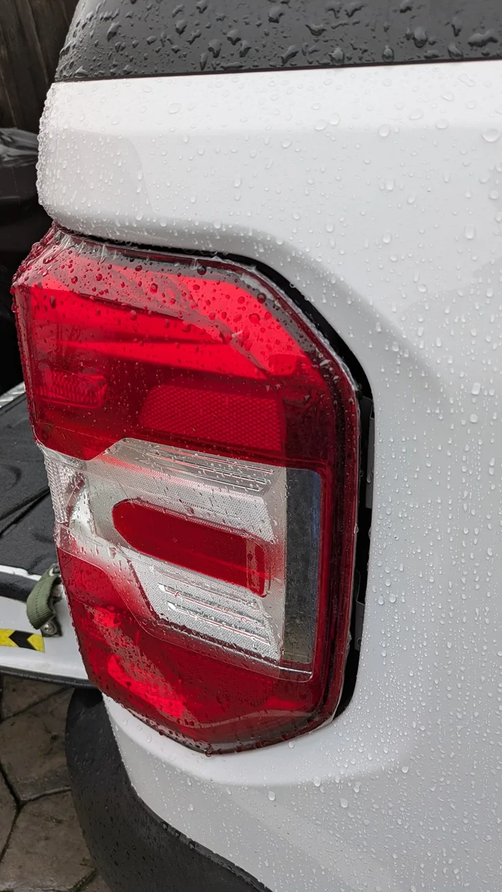

Yes, we have had this problem from day 1. Our passenger taillight keeps popping out. It’s almost as if the mold wasn’t made exactly right. We’ve taken everything apart and put back in place and still pops out. If anyone has a solution I would love to know

I went back to my dealer a few times where they kept loosening and retightening the screws that held the cover in. Eventually they agreed it was a problem and ordered larger grommets which seemed to have fixed the problem. It hasnt popped out in a month but its also been really cold here and I'm not sure if warm weather has an effect or not. But bigger grommets made the difference

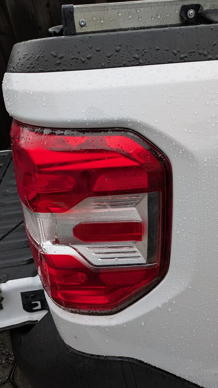

Mine have been popping out on both sides of the truck numerous times. I have never touched the taillights. My local Ford dealer said the grommets were messed up from the factory. They ordered me two new taillights. The first set came in last week but were damaged, so waiting on the new set then installed under warranty. My neighbors maverick is popping out also. I guess its happening alot.

Try tightening the two screws just slightly tighter than hand-tight, this worked for me.

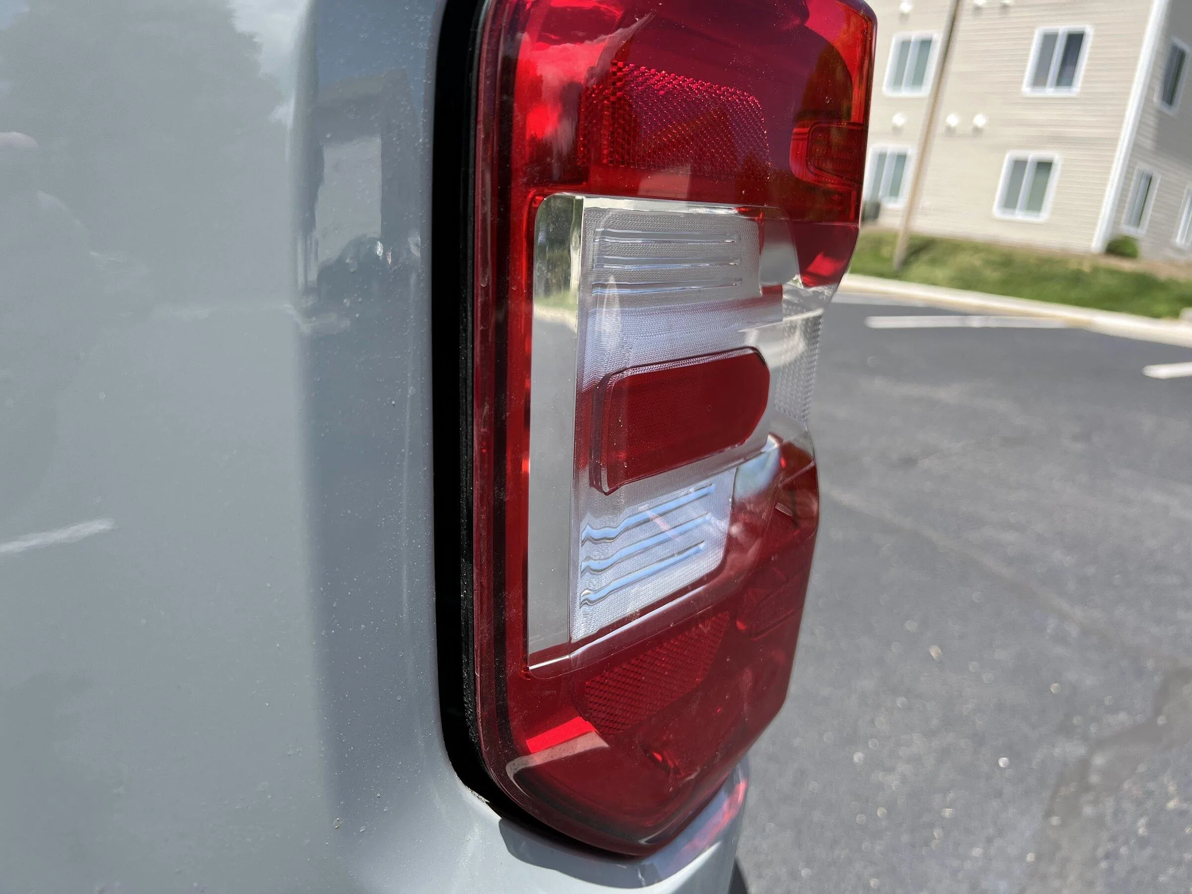

Just noticed my driver side popped out, i guess 2023 models still have the same problem.

I just took it off and put it back in, hopefully this would fix it.
I had to do that to one of mine. It was probably due to my poor reinstall after I took it off and hooked up diodes for the towing lights.
I took the screws out and pushed it back in, then reinstalled the screws, it has stayed in place.
