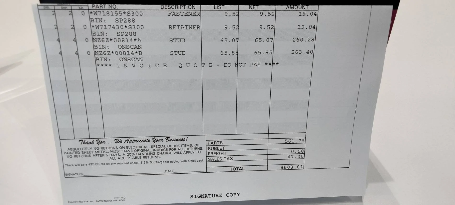

I don't know if the OEM price from Ford has gone down any.
Right after the technical service bulletin came out. I went to the local Ford dealer to see how much OEM parts would be.
This is what the parts department printed out. $608.00 😱
I think I would try to find anything after market.
Good Luck.
